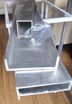

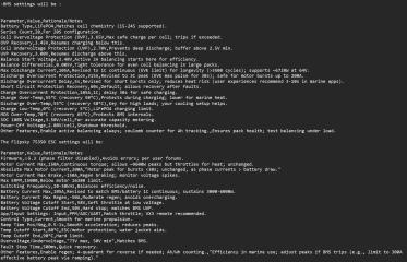

Photos shows the final BMS and ESC setting I will try first. Planning to mount motor on the front cross member of the catamaran and the battery will be on the extra trampoline in the front.

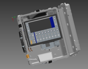

Photos attached of components , Current status of 3d drawing and BMS, ESC parameters currently selected.-> Build in progress, it will probably take me all winter before I start testing. (see 3d drawing current status).

3D IN PROGREES DRAWING (i'm figuring out how to push down sells onto cool plate and avois shorts. Once i get the first draft of the cover i'll show you.)
Screenshot 2025-11-02 124524.pngScreenshot 2025-11-02 125949.pngalu profiles.jpg

If you're concerned with legality, you'll need to verify with your local marine authority but 48v is a typical maximum allowed system voltage.
As far as wire gauge goes, thicker is better for minimizing resistance to current (decreasing voltage drops within cables at high currents), but you will also require properly crimped connections that are then correcty bolted to each destination point.
When making the battery casing design, be sure that it provides proper compression across the large faces of the cell stacks, to provide the correct pressure per square unit of surface area per the spec sheet of the cells. If tehre is insufficient compression, the cells will swell from outgassing during use and charging, and the gas will begin separating the layers inside, decreasing their efficiency and capability and capacity, and causing the remaining still-connected surfaces to be more highly loaded, increasing stress on the cells more and more as time goes on and damage increases.
(the only cells that don't require this are cylindrical, as they are the only ones with this compression built into the cell structure).
