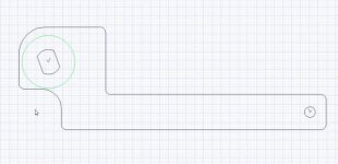

hi all
here is a drawing of the drive side torque arm the mouse cursor is where the rear deralliur is attached to the frame of the viper, the grid was 1mm
the axel hole is of course 14mm with 10mm flats, the hole at the far end of the arm is 6 mm
the green circle is 30mm dia from the centre of the axel
