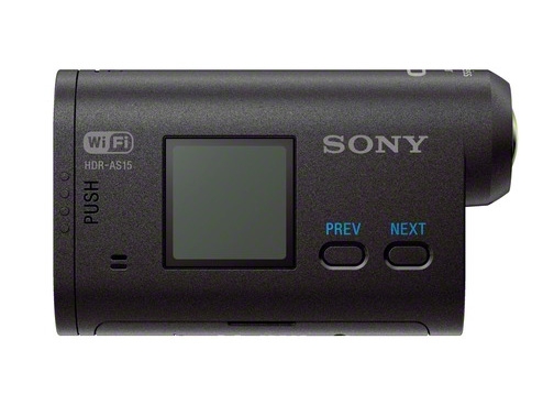

guys I am actually thinking that gopro (is great but) is not as good as the sony. Sony has video stabilzation and the clarity rocks. I don't want to steal the thread but we often talk about the best video set up with pend. From sound to position and usually the annoying shaking.
This video below was shot on Newb's sony and you have to admit the clarity, smoothness and sound have never been caught in ebiking that well.

this: HDR-AS15 w/ the newer AS30 housing
as said by others regarding the GP, youtube is not doing the quality of the image justice.
i have GP 3+ Blk (now for sale) and personally i believe the GP is a better camera in virtually every way,
exception being the "steady shot" feature which really makes a big difference. a while back i did some
side by side comparisons on a few road rides and the GP wins on color & image quality on smooth surfaces.
unfortunately, i never got around to taking the GP out for the same comparison in rough terrain but after
seeing the footage of this last ride i am convinced it doesn't compare to the sony in these conditions.

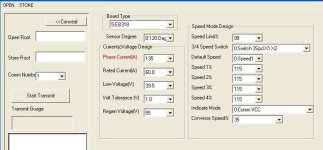

previous programing:
file.php
im inpregress of reprograming the controller to 115% speed because after recent reading I found that the "percentage" is a facade, and the real full speed as a normal unrestricted open gate FET is achieved by programing the controller with 115% speed.
i am under the impression (from ppl that have tested the controller output with a cro) that unless the highest percentage is used the pwm of the output will restrict the speed and or power in these controllers.
i have just done a freewheel spin up and am now seeing 76kph.
ill report further on real world speed. i was getting 60kph with a full charge (98v) and would be just under 60kph after some usage (92v)
Ken, I see you are running your Phase to DC amp ratio about 2.25 to 1. For the sake of performance gain, why not increase to 2.5 to 1? To much twisting force on the axle at start? I don't have any experience with programing so I am going off what I think my understanding of programing is. If I missed, it, please educate I got a huge 24 4110 Mosfet controller coming in with a 5404. Because I want to run 16s at say 125ah, to get some decent top speed, I will need to run speed% at 115 to 120.
Rick
Good question Rix.
The controller would handle it but the poor old ht3525 would get hotter even quicker. Its pulling fairly hard as it is so I'm happy.
If Iwas running a h40xx iI would turn it up. The 2.2 ratio is a bit more efficient to obviously.
FYI Kepler ran 57/160 amps on his bomber with the same controller into a slow x5 motor.
Yah, motor and the phase wires would tend to get warmer. I understand keeping around 2.2 to 1. And if your happy with the performance, no need to fuq with it.
For an HT3525, 66KPH is moving. Someday you will step up to a 4065 or 4080. BTW, I love my 4080 on the Fighter. Good for about 58KPH with the 18x1.4 MC rear wheel and tire, pulls hard too. Looking at your programing module, I noticed you got 115% set in speeds 1-4, I get that as this can be set up with different on the fly switch power modes, but explain to me about the Speed Limit%. Is that your default limit you want to base the 115% over for? And Converse Speed%, you have 35, whats that do? I asked because I ordered a program controller cable and with my Crystalyte 24 4110 Fet controller. As I said before, I want to run a lowish voltage set up, 16S at north of 100 DC amps, and to get some speed out of the 5404, I need to run it at 115-120% like you are doing. Might even contact Kepler and see if I could have him reprogram the controller since he has the set up for it, but figured I would try myself first. Also, when you changed your settings, did you have to change your Shunt value setting and doing any additional calibrating between the CA and controller?
Rick
You can do it if you PC reaches your ebike with the usb cord. I SRT all switch positions to the same because Ihhave no switch so it makes it easyer.
Converse speed is reverse. Some controllers have a plug for reverse switch.
In the program you can go very high with amps . its tempting when you see..
I guess if you increase a bit at a time and monitor heat everywhere it could be pushed up very high.
