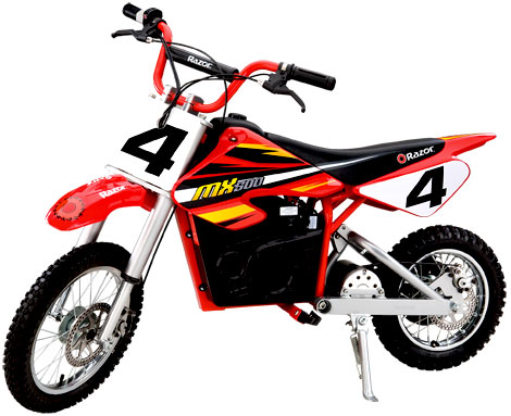

Okay, going to keep this short and simple as I just need a place to document all I'm doing.
Razor mx500 electric dirt bike
x5404 scooter style motor
18fet 4110 infineon 60a controller
20s2p lipo
original bike got it used without batteries for $80 with new front tire included:
x5404 scooter motor (perhaps actually an x53xx.. because its weight is around the 30lb mark with wiring, can't confirm)
Bike dismantled with scooter x5404 test fitted on dropout
Needed to move the dropouts closer so chopped it up and used some square steel tubing I had.
How it sits now.. about 1/2" extended swingarm, negligible:
Next steps to wait for 4110 controller which will go under the seat.. build the battery pack, and ride!

The motor was bought off ebay for a whopping $125 shipped. (Got a second one for $95 shipped lol) It had a weird axle that was for bolt on type dropouts. I took the original 10" tire from the mx500 and put it on the x5404.. it was a 10" hub, and the motor and rim are one piece. It had this special side cover instead of the usual side covers that have spoke holes for bike rims. The tires and tubes on it are originals.
This mx500 build came about only because I still haven't found a suitable 50/70/90/110/150cc scooter to convert. I want something that is street legal, and the other x5404 will go into a street legal scooter.

So it's all done.. this thing needs more speed and less torque. At 100% speed its 23mph.. using 20s lipo. Torque is easily enough to throw you off though..
thinking about swapping the 4115 controller over and running 24s but that would still leave me at maybe 27mph top speed. 120% setting should get me into the 30's though. I can sacrifice a bit of torque for higher speed.. now to see if I can get regen working at 24s..

I'll be happy running this little dirt bike on 20s.. I got the regen to work.. slip charge is too strong because it breaks the rear wheel loose even on clean surfaces so I'll have to turn it off. On EBS level 0, its already a really strong brake.. after I reflash to turn off slip charge I'll have to see if regular EBS will also lock up the rear wheel. I guess that's the price paid for a small wheel.. even 800w of regen is a lot. I was hoping to be able to tie the ebrakes to the regen but with such strong regen I think I'll have to utilize only front brakes and use the green button as regen for downhills and emergency braking.
