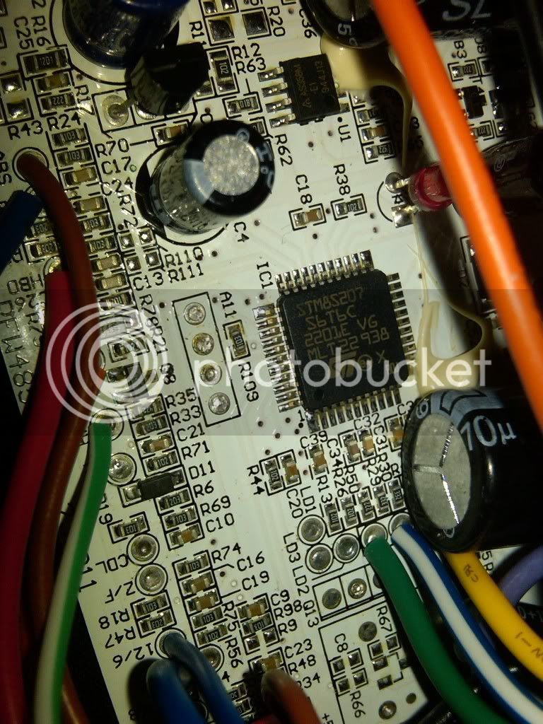

Alright, Finally some of my parts!

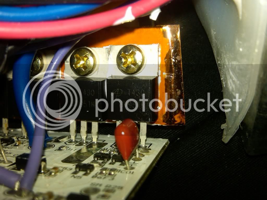

My controller came in, it was a $25 chinese special, rated for 600 watts and 48v.. Turns out to be a 12 FET board with 63v input caps, 12 t430 bv951k MOSFETS. Seems like the board has potential :)
The model number of the board is Refly RFW4850-v09 230911
This board has the option of being configured to run 60v but what is the difference between the 48v and 60v models?
Seems like you would need a resistor somewhere to bring down the higher voltage to a usuable level for all the smaller chips.. Is there any tutorial or thread on this - using this board?

Don't know why none of the EE headies haven't gotten back to you, that controller does have potential for $25, can you point me to the vendor? Although, especially on your first build, I would have gone with Lyen's on the controller for the tech support and wide array of threads modding his controllers etc... My controllers are rated based on the caps inside, since you have 63 volt caps that means 60 volts is the highest at fully charged on the batteries you should ever go. You can run any voltage lower as long as your controller doesn't have a preprogrammed LVC ( low voltage cutoff). Did your controller come in a case? Def need that to protect it from the elements as well as aid in heat dissipation. By the way, your webcam snaps a fine picture. :D

I pulled apart an old subwoofer amplifier and found these mosfets.
Cant find any info on these larger fets:
Then there are these little guys in the standard t0-220 package
P55NE06's
60v 55amp.

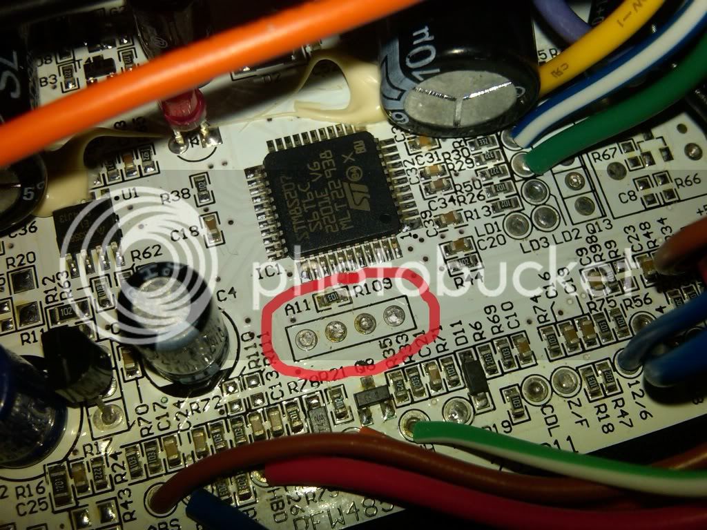

I still have yet to discover how to change the low voltage cutoff on the esc to work with my 12s lipo configuration (36v) from the stock 42v.

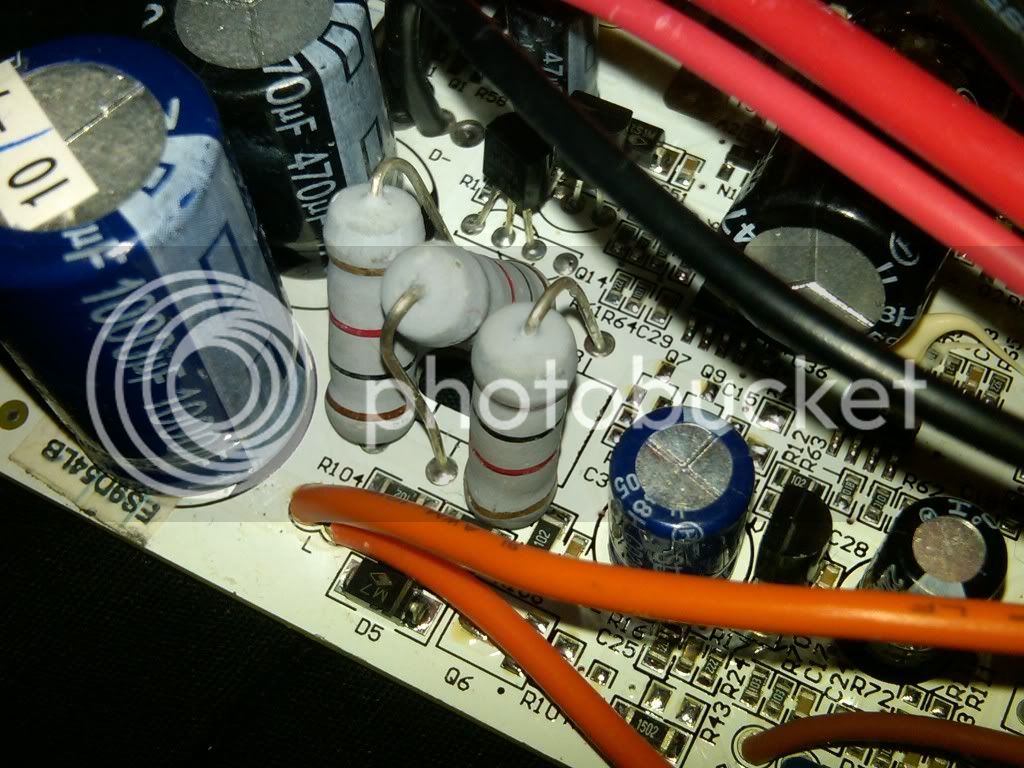

I also Need to find the resistor that steps the voltage down to run the processor and other voltage sensitive components.
Does anyone know anything about programming these refly boards, or is it a lost cause?
here is a picture of what may be the programming port?

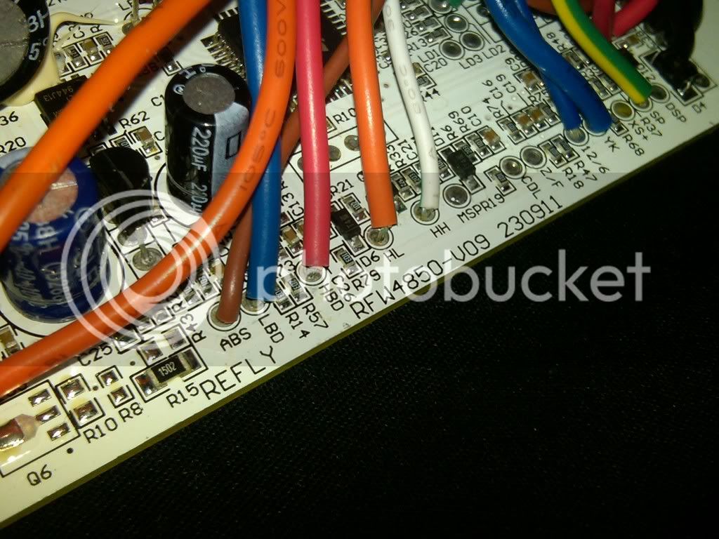

I am Also am trying to decipher all of the markings and wire colors
So far I have
Yellow, green, blue are phase wires
Large red and black wires are main power wires
Small red,yellow, green,blue and black are hall effect sensors
Along the right side of the controller.
Green w/Yellow stripe marked "SP"= Unknown
2 Blue wires with an external connection marked "YK 12/6"= Hall Sensor spacing(120* or 60*)
White w/ green stripe marked "HH"= Unknown
Orange w/green striped marked "HL"= Unknown
Red marked with "HBD"=Unknown
Blue marked with "LBD"=Unknown
Brown marked "ABS"= Antilock Brakes
2 Orange wires marked with "L"= Unknown
at the front of the controller (away from power capacitors)-
2 purple wires on the same pad marked "US"=Unknown
There are many more unmarked wires going to various connectors.

Hello Brushlessboy
i've a similar controller tehn your, can you give me a info?
What are a HBD and LBD cable? (LBD is Blu and Hbd is reo or pink/red, they go out ....what function they do?
You know how high voltage brake be used?
