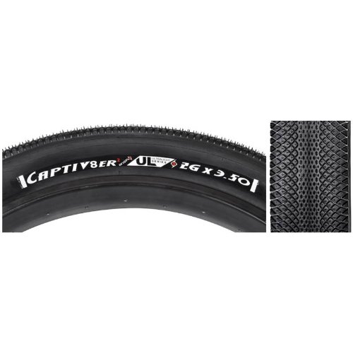

Have you had a chance to accumulate any miles on the Vee Rubber replacement tire? If so, how is it working for you?
I've been using a pair of Origin8 Captiv-8er 26x3.5" tires on my fattest bike-- those are the fattest I can fit in there. The same tread pattern and size is also marketed as the Sun Crusher and Vee Rubber Speedster, with varying casing construction and prices.
I like them pretty well. The highest inflation pressure I can use before the rear tire begins to rub on the frame is about 17psi. At pressures much below that, the front tire wants to roll affirmatively into a turn but takes some effort to straighten back out.
Soon I'll dimple the chainstays to buy more tire clearance, and then I can reevaluate the tires at higher pressures. At super low pressure they seem like great off-road tires, but they're a little slow and awkward-handling for street use. Hopefully that changes for the better without having to use so much pressure that ride quality becomes harsh.
