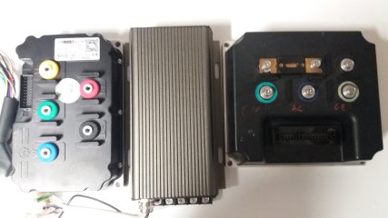

I'm probably going to order a fardriver for a Surron very soon. The listings shown for each model don't add up though....

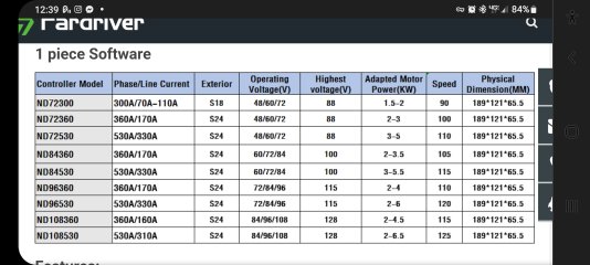

I'd assume a 72v-150a rated controller could put out 10kw. Per the fardriver web page the ND72360 should be capable of what I need. Assuming 360 phase amps and 170 battery amps I should be able to push 12kw. That said, the listing for that particular controller states it pairs with a 2000-3000w motor.
I'm hoping to get a controller that'll be capable of 8-10kw continuous.
Does anyone know how to find the "continous" ratings for these controllers?
Also, has anyone successfully (or unsuccessfully) paired a Fardriver with a surron motor?
