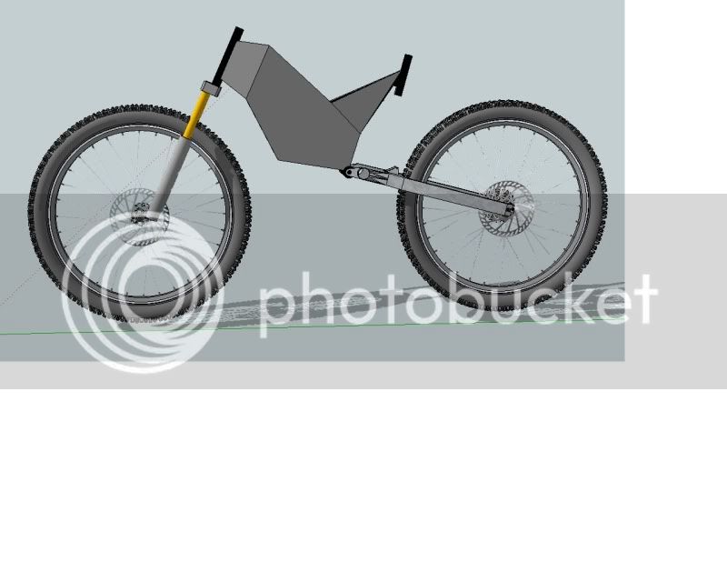

OK, I got my kit ordered and I am now ready to decide on the batteries, I am not 100% yet, because for now I need to run 48 volts and the controller is setup with the low cutoff for 48 volts. What would be the best way to achieve the correct array of batteries to make sure the low volt cutoff works properly? Will the cycle analyst work with any controller to cut the power if you go below the low volts? I know it does this but I want to be sure it will work with this cheapo controller for now until I get some more money together for the good 72 volt controller...
I found some good deals on batteries on fleabay for (8) 18.5 volt 4AH LIPOs for $349.00 shipped! but I am not sure this will work because it will not add up to the 48 volts I need.
SOOOO, what I am considering doing, is getting the Dewalt packs I found ($300 for 6 packs brand new) and trying to cut them up and build (3) 24 volt packs and then wire two packs in series to get 48 volts and then add the third when I am ready to go to 72 volts...Does this make sense? This is the last piece of the puzzle I have yet to figure out for sure, I REALLY like the idea of doing the Dewalts, because I know it will fit my bike and make GREAT power, I am just not sure how to balance/charge them... Can I get some help on this from someone who actually has used them??

Ah, I see OK well I am not flush with cash and i want the best possible, most powerful setup for my bike, and of course at the best possible price. I am not afraid of this I just don't want to waste money burning things up. do you have any links to step by step build ups of these A123 style packs? Also, if I wanted to control this whole pack of say, 72ish volts 10-15AH How would I setup a BMS to run it so it was a simple plug and play re-charge/balance system? Any links to a BMS that is capable of this? I really like the A123 style because they are relatively small and package easily into odd shapes like this chassis I am building...

It looks like you're going down the road of the Stealth Bomber, which is a very nice looking bike. Anything is possible, but get ready to learn a bunch before building. Pretty much any ebike costs around $1000 until you know some ways to cut some deals. That's for a hub motor kit. Making a radical design will cost more.
