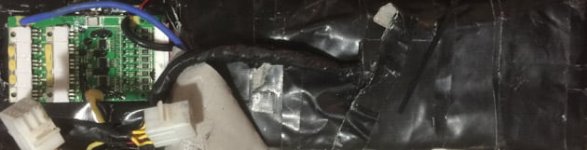

Okay Dnum, about to unwrap this mummy after donning the requisite ppe! Will post pictures soon. Thanks
Okay, the pictures are helpful for identifying the BMS.
You're right about the existence of a metal cover, but anything other than a "nose test" is beyond my pay grade. No burnt areas or damaged wires were evident where it attaches to the pack. Still looks new and still has that new car smell. Should I remove the BMS from the pack and take it apart? Thanks

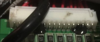

Is this where I need to check the cell voltages:
Due to the spacing between wire terminals, my DMM probes appear to be too big to safely measure the cell voltages on the board. However, I think it's a necessary step because previous readings are all taken from the sense wires I used when this was a split pack. As stated in an earlier post, I elected not to remove them when the two 26.4v were permanently connected in series. The voltages I measure for each cell through the old pair of split pack sense wires (8s each) may not be the same as what the BMS detects through its sense wires for a 16s pack if the connections are faulty.
Sounds like I may have to unwrap gorilla tape from this "entire mummy" of a battery pack, Ugh!

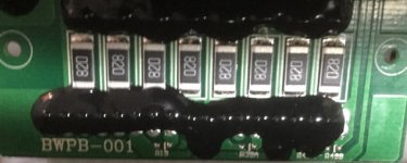

no, do not measure anywhere but right on the pcb. turn it over and measure where the solder bump is at the base of the pins.
he is correct though in observing that open circuit between packs in series will destroy the BMS on the channel at the top of the lower pack.
I cannot access the pins due to the hard black stuff. Apparently, this pcb was manufactured to protect me from my own ignorance.
I used a couple of safety pins to take measurements of the cell voltages as seen by the BMS.

Do I need to unwrap the duct tape and recheck the sense wire for cell #8 (right at the point the packs were joined back in 2013)?
Dnum, I believe the problem is solved, but I need your confirmation. I found a detached sense wire between cells #8 and #9.
After reattaching the sense wire, the QC1 charging mosfet (gate-souce) voltage was measured at 0.1v. Next, I placing a dummy load on the battery pack, using a 250 watt heat lamp bulb for approximately 5 minutes.
