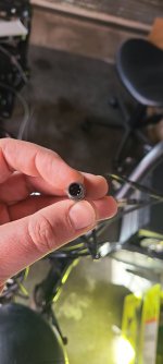

Just got a Juiced Scorpion with missing throttle and ripped off PAS connector. Need to identify replacement or I could just match wires from another set and make my own connectors if replacement is cost prohibited? I don't want to order from Juiced website.
Throttle connector from controller: 20230414_161310.jpg

Those are "Julet" connectors, in your case a 3 pin Julet male/female connectors. You can order Julet PAS and Julet Throttles from AliExpress like those examples however the pinout might be different as there's no standard. You might need to cut them and swap wires around to get the correct pin outs or you might get lucky and they will have correct pin outs. You can probe the connectors with a multimeter to figure out the pin outs.
You could also just cut off those julet connectors and order generic PAS and Throttles and make your own connectors however those julet connectors are waterproof and are probably used there because they are exposed to elements so if you do replace those, the replacement connectors need to be waterproof aswell or you will have issues in the future.

Thanks, I have a spare full throttle, but prefer a thumb throttle, so I may order one of those. However, for pas I'd rather make my connectors and cover up with electric tape.
