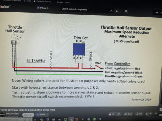

Hello, So in the first image i have a diagram of a ebike 3 wire variable throttle with a potentiometer wired on so you can limit the voltage that the throttle sends to the controller so it makes the motor slower. in the second image another person i found on youtube has wired a 3 prong switch so you can turn the circuit from limited throttle speed to unlimited (unmodifed) throttle speed. Now i bought this wireless circuit/remote setup online witch was about 3.5v in and out for the receiver circuit (third image. Now i want to wire in the wireless reciever instead of the manual switch, but i have no clue. if you could please draw a simple diagram on how this would work that would be very helpful. (the black and red wires on the receiver on the last pic is power in and the blue and white are power out)

You are trying to replicate a SPDT (single pole double throw) switch with what is effectively a SPST (single pole single throw) switch. You might need 2 receivers, or relay, or a different module all together..

to use your ebay module, provide the required 3.5v over the black(-) and red(+) wires. then use a multimeter to test the condition of the blue-and white wires.. im guessing pressing the button, or the remote button will connect/break blue to white which you could confirm/test with a multimeter in diode mode.
If confirmed to be the case, treat the blue and white wires as switch terminals ;)

i found this tutorial on tiktok where the guy had a 2 prong switch (underneath the potentiometer) wired up with his throttle on potentiometer, could i swap out the switch with the blue and white wires on my reciever? (btw i have fardriver, but i cant use the 3 speed because i have a surron sport/eco switch already wired on it)
Yes, once you have confirmed with the above outlined test that is how the module operates.

Makes no difference where you tap 5V off, it's all on a common rail.

It's safe to assume red and black supply power to the module, but best to test. Have you got a spare usb cable you can hack up? If so, strip it, find the positive and neutral (not necessarily red and black), label them as such, amd connect to the module's black and red wires. Perhaps a led lights up, perhaps it beeps, perhaps neither, but either way what you'll be looking for and need to verify is continuity between the blue and white wires when you push the remote control button. Does that make sense? Note that it'll be a latching relay.
