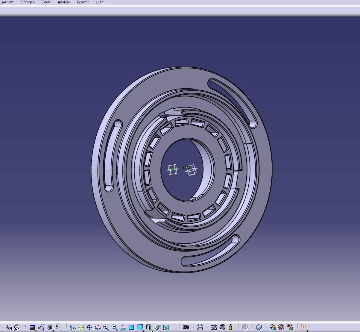

The plan for the halls is to install them outside by use of 3D printed parts. Going this route makes more sense, because:
- the winding is terminated in delta which means the sensors would belong somewhere into the theeth and not between (from what i know a 30° shift electrically would be needed compared to a star termination)
- having the sensors outside on an adjustable disc menas i can play with the timing to get lowest no-load losses
- strong magnetic fields from the coils caused by large currents will have no influence to the signal quality
As sensors i will use SS413A, and the magnets which will be glued into the rotor are 4x3x1mm N50M.
this is the CAD design:

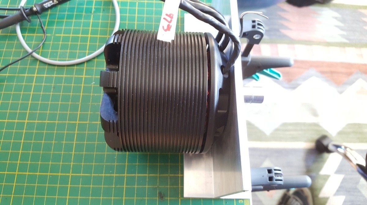

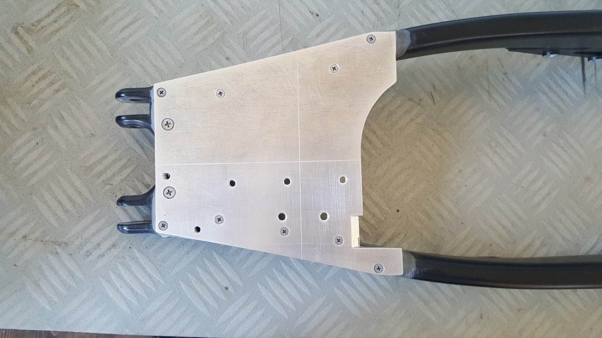

i printed the rotor yesterday with the 3D printer from my brohter. thats how it looks on the axle:

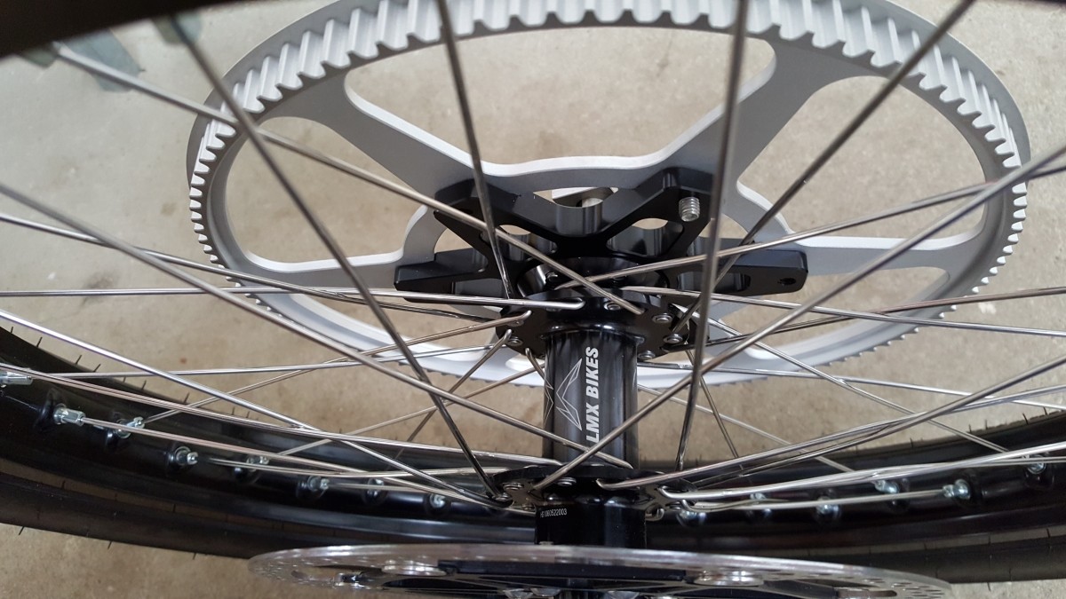

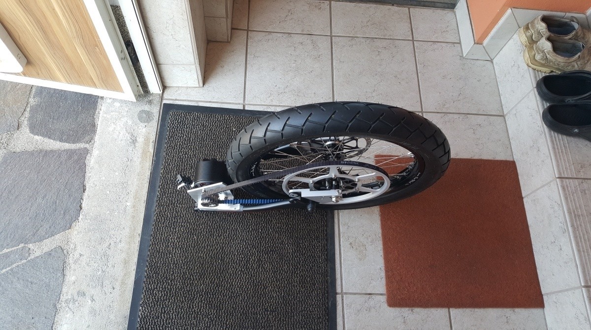

And i also designed the 108T driven pulley for the belt drive. This will be cnc milled out of Aluminum with grey anodizing.
It wont be cheap, but thats the price for a belt drive, and i don't know how i could get this fabricated in another way (the belt guide flange makes it expensive).
The motor pulley's are on order from Pfeiffer Industries.
One 18T custom made for my 12mm wide belt, and one 17T they had available which is for 21mm wide belt.
