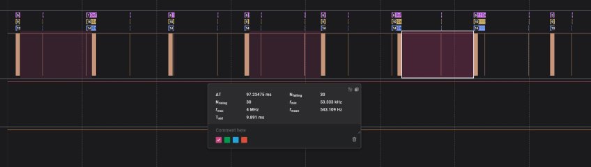

I've been following this thread for a couple of years now. Standing on the shoulders of giants such as meatlover and stinkygoalieguy, I've been sniffing out the code on the 24v greenworks batteries. I have a little mower that I actually really like for some reason, so I'd really like to power it with something north of 4aH.
here's what the waveform looks like by the way. I'm hoping this is all correct because I connected it to a 24v 3d printer heating bed, so who knows I guess. I'll update when this inevitably fails.
anyway, here's my code, written with the help of Gemini because God knows I can't write code to save my life.

Spoiler alert: this did not work. I'm grasping at straws at this point. I'm pretty sure chatGPT is like 3 messages away from reaching through the web and just disconnecting my internet. I've tried like 10 variations of this code, none of them work. Not sure what to do at this point.

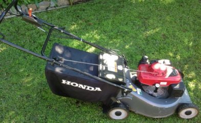

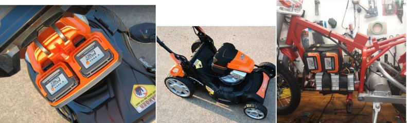

Gotta go for the Yard foce 120v mower. THen you can chuck them in your scooters too. ;)
mow1.JPGIts a monster.
