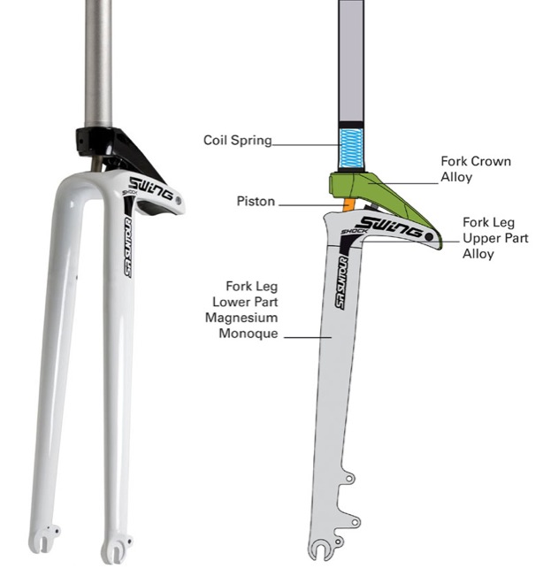

After much deliberation and rehashing of plans, I've finally decided on all the components for my build, would love any advice or comments and thanks for looking!
I've got this bike, Masi Soulville SS:
I'm going to order these forks, and will upgrade to a disc brake on the front:

Nice bike. You'll have to stretch the frame to make a hub motor fit that 110mm dropout. Hub motors are 135.
As for the fork... While that looks cool, all the lateral strength is coming from that tiny hinge pin, and when you hit the brakes, that thing will naturally want to pivot backwards. how strong the the part that keeps it from totally collapsing back into the downtube, and how reliable will it be at 20mph, braking hard, a year from now after 20000 stops?
I might put a fork like that on a neo-retro pedal cruiser that was mostly for show and never got faster than 8mph riding along the beach. But not for something experiencing the forces of an Ebike. I want to live.
Plus its made by sun. Their reputation for quality forks is that they have no clue how to make a quality fork.

You can buy a good 29er rigid fork, wide enough to use a fat tire. A 2.5 will give you about the same suspension feeling as the 30mm Swing fork, only more reliable
The rear dropout on the frame is 135mm, one of the reasons I chose the bike. Good advice anyways though...I almost bought one with the slim dropouts before I did my research. Regarding the fork, do you really think it would snap or something? I agree that the hinge is a bad tension point, but if it's not capable of some durability in regards to braking at 20mph (not really much faster than bombing down a hill on a pedal bike), then it shouldn't even be on the market. You've definitely made me think twice...I was going to order it today, but maybe I'll hold off and see what else I like the look of; thanks for the advice.
Yeah if I don't go with a suspension fork that's probably what I'll do. The current tires on the bike aren't bad at all though (1 5/8), actually a bit wider than the rim I had on my last ebike with the 9C hub motor on it.
