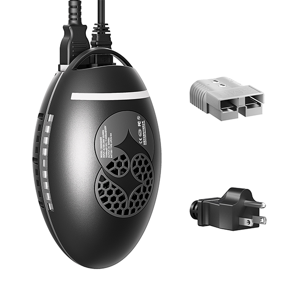

Just saw this today, cannot understand for the life of me what they were going for with the American Football shape... but at 1500W for a charger with easily customisable output parameters via an app it seems like a pretty decent product if it is actually well made:
Edit - It's actually a bit more complex that I thought, you have to buy the right model for your voltage and I *think* you can then tune in the app. The 1500W is also only available at one specific voltage, most of them are more like 1200W.

So it's not quite as flexible as I thought, I have updated the OP with a reply from Daly about models and voltages. Their replies are decent in terms of Chinglish, I have asked a bit more about the app.
It always astonishes me how poorly companies like Daly set up their websites and organise their various models. The same goes for JK as well. They have a myriad of updates and models and 'promo' material which contradicts and confuses but they never seem to want to sort it out and make it clear. It would take an intern a day to actually make it clear but they seem to insist on having it as confusing as possible and omitting useful info like the table I posted in the OP in my edit.
Re: Pricing, the Daly website links to a Daly web store which has the charger for $444. But Daly products are often found on AliE for significantly less - This listing has it for $269 - https://www.aliexpress.com/item/1005009362153191.html
But you would have to be very clear about model numbers and what you are buying.

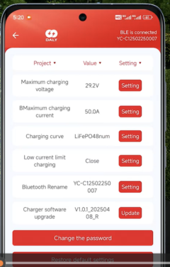

They have replied saying that once you have selected the model it will work in that voltage range... But it is obviously not completely clear what 'range' that is. You can also change the charge settings, battery type etc.
So I guess still useful within those parameters. They said they are uploading a more detailed app walkthrough "next month".
I have offered to test it for them if they want to send me a unit, but I don't have any influencer cred so I wouldn't expect them to send one.

Just ordered one of these. They seem kinda good for a ready to go charger, and they now do a 25A/1500W version. Contacted them via Whatsapp and $200+$50 shipping to the UK.
Let me know if anyone has any questions.

Received this the other day and I'm honestly pretty impressed.
It's a hefty unit that feels well built, and the app is simple (It's the Daly BMS app, but you just select the charger) and works well for adjusting voltage and charge current.
Beneath the football 'shell' is a somewhat similar design to these kind of chargers:
At lower currents it's extremely quiet, and then fairly noisy once the fan ramps up. Nothing out of the ordinary however.
For the price - $200 USD (and then $45 postage) I think it represents really quite amazing value for money. I'm not sure there is anything else that can be had for this price that offers this kind of functionality with up to 25A charging.
Chinese marketing departments (if they even have them) come up with some weird af angles to sell their products. IDK who thought leaning into the football thing was going to sell these. But beneath all of that weirdness is what seems to be a really quite solid product. If any of this changes long term I'll be sure to update the thread.
