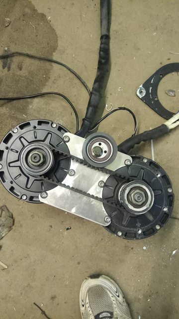

Hi guys I wanted to show you what the very compact and super powerful Nuc24F can do. I have to accelerate slowly so as not to crack the belt. In V1 100A batt and 160A phases I can accelerate on the floor. With 300A batt, 500A phases and the FW at 300A the engine gives all its power but I don't accelerate I went to the start, because otherwise I will destroy the belt. For the moment I am not using a tensioner roller, but soon I will install it and really enjoy the super accelerations provided by this controller and this engine.
PITMIX i have this type of pensioner for the belt, its from a car, kinda cheap

Hello, for the moment I have got 16,7kW but I have a lot of difficulty in passing the power because my transmission pinions under dimensioned. I can't accelerate to the maximum in risking destroying the belt. I'm going to replace the small 22T gears on the motor and the gearbox with 56T gears. The force will divide by 2.5 on the belt compared to today.
Currently, in order not to damage the belt, I must adjust the phase intensity to 250A max and 100A battery. I tried 300A battery and 500A phases but when I press the pedal fully the car doesn't move and the belt slides as if it had no teeth. :roll:
