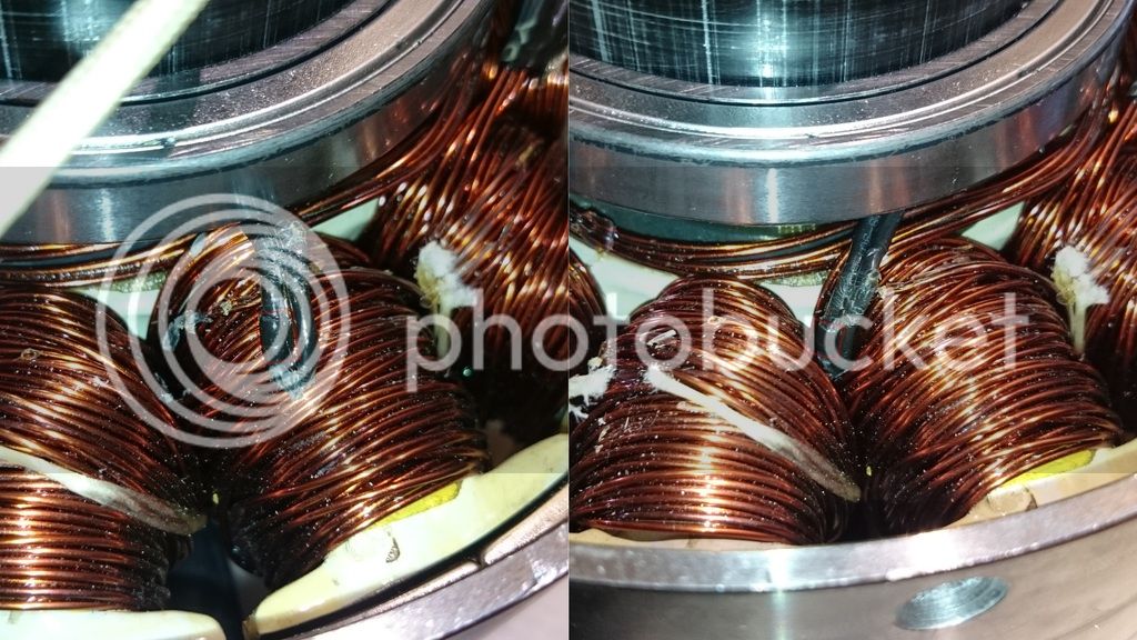

Wow, that is pretty low copper fill :shock:
This motor would benefit from rewinding...
I was thinking about why thermal probe have so high lag... rigth side how it was installed. Red square exact diode location.
Quote from revolt:
Temperature sensor is installed between the windings directly in front of the hole, poured lacquer. You can't see it - it is covered with copper.
Ha ha. i can see it actually
That's good news on the lams at least, because phase-phase resistance of 80mOhms. My Revolt 120 is just under 30mOhm. Can you please double check. Why on earth would they go Delta when trying to get to the relatively low Kv of 45rpm/v for that style of outrunner? I say go WYE for fewer turns and more copper on each turn, which should be easier to get good copper fill, and also no potential for "recirculating currents" side effects of Delta, something that's still a mystery to me.

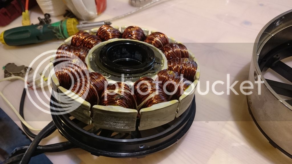

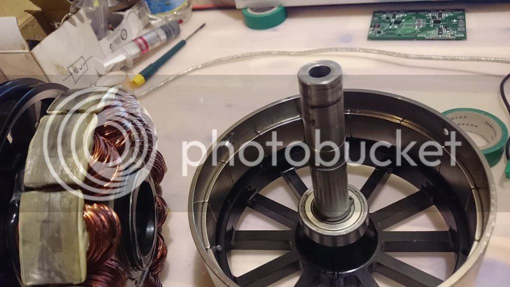

And finally some photo of RV160s

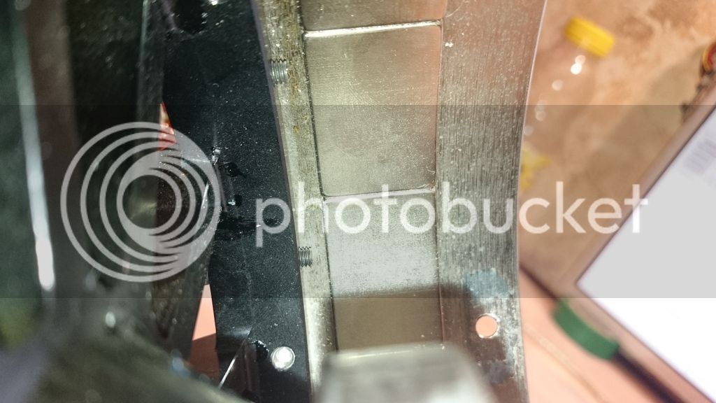

magnet width 25mm... winding NOT 6 parallel wire, but 5. im quite dissapointed with this motor

Wheazel here is guide from revolt
1) remove screws
2) pull out rotor, you can hook on red triangle, and pull on blue line
3) remove lock ring
4) hold stator, press out axle with rear cover. beware - bearings on glue
5) remove bearings from stator if you want
Magnets not really strong, but there is nothing to hold on to pull out rotor

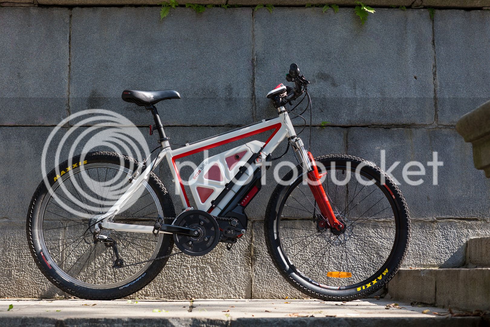

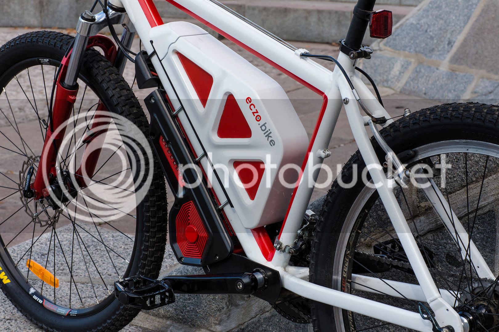

Finally started preorder for eczo.bike project based on this electronics. (bms, controller, tracker, lcd)
This is small kit for conversion your bike. Just about 10kg
2kW motor, 900wh battery. (well, actually we running it up to 3.5kW for tests }:)

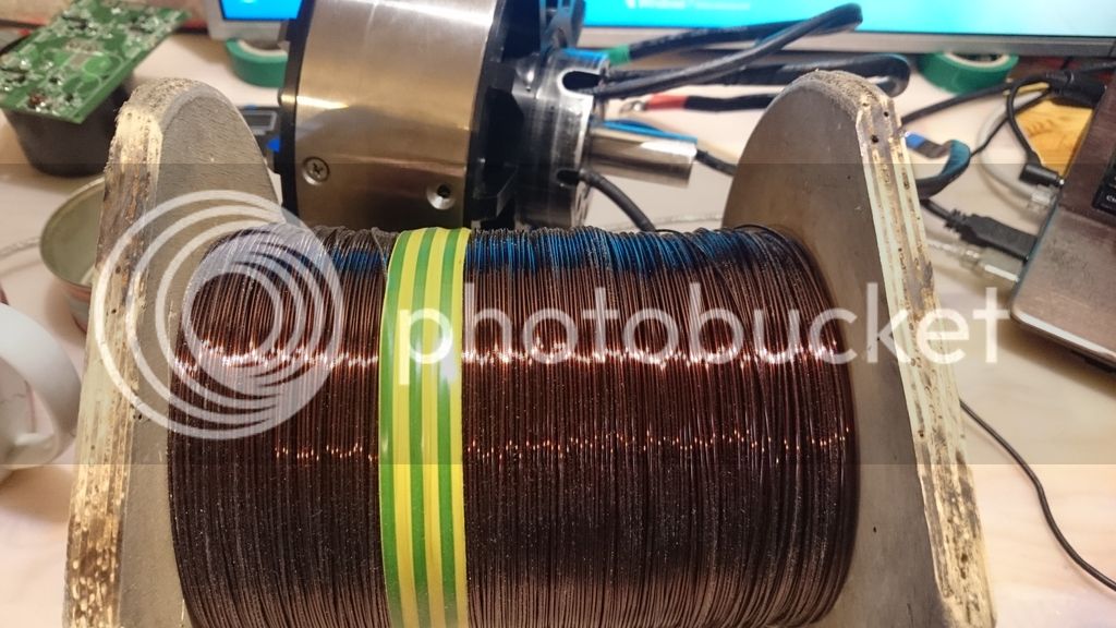

Hello, did you ever rewind the rv160? It would be really interesting to see before and after measurements compared to how much extra copper you could get in.

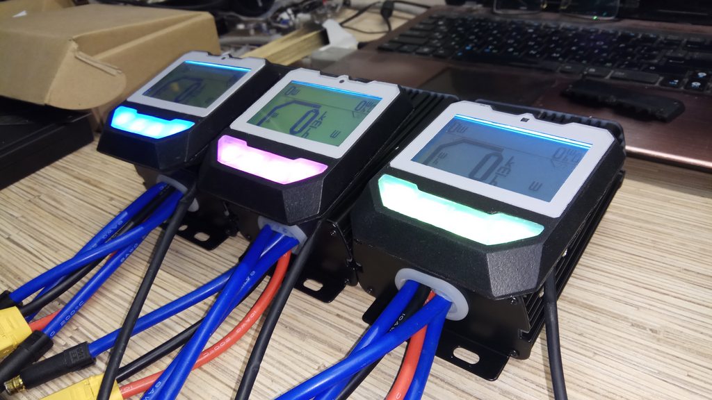

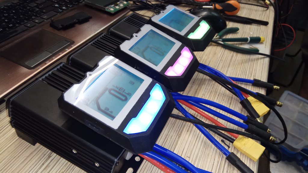

Hi guys, came up with a little update for you

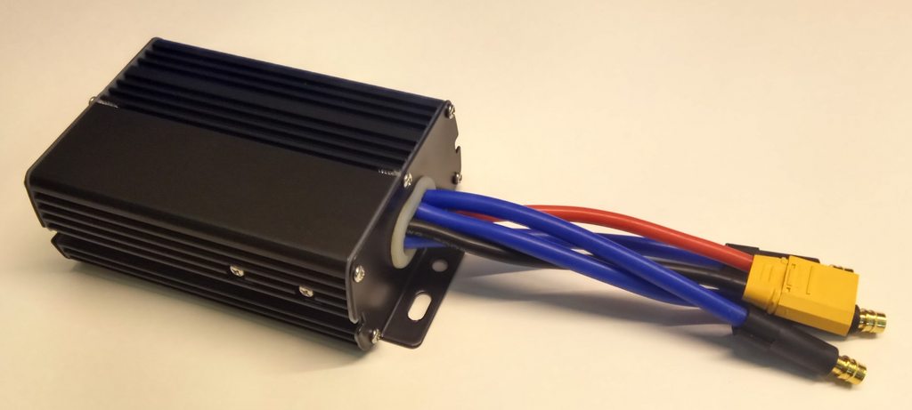

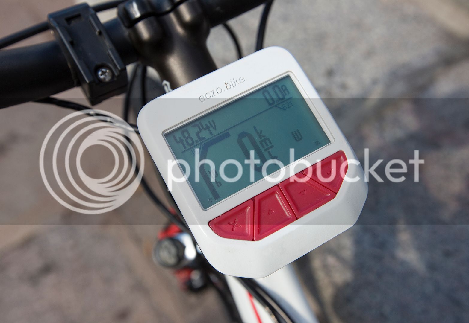

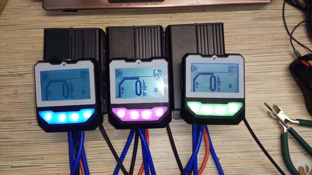

I have started testing of my electronics kit in Russia, here some photos of this <beta> version:
12F controller, up to 90V, 200Aph, 150Abatt. Well protected, good heat dissipation, compact size (like a 9F). BT4.0
LCD, 240x128px 3", RGB button highlight, USB 2A charger, microSD slot for software updates
