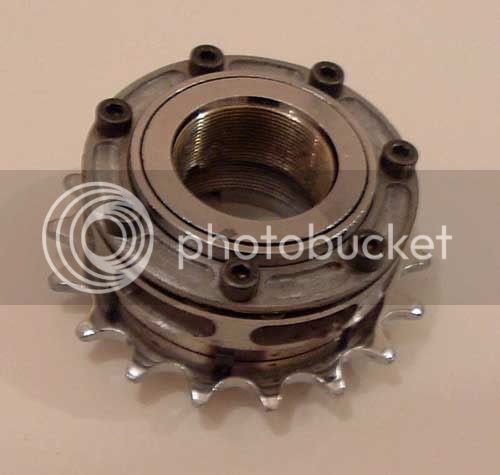

hi guys first post.
I am custructing a 3 wheel drive recumbent trike and I am thinking of using one way needle bearings instead of this jigger I came up with:
This thing acts like a crude differential for my two front wheels, it's basicly a coupling I made that fixes two ratcheting bmx sprockets together. I would use a pair of 25mm I.D bearings on some machined down 1" cro-mo shafts which I would case harden. If this would work not only would it be much simpler and lighter it would also be much easier to package in my very complex and camped frame arangment.
What I want to know off people is how good are these bearings against strong forces? could a 25x32x20 bearing hold the torque of a riders legs after being geared down? I know the question is vauge but I need to start somewhere. I know that these are sometimes used on a motor shaft and I plan to do exactly this for my motor assist but I don't think the force is even remotely comparable because the torque is spread over a high rev range unlike the pedals spun at 30rp/m pushing against a solid seat.

You need to know roughly how much torque it will have to handle and then look up the specifications of the one-ways.
A drawn-cup roller clutch or a sprag clutch for that size of shaft should have a nominal rating of about 65 Nm.
Divide the torque at the cranks by the gear ratio in the lowest gear to get the highest torque at the wheel/shaft.
How much torque at the cranks depends on: What length cranks? How heavy you are? :) Probably 100 Nm would be a ball-park figure...

You can get roller clutch units with support rollers added (obviously, they're wider). I think I would use a sprag clutch, with a built in radial bearing, though.
I forgot to mention I would have lots of room on either side otherwise the sprag clutch would be the go.
Doesn't get around the fact that I want to put probably 5x the rated torque through it. Do you think a simple licking collar on either side of the bearing would surfice?

100kg force converts to 981 Newtons
1M / 0.17 = 5.88
981 / 5.88 = 167 Nm at the crank axle
167 / 2 = 83.5 Nm at the wheel shaft
The nominal rating of the sprag clutches is half the peak capacity - not sure about the roller clutches..

thanks Miles, I will have a good look at the calculations and see how you worked it out. However I beleive that due to my lack of a proper explination you made a mistake. The drive is geared so 2 rotations of the crank equals one of the wheel shaft. So would I be right in saying that it would be 167 x 2? so a total of 334Nm?
Now heres another one for you; this would go on just the drive-shaft of one of my three wheels. So wouldn't that mean that the bearing would only see one third of that torque? So 334 /3 = 111.3 Nm. If this is right this tottaly confirms that I will stick with my twin coupling I have pictured above.

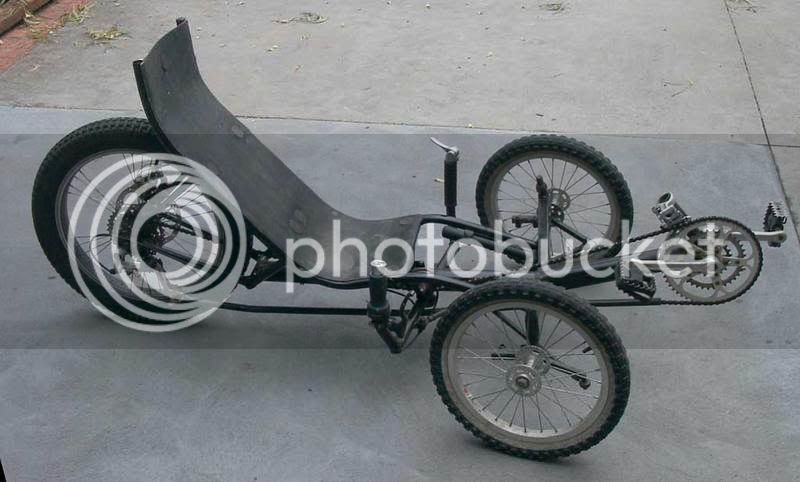

You probably saw it but here my current trike #3
15kg (33lb) last time I checked and apart from the King-pins its all mild steel.

Correct on the total torque.
Correct on the torque per bearing, if there's equal distribution.
Wow, that's some superb engineering, particularly for something that's designed for offroad.

Miles indeed it is, thats in my lowest gear:
crank 22T to the 32 tooth in the sprocket cluster, then an aditional underdrive with 13T sprockets on the center shaft and 18T sprockets on the either end. So 22:32 and 13:18, using only 20" wheels it means I have a 9.93 gear inches compared to 17.85 with a mountain bike using 26" wheels.
Right now I have a 24:35T combo which is 13.7 gear inches, and even though thats considered seriously low I still get stuck between pedal strokes often when in mud or going over rocks/branches/ridges/etc..
Grinhill: It's some ok engineering but moreso a minimalist approach. For a start:
Rear brakes only- I only have ever had rear brakes on my trikes, this is generally considered a suicide approach but I don't go that fast and I only have bushes and enbankments to run into, not cars. Disk brake calipers and particulally drum brakes are really heavy.
No adjustable boom- this is my trike and its for my size, so that means one less length of material to have the boom slide in and out for different height riders.
No suspension- although this might be odd for an off-road machine most of my riding is tricky low speed stuff/ie: running over everything. Having no moving arms means I can have my seat very close to the frame and chain, so a lower center of gravity. A lower center of gravity lets me have one of the narrowest tracks (front wheel to wheel width) of any trike so I can no only have a super tight turning circle but also fit between trees/posts/etc
I made this thing roughly 8 years ago though, since then I have learned how to do machining and also a heap of other usefull stuff. So this new bike should be interesting. This coupling I have pictured shows how crazy I am going with lightening, every gram I can remove I am removing.
For the electric assist it will be heavily geared down for huge torque at low speeds in short bursts and I plan to have interchangable pinions and an additional bearing support to stop all side load on the motor.
