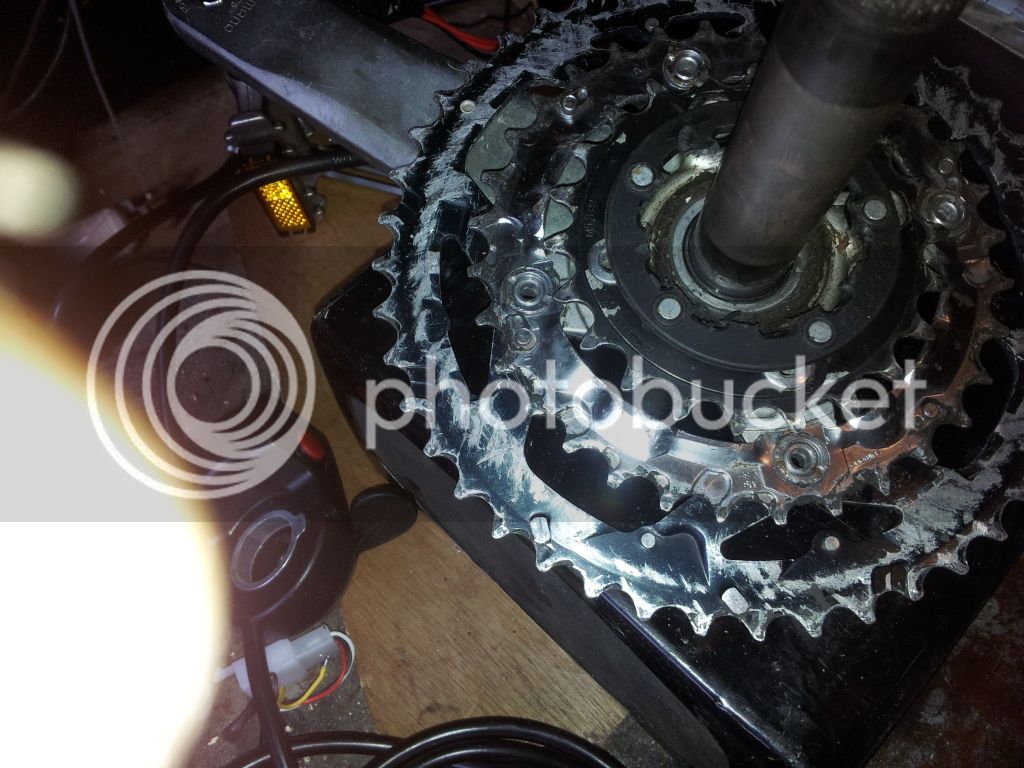

I’m hoping for advice about mounting a PAS (pedal assist sensor). The donor bike for my project is an old Trek hybrid. The (current – one of many) difficulty I’m having is that there doesn’t seem to be enough space on the crank arm for the sensor.
I removed the bottom bracket and installed the metal disk with the sensor behind the lip as below:
I then slipped on the plastic ring with the magnets and reinstalled the crank arm. However, it just pushed the plastic ring into the sensor, so they bump across each other every time a magnet goes by and there is a lot of extra friction. Part of the problem is that the screws holding the chainrings together get in the way of the plastic ring, so they push it out (into the sensor) a couple extra mm.
My possible solutions include:
---Look for a thinner plastic disk
---try to install it on the other side (although there is nothing there to keep the sensor in place, I guess I could glue it, also it still doesn’t really look like there is any more room),
---I could try to carve out the plastic to go around the bolts although since there are 8 magnets and 5 bolts, there will always be at least one magnet in the way.
---Get new chainrings? We have wicked hills so I really don’t want to drop to 2 gears in front, but that would be an option. I need to get new shifters regardless.
---Get a longer bottom bracket? I don’t know much about this. I wouldn’t want to make it awkwardly wide, so I would only want a couple more mm.
---Get a thinner crank (i.e. the part that pushes onto the bottom bracket)?
For the record, I have no idea what I’m doing. I’ve watched a lot of Youtube, read a lot of blogs, and talked to the local bike shop guy (not an electric bike guy) a few times, but that’s mostly it for my knowledge base.
Thanks for any help!
Dano
