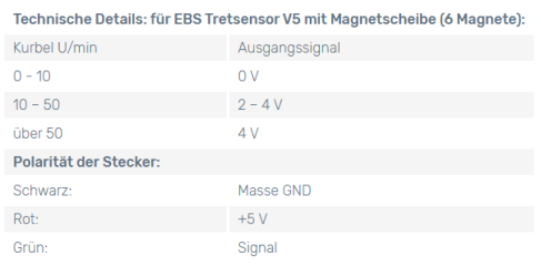

You can choose a "V5" PAS instead, this has a linear voltage output proportional to the cadence and can be connected to the throttle input of the controller directly.

thanks for the info, didnt know things like that existed. Ive been searching for ages trying to find a solution, and the arduino pas to throttle seemed the only option with a fardriver controller.
Ive als=ready bought all the parts now for this modification, although they werent expensive to be honest, if i find it hard to live with on a daily basis i shal lfor sure buy that V5.

thank you for the link and advice, do you know if this has been tested with a fardriver controller by any chance, thank you.
