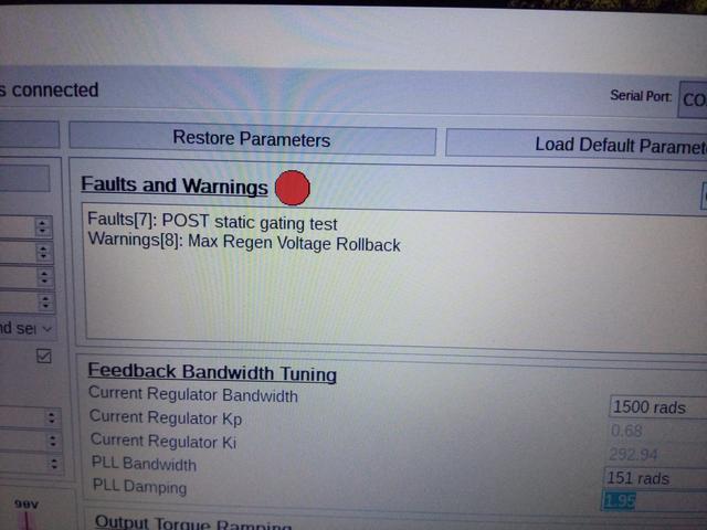

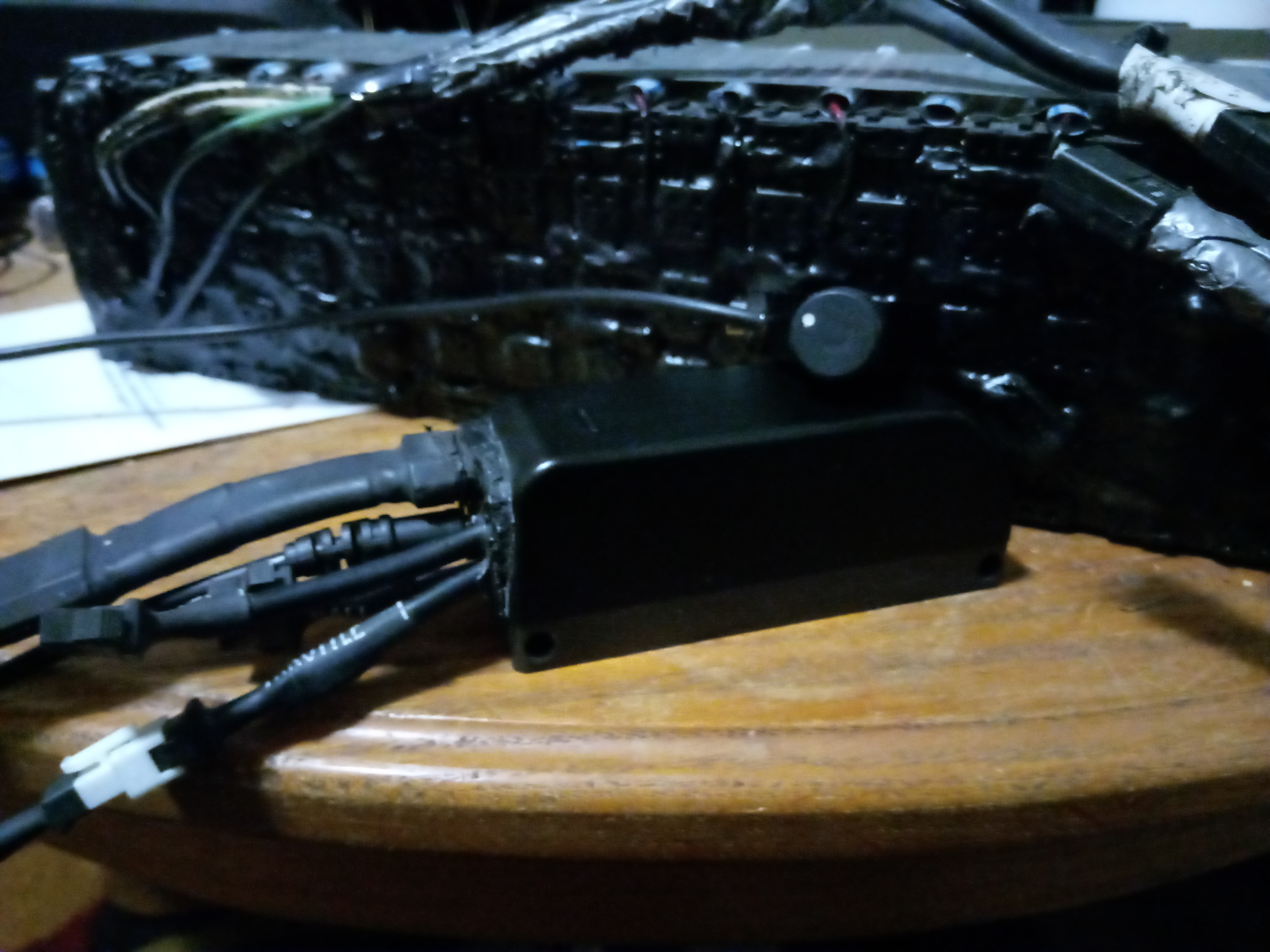

im getting code 1-8
POST static gate test outside range
went to store no problem,
come out and no go
the throttle bar on the ca goes up and down.
i disconnected everything to check connections
put together and still no go

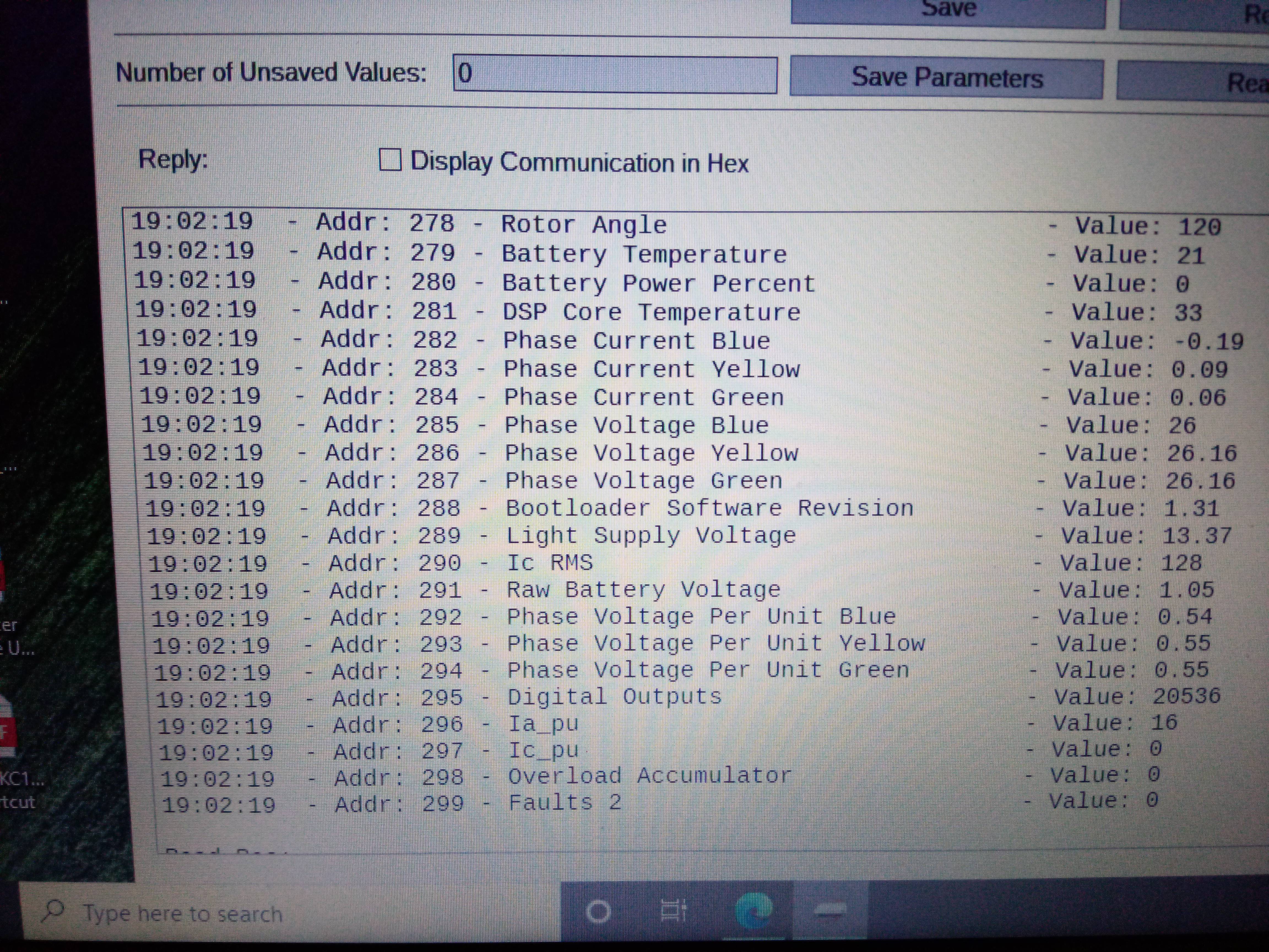

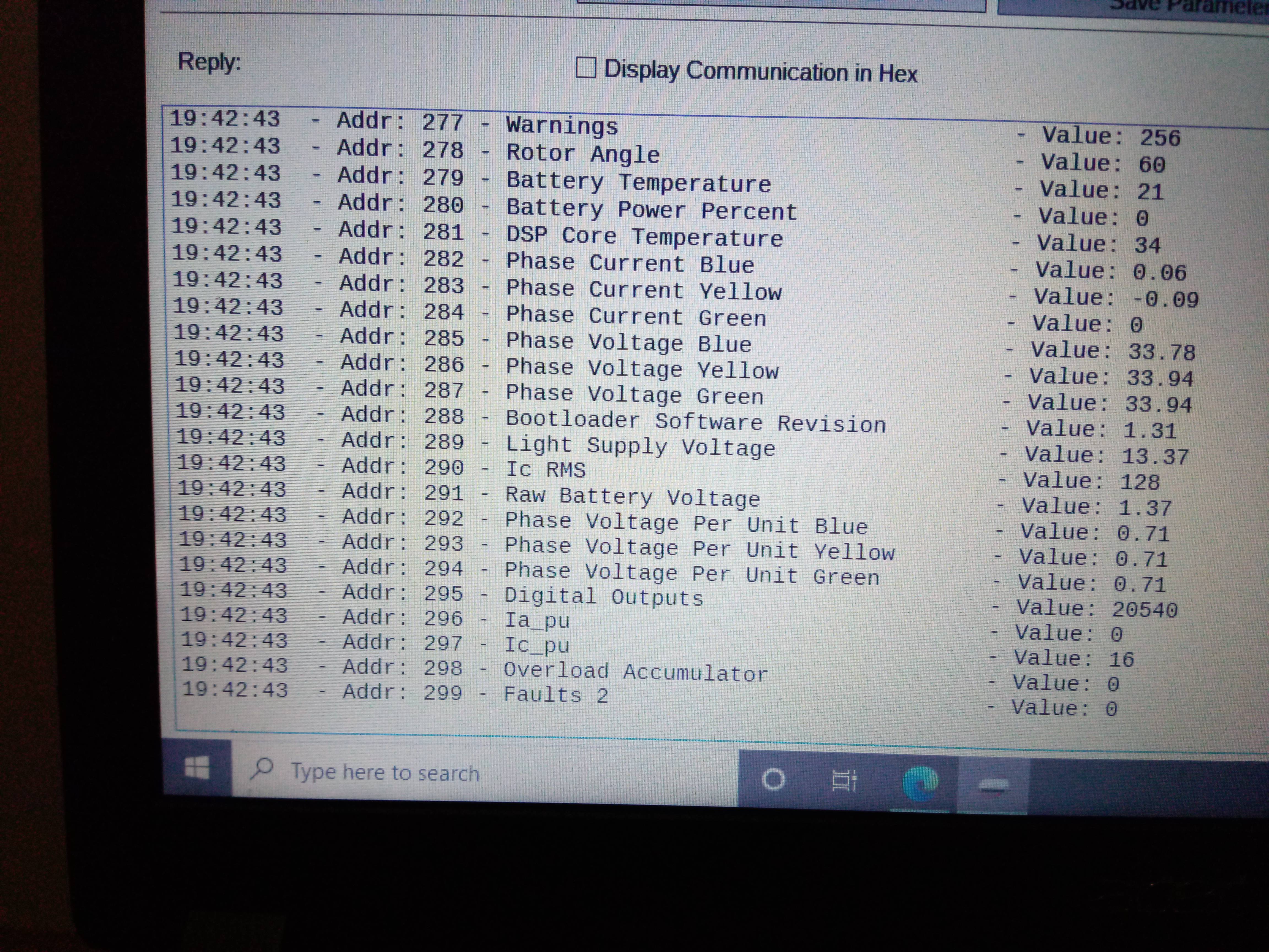

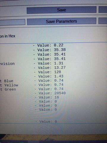

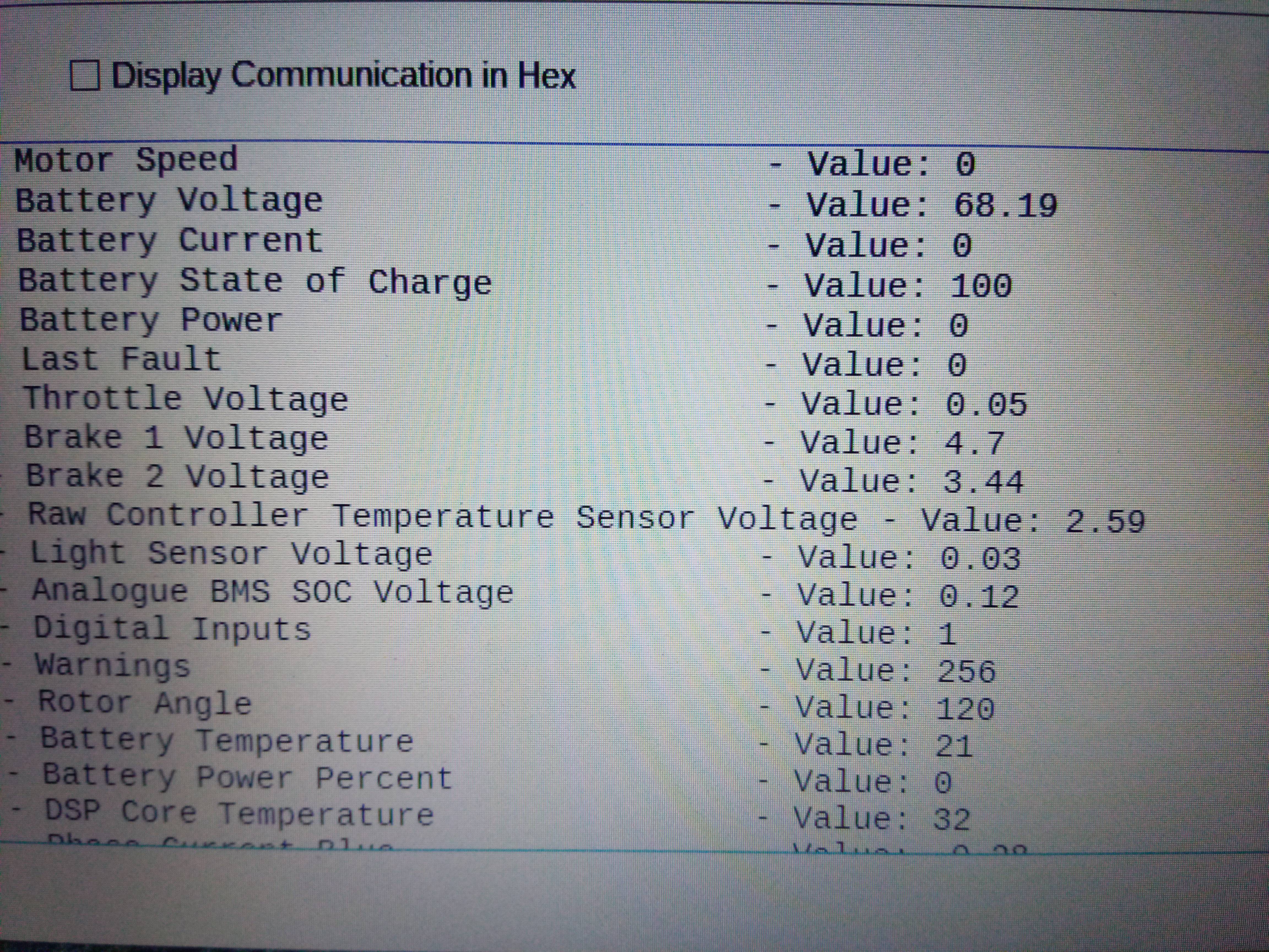

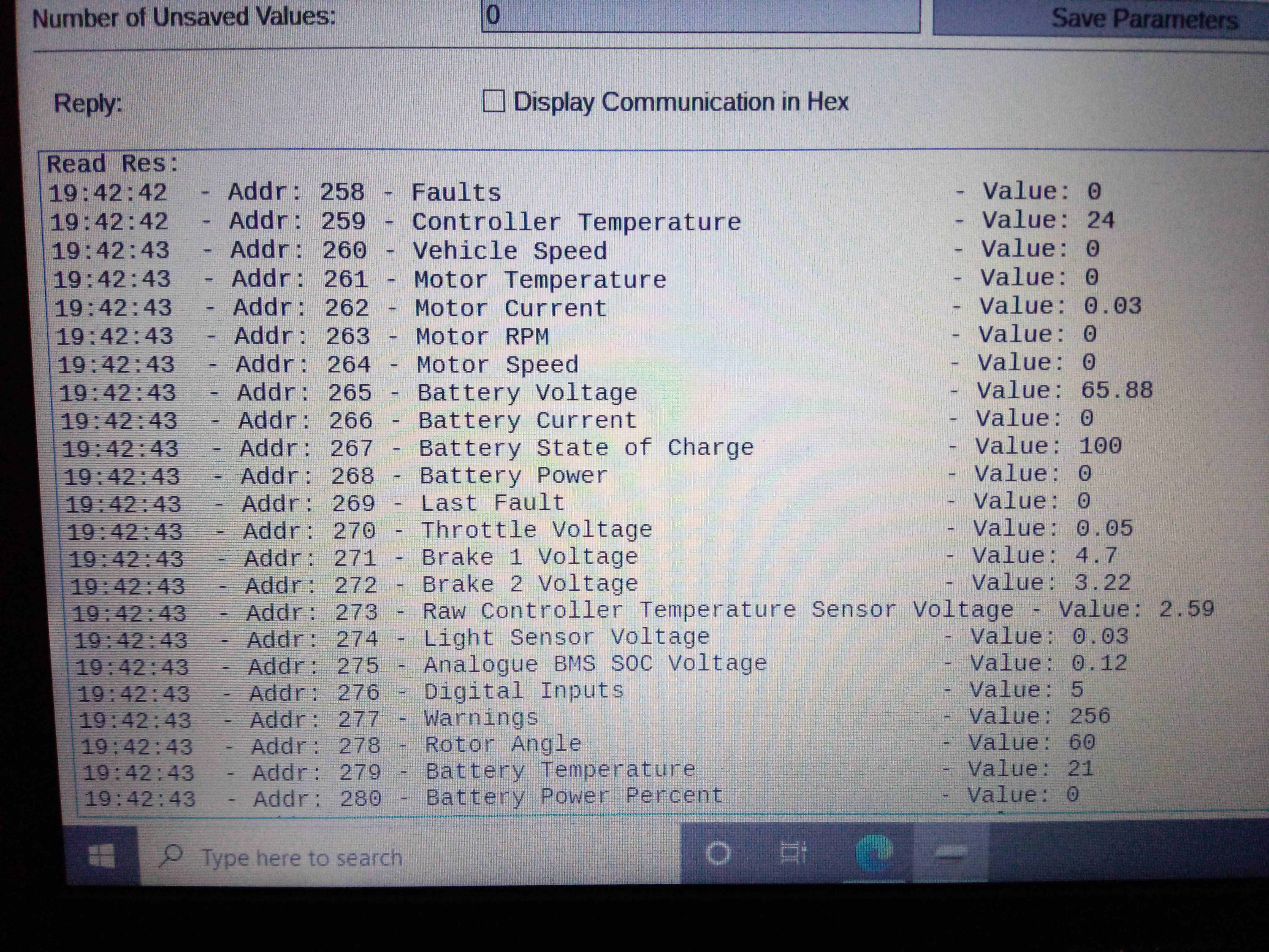

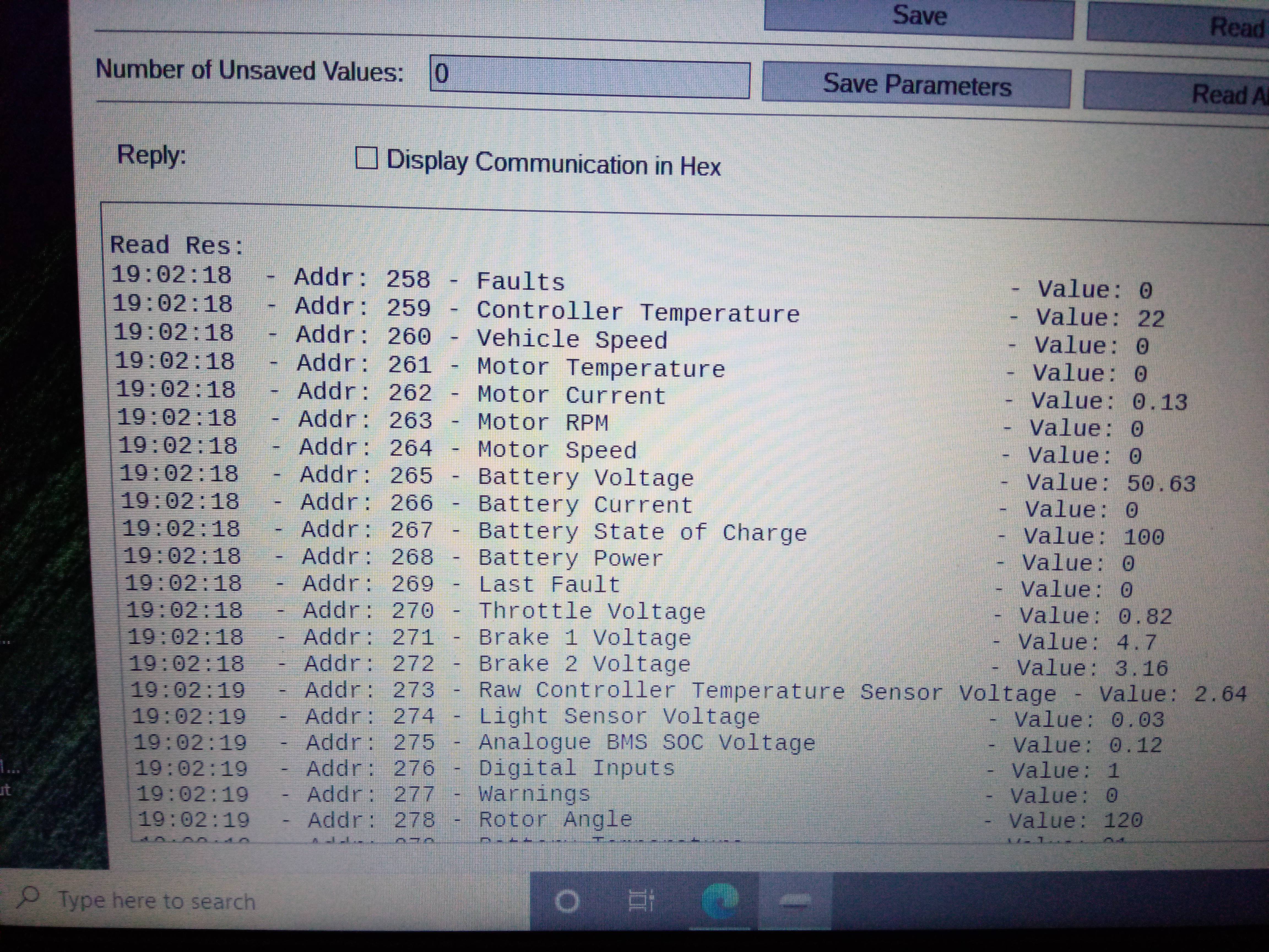

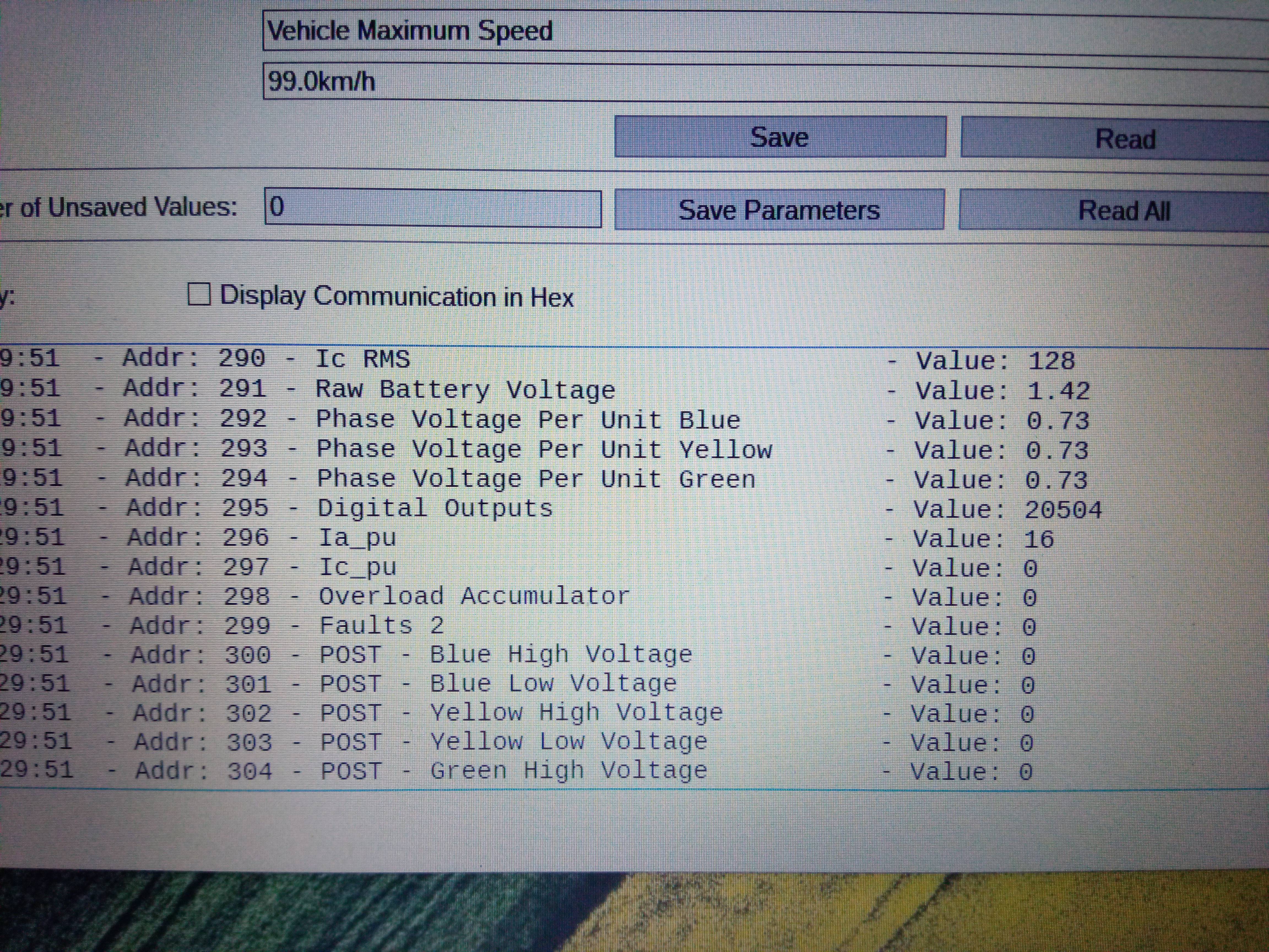

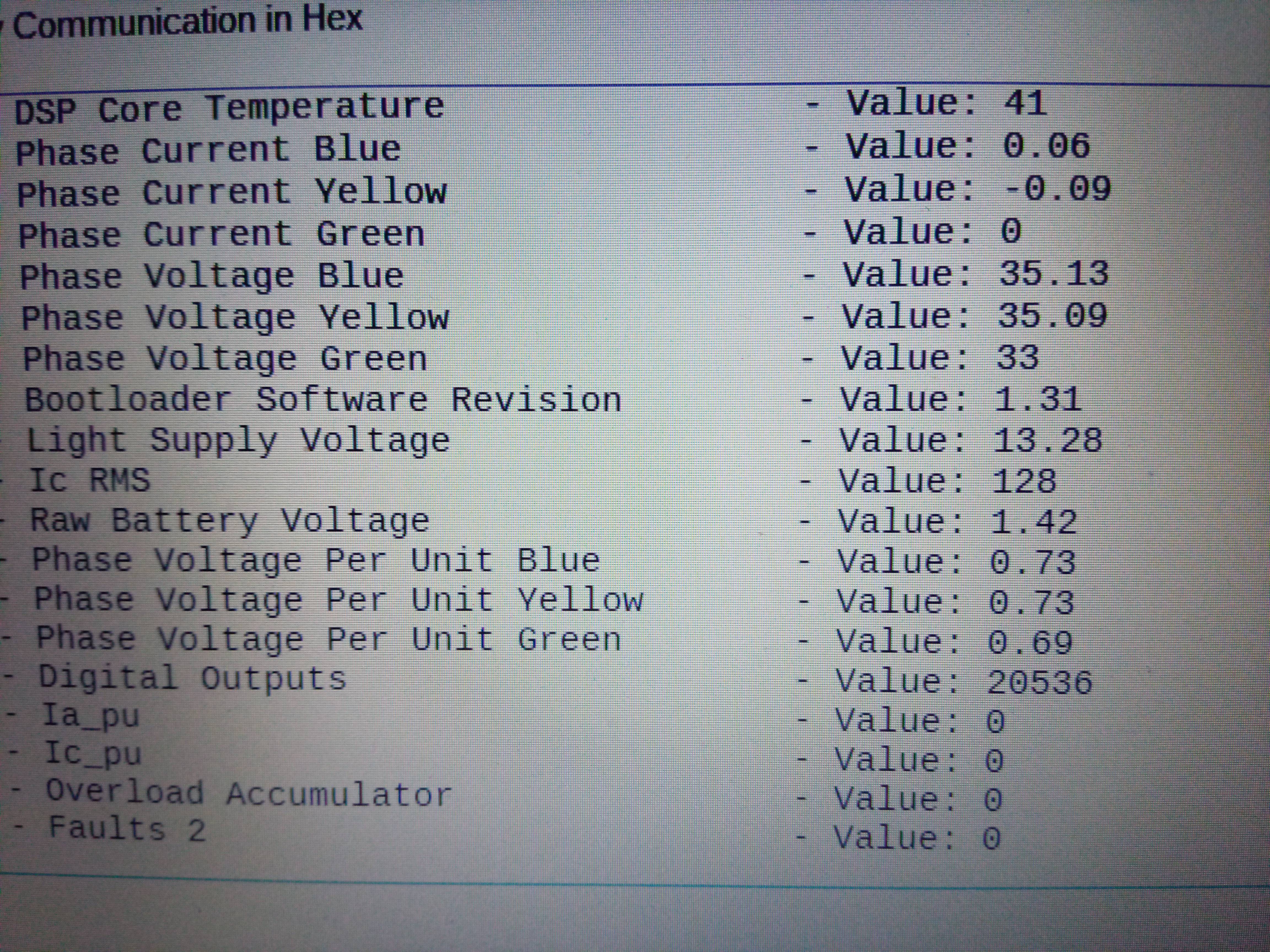

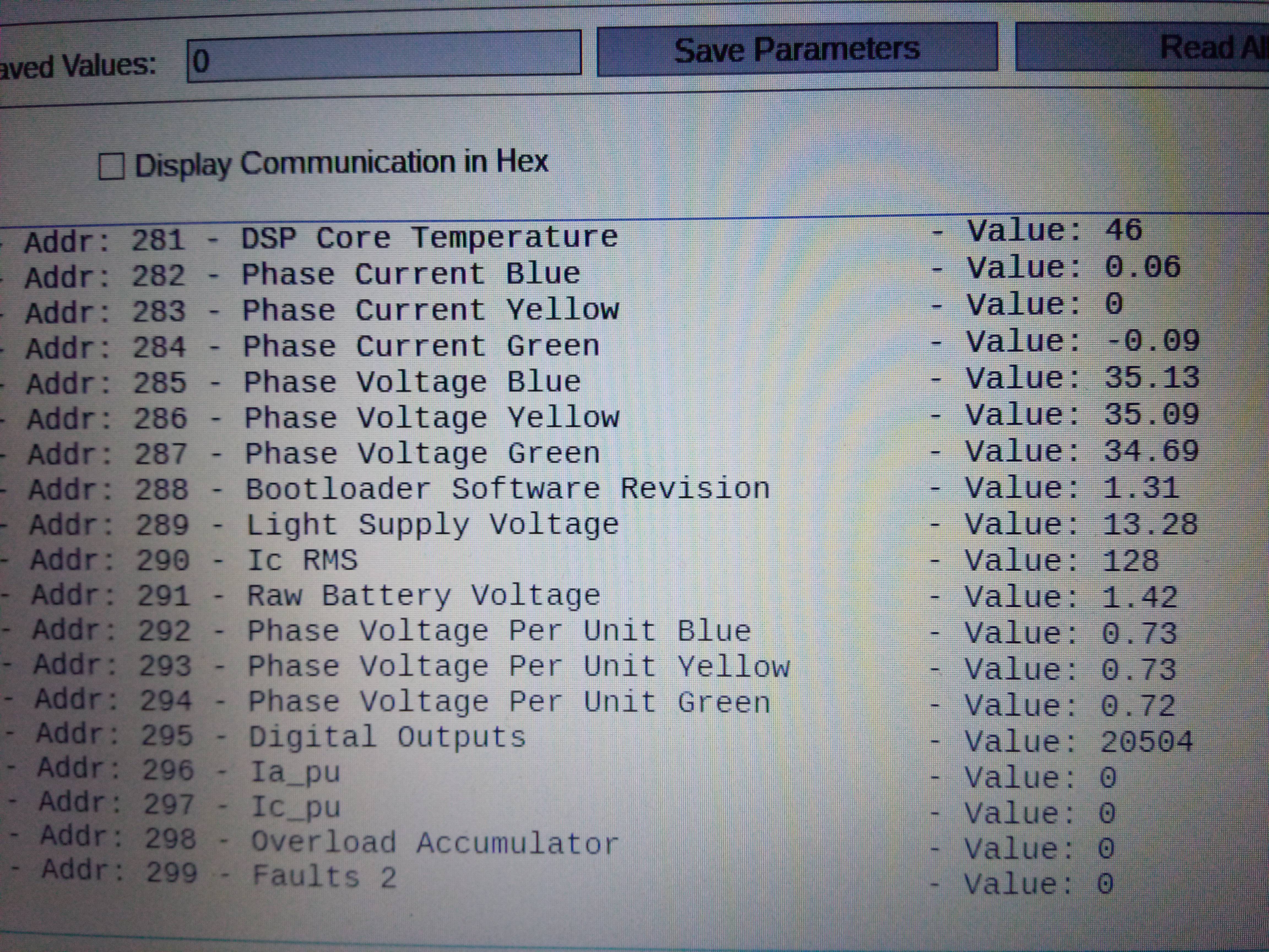

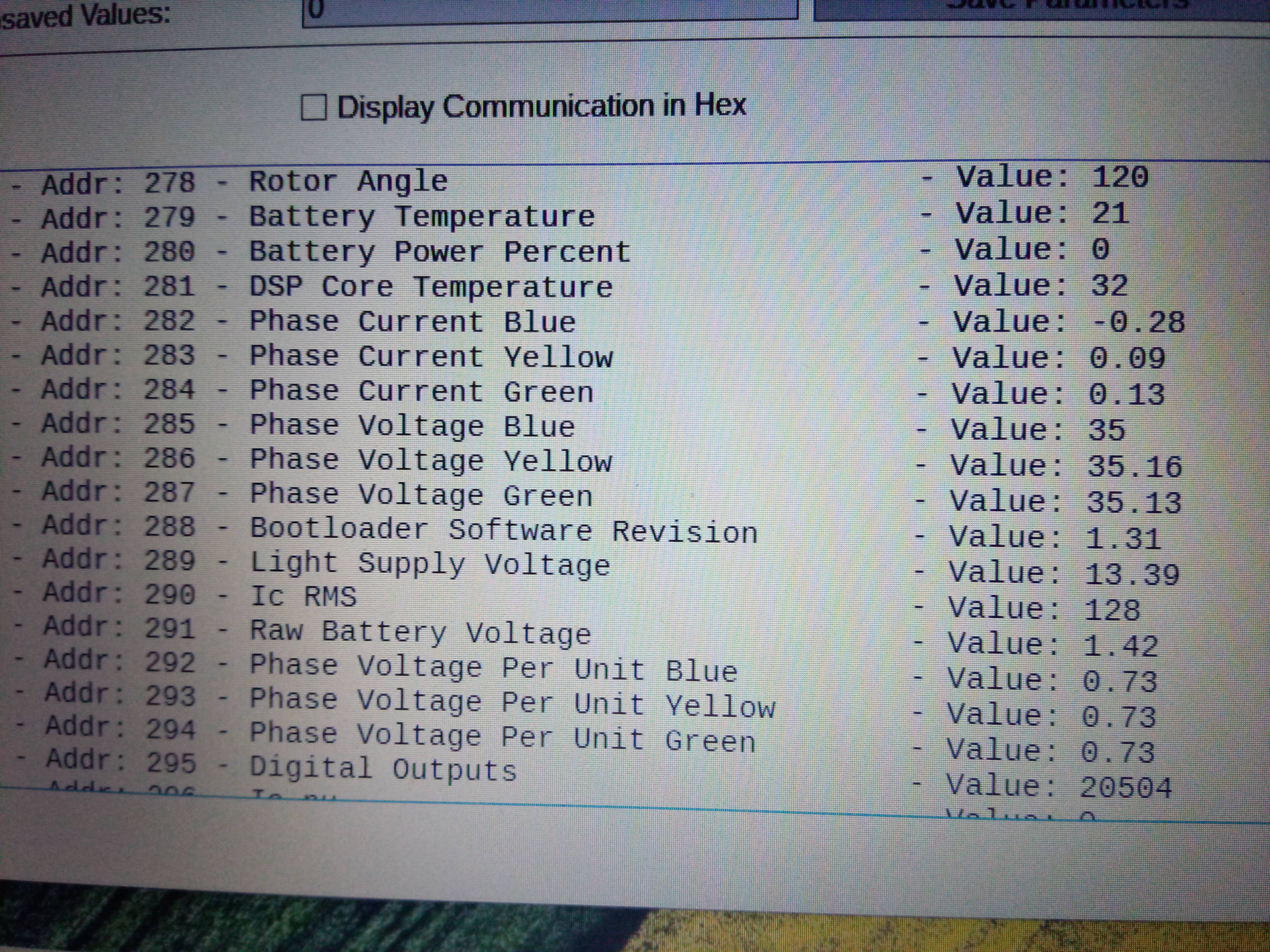

when i got home i hooked the bike upto the laptop and no error or faults being shown pr suite and no settings mentioning static gate.

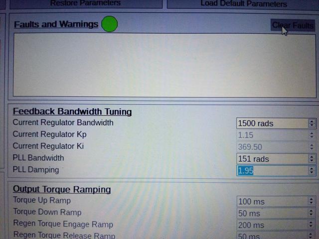

im going to clear and reset the phaserunner to see if it works
i cleared it, the light was steady red on pr, touched throttle and code started flashing and pr suite showed error
im going to clear faults again, disconnect the ca3 and connect throttle straight to pr to see what happens

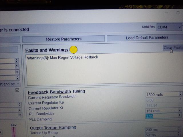

no ca3, throttle straight to pr same problem but i noticed PLL dampening stays highlighted in blue
if i hover cursor over PLL dampening i get another window describing what it does
***this parameter determines how much damping is present on the phase locked loop motor RPM tracking***
not sure what to do with this setting, i think easiest solution would be to wipe the phaserunner and reload default parameters from grin and then make my changes to the other settings again to the freewheeling, field weakiening, torque ramp rates etc
that didnt work, tried to do the autotune but got fault code again
good news is i think i figured it out

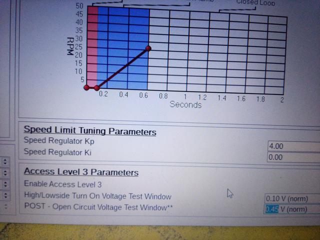

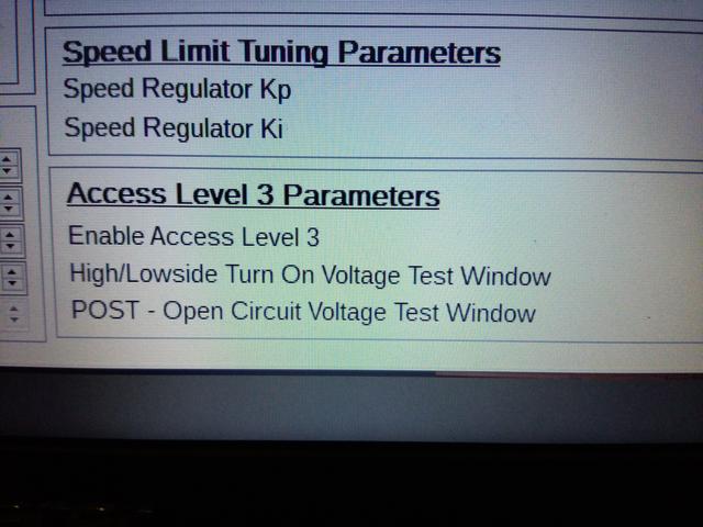

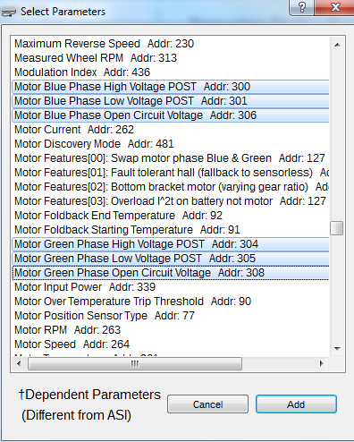

go to advanced setup page and in lower right corner youll see this, access level 3

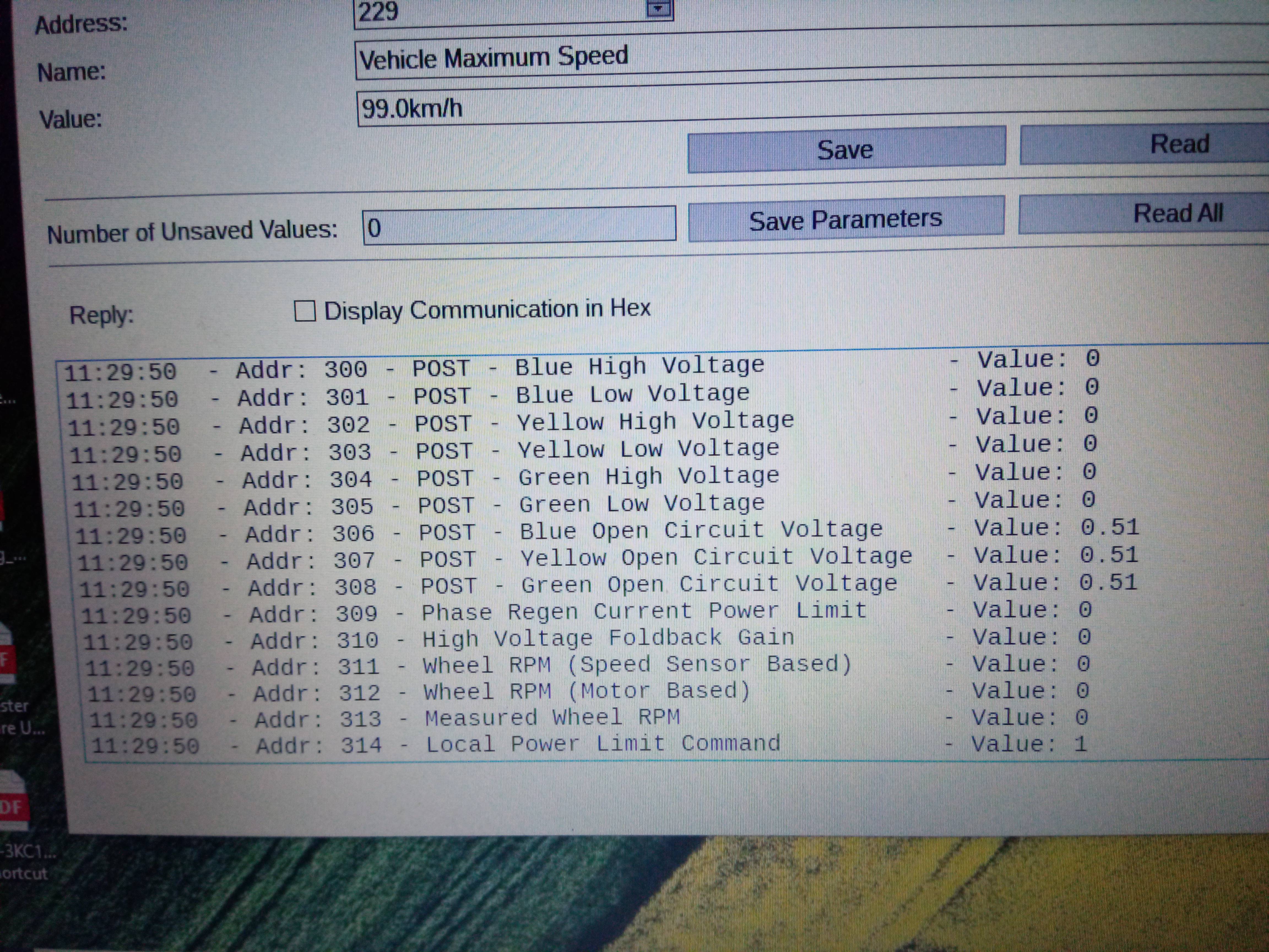

hover cursor over POST and it mentions that if theres a conductive path between a phase wire and v+ or ground like when its pissing down rain, will cause the fault code.
sounds like i got water in my motor and somethings shorting???
i think it sends out 0.25v and if somethings wrong in the motor it shuts down

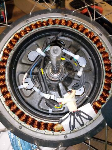

i rewired this motor a month ago, it still looks good, no water anywhere
https://endless-sphere.com/forums/viewtopic.php?f=6&t=103834&p=1597162&hilit=scorpion#p1597162

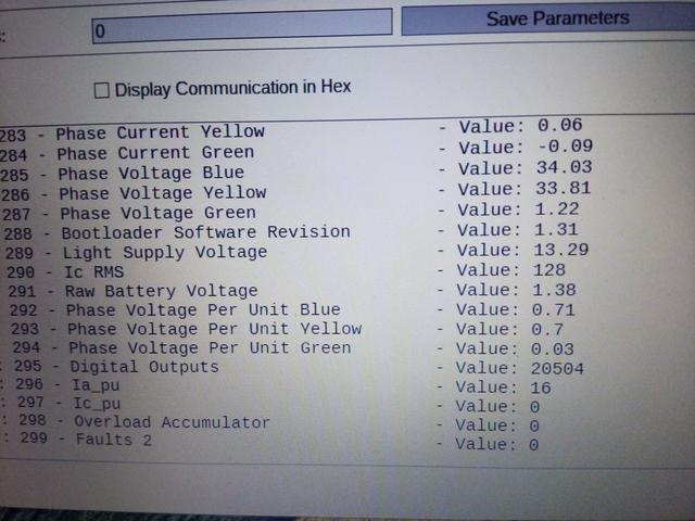

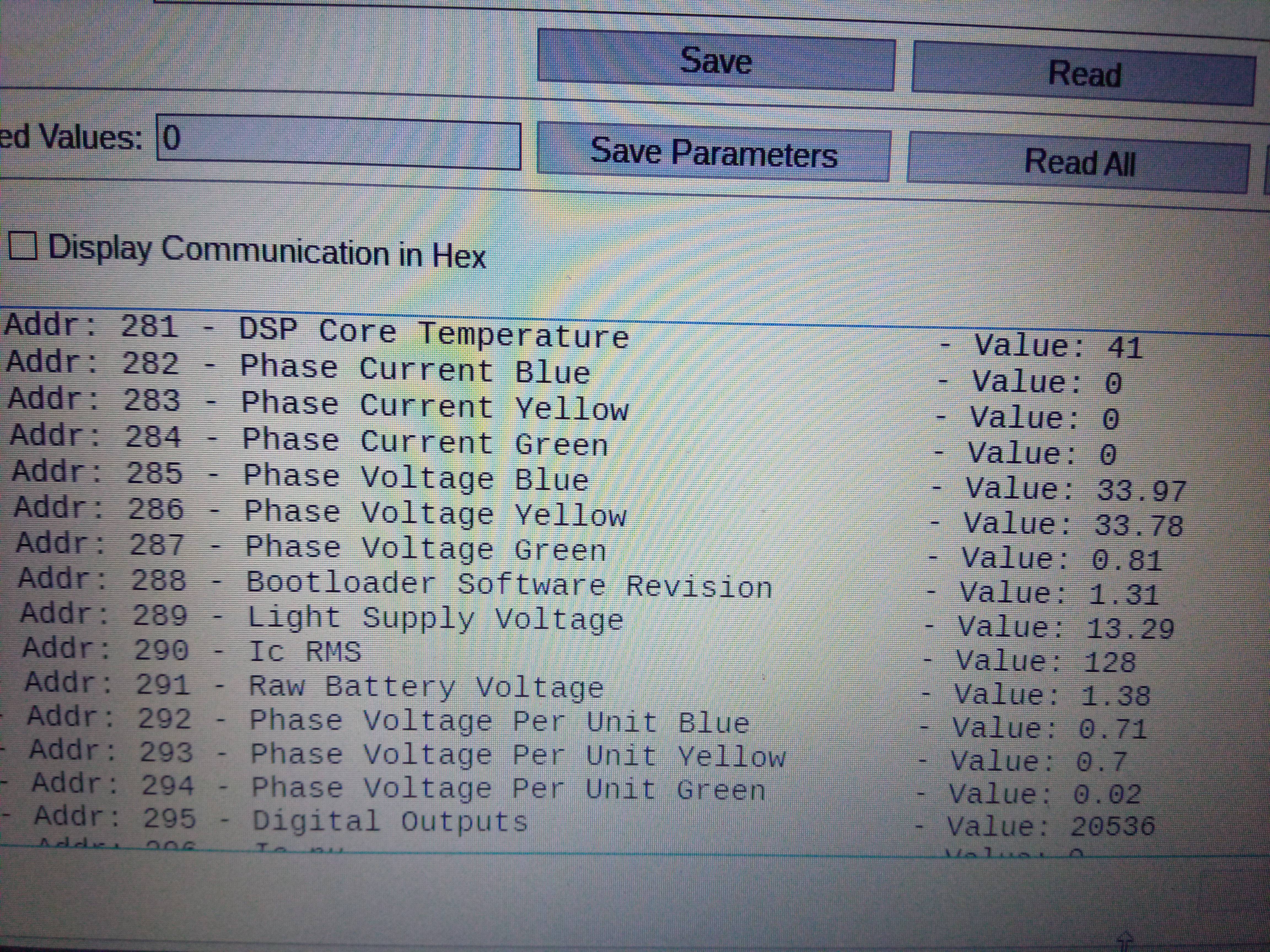

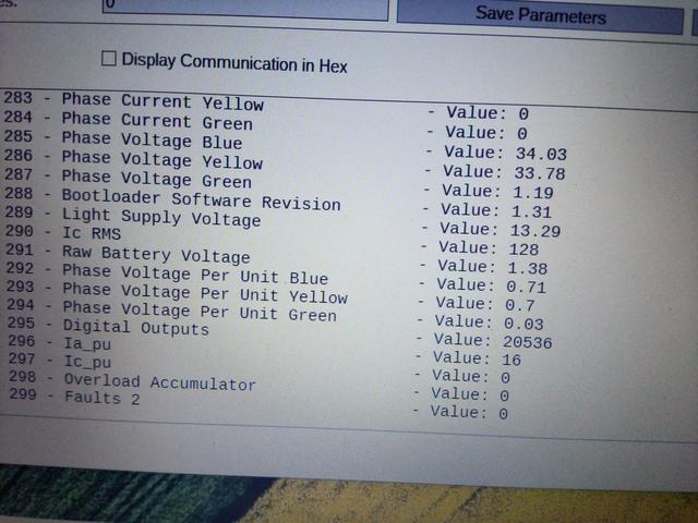

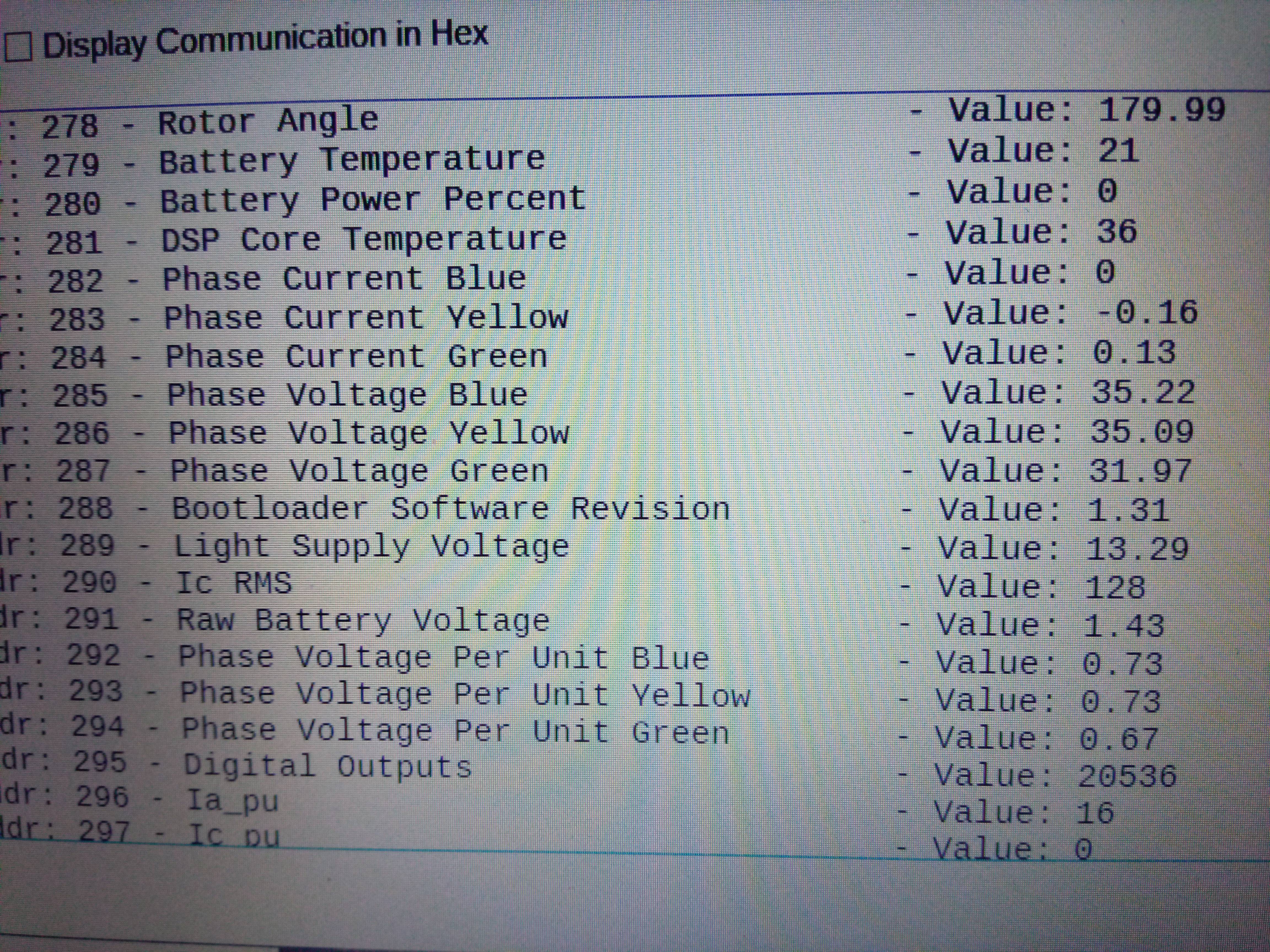

do some continuity testing to see if i can find the problem
nope everythings fine with the motor
i have another phaserunner, ill go grab it tomorrow to see if the problem is with the phaserunner
