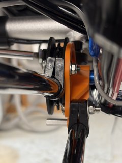

Unlike most other parts referenced here, the anti-rotation plate is profile cut aluminum plate. However, for test fitting a prototype 3D printed version is perfectly adequate. 3D printing is simply awesome for prototyping in general. The first image shows the Gen 2 mid drive with the Gen 1 anti-rotation plate and an orange coloured 3D printed prototype of the Gen 2 anti-rotation plate. The two motors are similar enough that the Gen 1 plate would actually work. It interferes slightly with a radius in the enclosure casting but this could be addressed with some filing. By making it longer the screw that will affix it to a T-Cycle idler mount will be accessible outside the radius of the CYC 50T chainring and chain guard required on a trike with a 20" rear wheel.

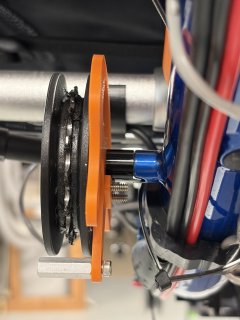

This indicates that offsetting the idler about 10mm farther from the trike centerline will provide a better chain line. But fitting a spacer to increase the offset immediately uncovered a problem that led to multiple prototypes with incremental improvements (Kaizen!). The interference with the steering rod end is shown in the second image.
No problem. I'll profile cut a modified design for the idler bracket out of aluminum. First a 3D printed prototype:
But this part doesn't have to be tremendously strong. Maybe it can be made with ABS plastic if the bending stresses are addressed with ribbing:

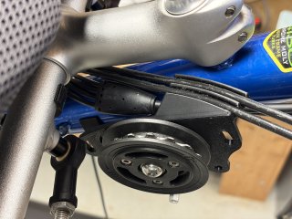

This looks like it will work fine. However, the part ended up going through further iterations to also secure shift cables for a Rohloff IGH. Here is the "final" version. The CYC 1-4 cable can be seen behind the idler mount plate.
