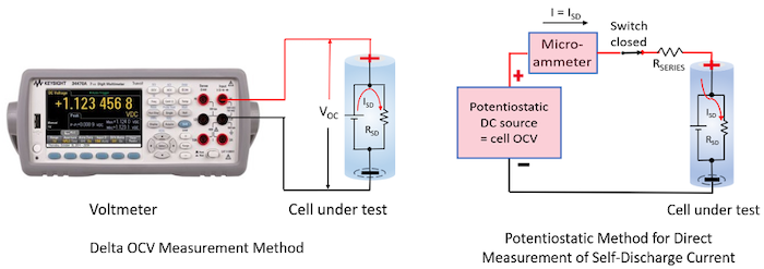

It's really your responsibilty (not the manufacturer) to Pre-TEST your Brand New 18650 cells and decide whether you'd rate them as Grade A or Grade B before building your pack. Hopefully, saving you some future frustration. You'll need to devise your own benchmarks for grading new cells, cells from a used pack or bargain basement salvaged cells. Then sort the cells according to the best use: Raw Performance, Casual Crusing or another application.
It's your call how precise to be (e.g. 0.001V, 0.005v, 0.010v -- A, B, C) depending on the application. Depending on your criteria you may disqualify more cells that you were led to believe were Grade A cells, because 10% of the cells fail according to your pre-test benchmark as not being Grade A According to your demarcation line between A & B.
The following diagrams are from an article on how the Delta OCV (self-discharge) of NEW cells is measured. The unknown is the percent of a manufacturing run that's tested with the objective being zero defect tolerance. Thus how manufactures arrive at what they consider Grade A cells and Grade B cells. Every manufacturer determines what they consider the allowable difference between a Grade A cell and a Grade B cell. Manufactures use the more expensive Potentiostatic Method for grading cells because of its immediacy (within 1-2 hrs) ...
Two methods for determining Delta OCV self-discharge whether new cells, useful pack cells or unknown salvaged bargain basement 18650 cells
This is basically the method that goatman and i are using to test capacity and self-discharge of his 30Q 17s4p and my 30Q 10s3p. Because our cells are not new (many c/d cycles) we decided to rest our packs (equalize cell voltage) for 5 days instead of 10 days because only -0.001mV after 5 days is unlikely with our used (problematic 30Q) cells. Moreso the scenario with my pack then goatman's **regenerated** pack.

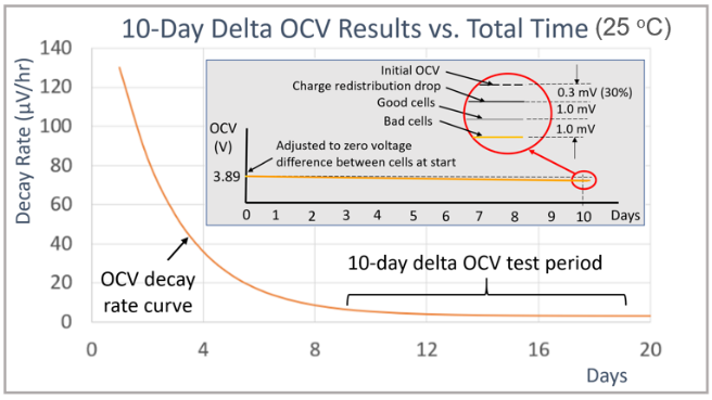

While we decide how best to go about sharing our comparative Delta OCV info (storage capacity & self-discharge) the following article gives an idea how manufaturers go about testing 18650 cells ... https://www.batterytechonline.com/testing-and-safety/measuring-lithium-ion-cell-self-discharge
Only a few have the interest, time and equipment to do justice to PreTesting 68 brand new cells (17s4p) or even just 30 brand new cells (10s3p) to determine they're really “Grade A” before building their DIY spot-welded battery pack. Most just take it for granted that the expensive brand name cells they purchase are "Grade A". What is passed on to a consumer as "Grade A" may be more a matter of the manufacture's opinion than fact.
If only Elon Musk could hold all 18650 cell manufactures to adhere to his benchmark so we can be confidient the "Grade A" cell we buy meets Elon's benchmark for a "Grade A" 18650 cell. Do we actually believe 18650 cell manufactures hold to that 18650 standard of the above article when classifying what cells they pass on to us as “Grade A” ?

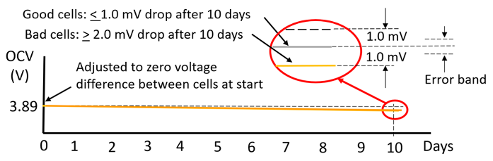

Here's a less sophiscated test, but good enuf whether new 30Q6-T or older 30Q "136" cells. You really won't know how many are good enuf for your application use until you grade them according to your benchmark of what's **acceptable** to you and what's not.
FIRST: Check the resting voltages of all your new or not-so-new 30Q cells. For the sake of this example lets say all are at3.40v. If not them group them as best as possible. You could have as many as 5-10 groups with old cells even though they've never been out of the box.
SECOND: Connect all your 30Q cells in parallel or as many as possible at one time and charge the string/group of paralleled cells to 4.10v (90% capacity) and let them equalize for 5-10 days. The higher the charge the more likely the increase in Delta OCV self-discharge. In the above test the cells were charged 70% (3.90V). This is better from the standpoint that the Delta OCV self-discharge shouldn't be as great. Plus it takes less time to charge :thumb:
THIRD: Separate to individual cells and let them rest (72-75 F) for 10 days.
FOURTH: Measure individual cell voltages for degree of Delta OCV self-discharge. Hopefully most will be "Good Enuf" ... congratulations! "Good Enuf" depends on your own application grading system for what you consider is **acceptable** Delta OCV self-discharge after 10 days. For some (depending on application) their benchmark decline after 10 days shouldn't be more than -2mV for others depending on application -5mV may be acceptable after 10 days (from 4.100v to 4.095v). The benhmark of an ES member who makes custom packs doesn't use any cell that declines more than 7mv. From his experience that usually means at least 3 out of 100 30Qs don't make the grade. So one can only imagine how many wouldn't make the grade using the professional industry benchmark in the above chart.
FIFTH: Establish your own grading benchmark that you consider **acceptable** for your 18650 application.
