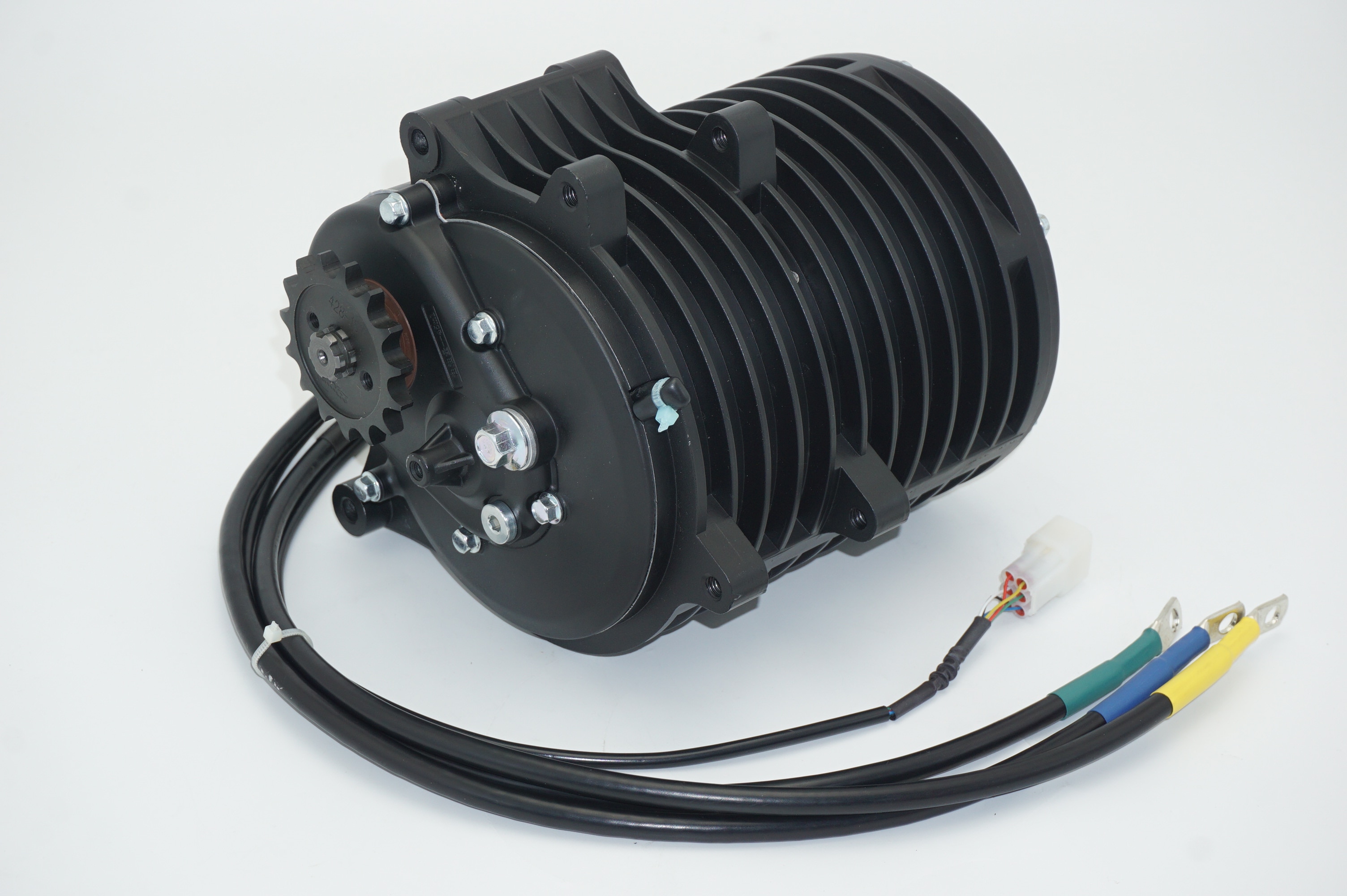

QS 138 70H with Gearbox
Very nice, more info please :wink:
I dont see any splines for the gear, is it shrink on?
I suppose the shaft is custom made and not available to buy?
And the bike, I like the little I can see.
Looks like some nice welding and some interesting looking brackets for the motor.
A build thread would be nice to see :)
That is a great idea, you should sell those! I feel like the 428 chain size is better suited for the e moto setup, and quieter than a 520
I do have some spares if people wanted to do some testing.
No splines, factory is shrink/interference fit. I agree 428 is the go, mostly to avoid huge rear sprockets for me.

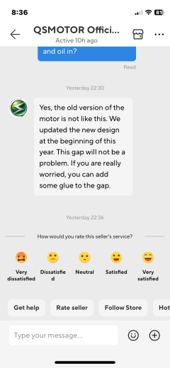

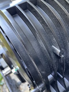

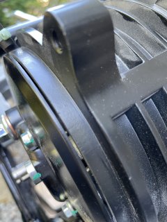

The last one I ordered came without the rubber seal so I go to take it apart and see what needs sealing and the bolts have too little room to use a socket to take them off. Trying to take the bolts off with the other end of the wrench which only grabs two faces is stripping them. Any ideas?
I believe that is v2 of qs 138 70h v3.. v3.2?
Anyway, it seems like there should be an opening there.
my socket fit, just not the wrench I first tried. Please excuse my impatience
It’s the latest qs138 v3 motor with the bigger bearings and smaller wires. I’ll be opening it to see and I thought it would be sealing in the oil for the gears but guess I’m wrong
