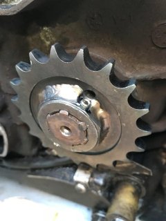

problem is even a "good" fit isn't good enough. it has to be so tight that you have to heat up the sprocket first then tap it in w/ a hammer.
even the smallest amount of movement gets larger the more you use it then pretty soon the shaft is so screwed up that the only way is to weld the sprocket
btw i noticed you have the same qs120 motor based on your sig. how's the shaft holding up?

Elektrosherpa said:
Welded sprocket... hmm.....and what will you do, when the sprocket is worn out?
grind off the 6 little tack welds. should come off w/ a 3-jaw puller. i could probably do this 10 times without screwing up the shaft too much :lol:

interesting... so if all else fails i still got a backup plan. i just need to check if there are 428 type-b sprockets. in your case #420 is the same sprocket as #41 so there's definitely "industrial" type-b sprockets. unfortunately 428 isn't exactly the same as #40
got a pic of your modded shaft?
as for the qs138 v3 w/ gearbox the shaft is a lot thinner so that solution might not work. but if you can make a modded sprocket that'll interface w/ the entire width of the shaft splines then maybe... but then the problem is sprocket retention, that's why i ended up welding my sprocket :lol:
