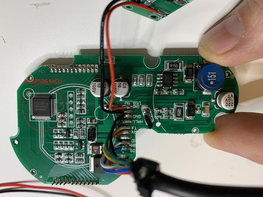

QS-S4 PCB:
The display is using the HR8P506 MCU and my first thought was to dump the firmware, modify it to unlock P8 only when the correct combination of some keypresses (using brake and mode button etc) so if I got pulled over I could just turn the display off and back on again and P8 would be locked. Problem is that this is some China MCU that I find less to no info about and coz of this I started with a different approach.
Does anyone know of a different type of LCD panel using a different MCU like a STM32, PIC controller or atmega etc?
For now I started to look at the communication between the LCD panel and the speed controller (ESC) and my goal is to modify this data and change max speed (P8) only after a USB dongle have been connected to the display's USB port to unlock this setting.
I will share my findings in case anyone else is interested in such.
On the PCB there are some wires coming from the ESC (6 in my case but other LCD panels is using 5) and two of these are marked TX and RX. This is UART using TTL levels set to 8N1 1200bps (serial known as RS232 on PC)
LCD panel is sending a chunk of 15 bytes to the ESC and will then read 15 bytes back from it.
