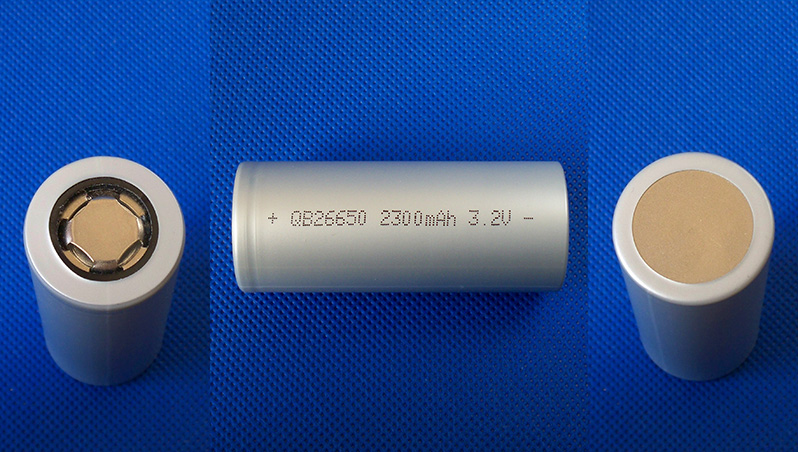

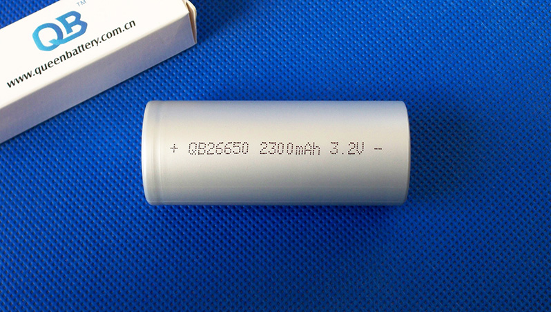

Queen Battery QB26650 2300mAh
This cells looks like the 2500mAh, the only difference is the capacity mentioned on the heat shrink tube which tells us only the model, capacity and nominal voltage.

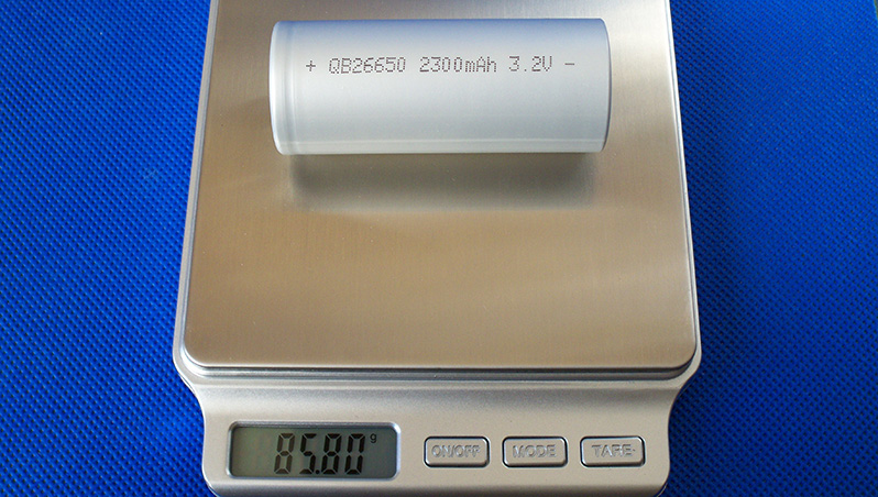

Measured dimensions: 26.7mm (diameter) × 65.2mm (length).
Measured weight: 85.80g.

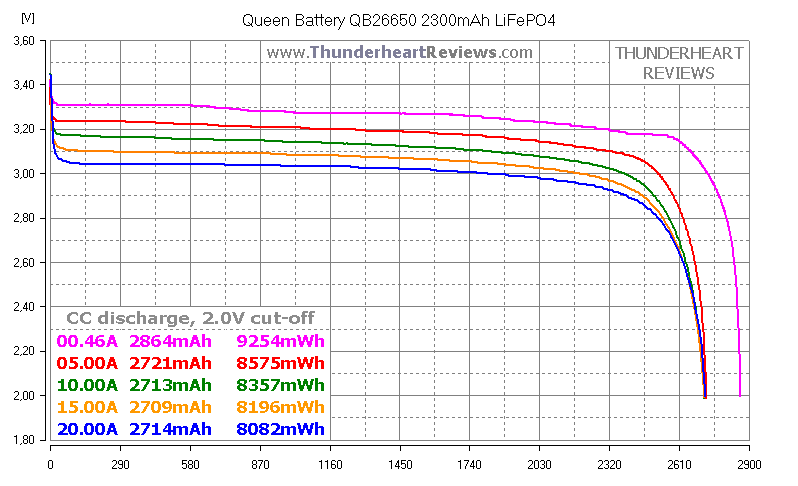

Queen Battery QB26650-2300 capacity test results (I've done each test 5 times).
Just look at those numbers!!! This cell is rated at 2300mAh but it's real capacity is more than 2800mAh - 500mAh or 22% more than declared! I've never seen anything like this before... Even at 20A it doesn't go below 2700mAh! The curves look excellent! This guy stays above 3.0V most of the time! It's not just impressive, it's fantastic!
