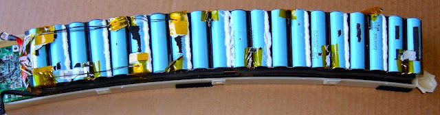

The top tape comes off easily, showing us the batteries.
The battery pack looks somewhat complicated, but it's really not. The black wires along the top are just temperature sensors, and the yellow tape is holding the per-cell sense wires in place.
Battery packs consist of groups of physical cells wired in parallel to form larger cells, and then these larger cells are wired in series to form the full battery. Each cell (of one or more physical cells) has wires going to the BMS so the voltage can be sensed and the pack can be balanced. And, in a good system (such as this one), there are thermal cutoffs that will cut power to/from the pack if it gets too hot.
The thermal sensors are just glued down to the pack and then covered with tape - this seems entirely reasonable as a way to communicate to the BMS that the pack is overheating, though I'd like to see them extend a bit further down the pack. The far end of the pack has no thermal sensors at all.
After removing the thermal sensors (they just pop right off), the next step is to free up the sense wires going from the BMS to each cell. They're in a wide plug, right at the end of the BMS. It was well gooped into place, but once I cleared that out, it popped out cleanly. I'll need this harness when I rebuild the pack.
After getting that connector free and unscrewing the battery pack terminals, the whole pack comes out (slowly). It's secured to the other side of the pack with double sticky tape, but a bit of prying and some patience solves this.

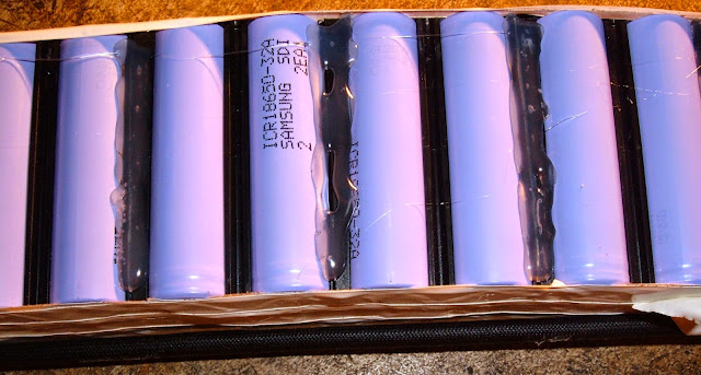

Alright! The actual battery pack is out of it's casing. It's time to tear this one down so I can replace the cells. Copious notes have been taken so I can have a chance of putting it back together right...
The pack is held together by black plastic retainers. The positive and negative terminals go, as expected, to the opposite ends of the pack (so there's nothing goofy like an out-and-back pattern). It's a pretty standard looking pack, other than the slight curve to it.

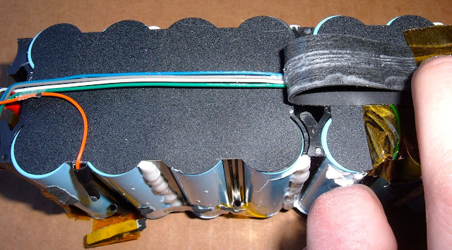

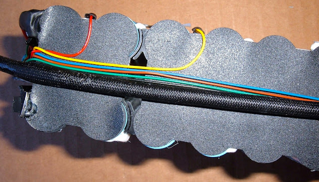

If we take a quick look, there's padding tape down the sides, and the sense wires are protected by more tape. Nothing unusual so far.
This picture shows the sense wires going down the sides of the pack. There's one wire to each voltage region (so for the 10 cells, 11 total wires - yay fencepost errors). They are soldered to the metal plate joining the packs, and are easy enough to remove by snipping the metal sheet.
When rebuilding, it's VERY important that the wires go to the same places. Notes matter here - you can see some of mine in the picture.

Well, now that everything is cleared out of the way, I can find out what's in here.
The pack is a 10S5P pack composed of Samsung ICR18650-20F cells. That's a 2000mah cell, so with 5 per cell, the 10AH rating for the pack is legit. Don't mind the removed insulation - I was checking to see if it had protection circuitry on a per-cell level. It doesn't (which is fine, with a pack BMS).

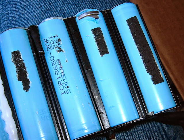

If we flip the pack over and remove insulation on the other side, it's the same type of metal stripping, custom cut for the pack. Nothing fancy to see here. This is a positive terminal and negative terminal joined together (and if you look towards the bottom, you can see the tab where the sense wire was connected - I just snipped them off).
Pulling the interconnect strips off, it was very well attached - you can see the fragments left where the stripping was attached to the cells. That's a sign of good welds.
A little bit of time later, a bunch of welds popped, some connections snipped, and this is what's left of the pack!

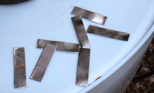

Nickel Strip
The individual 18650 cells are joined together with nickel strip. It's available in a wide range of widths and thicknesses. For this pack, I used 0.2mm thick (same as what was on it), with 10mm wide main strips and 8mm wide crosses through the center cell. This is plenty for the sub-15A the pack provides at peak output.
I ordered a selection on eBay and used what seemed reasonable. I've got some other split-end tabs as well, but didn't have a need to use them (and they didn't really fit the pack in the spacers). It was a bit of a pain to use, but as I didn't feel like getting custom strips machined for me to match the existing ones, I went with them.
