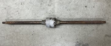

Did someone mention peerless differential ?
New, never used
Surface rust from sitting for a long time.
make offer
so you can estimate shipping to your location
97415 Brooking Oregon
box size 4" X 4" X 40"
15 pounds

That style is called a "dominate drive" or "Detroit locker"
It functions almost like a limited slip differential but not quite the same.
In a turn the inside wheel ratchets the freewheel and the outside wheel "dominates" the turn radius which adds a slight load on the drive system.
On a pedal bike you can feel the load on the pedals.
With a motor the increase in amp draw would be seen on a gauge.
It is low cost to build and works very well in sand or snow.
I've made a couple dozen using 16T ratchets for these quads.
And have since figured out I could have saved a bunch of machining time by using this type ratchet instead :

Thanks for the 'lightbulb moment' PapaSteve, I am assuming you used two of the four bolt freewheels to bolt to/through the centre shell of your diff instead of using a standard freewheel and machining all the relief cuts to capture the freewheel teeth. I didn't get what you were alluding to with the pic at first, but now it makes perfect sense. I have bought adapters/parts from ESP.com but only thought of those flanged freewheels to eliminate motor drag when coasting. Thank you again.
Center shell I was making started with a short length of schedule 80 aluminum pipe machined for a 16T freewheel.
Years later, when having the "lightbulb moment" after seeing these bolt on freewheels is to use common standoffs between the freewheels instead of the machined center shell.
Drive sprockets on the electric scooter parts site should round out the project.
Whereas, I made the drive sprocket for the quads.
link to standoffs
