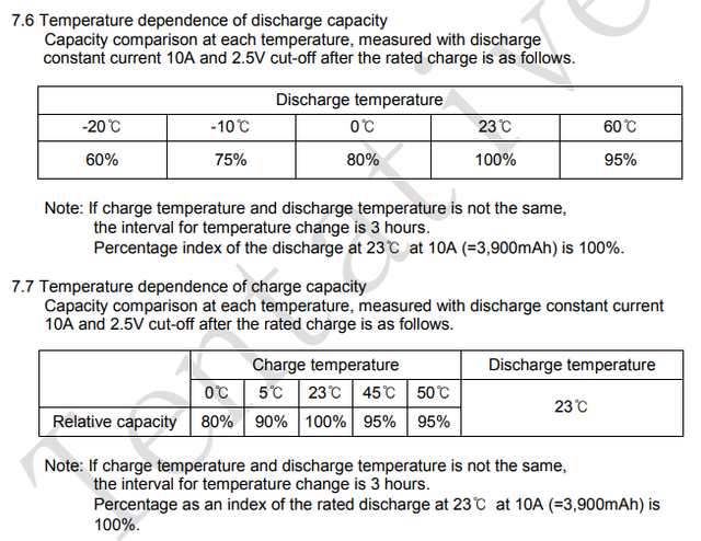

Hi guys,
so, I was running through the Samsung 40T datasheet and got stuck in the discharge temperature sections. I could not understand much of it. Does the 40T need to be discharged in only 23 ºC? What's the temperature influence during the discharge? Sorry for asking, I'm brazilian and still learning english.
Thank you very much!!
