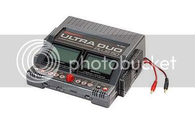

It would be interesting to try removing the BMS from these Lifep04 packs, and charging using a modern balance charger. The EOS 1210i can charge up to 12s any Lifepo4/a123 battery at up to 180w max and the EOS 0610i duo up to 360w total, balancing cell voltages to .002v at the end of each charge. The new Graupner Duo Ultra Plus 50 can do 14s LiFepo4 at 360w, so we could connect two 7s packs in parallel on each side (inc balancing taps) so we are effectively balance charging anything up to a 28s pack, thats how I charge my lipo packs.
I agree. I see no reason to keep the BMS on LiFe. As long as they are used within specs they won't even need but an occasional balance. I balance my packs every 10th charge, and check the cell voltages after every few runs to be sure they are still in balance. So far so good, but I am also running 20C cells at less than 10C peak and 2-4C average. This is certainly possible on any EV, as capacity takes precedence over discharge rate since we need long runtimes.
