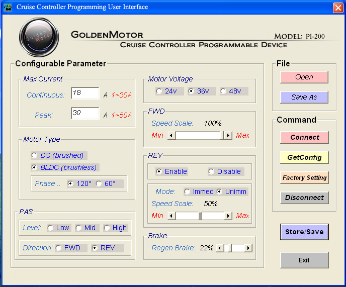

We programmed the Smart Pie with the software you can download on the Golden Motor website. Here is an image of that interface. Our settings are NOT the same as those on the picture.
Our settings:
- Max Current Continuous 12 A
- Max Current Peak 15 A
- Motor type – BLDC (brushless) 120 degr.
- PAS high
- Motor Voltage 36 V
- FWD speed 100%
- REV disabled
- Regenerative Brake 116% (maximum)
The PAS sensor did not fit properly so the PAS does not work at this moment. But the Smart Pie came with a thump throttle so we could ride the bike.
