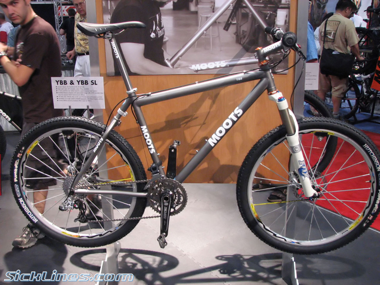

john7700 said:
There were several Titanium bikes that used this design. I would love to convert a Moots YBB. Lots
of triangle space and really, ...
My thinking too. The full suspension takes up too much room in the triangle.
What's the maximum travel with this design? 0.5in, 1.0in?
What's the maximum travel with this design? 0.5in, 1.0in?[/quote]
The KHS is between 3/4 and 1" according to their website. I think I might add a suspension seatpost to my setup for a bit of extra cush.
