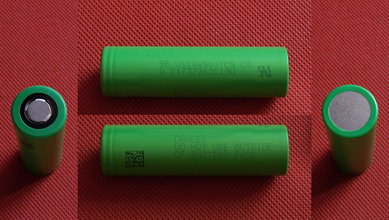

SONY US18650VTC5
The heat shrink tube carries the following marking: SE US18650VTC5 C5 G 0173736ZC19U which tells that the cell was manufactured on 19 March 2017 by Sony Electronics (Singapore).

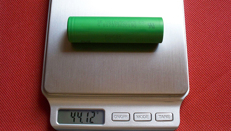

Measured dimensions: 18.2mm (diameter) × 65.0mm (length).
Measured weight: 44.12g.

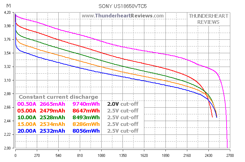

Sony US18650VTC5 capacity test results:
First of all, look at the discharge cut-off voltage at 0.2C - it's 2.0V because Sony uses it for rating its cell. At all other discharge rates 2.5V was used by Sony and by me too. I don't understand why Sony does that because the capacity carried between 2.5V and 2.0V is miserable - just look at the violet curve.
Whatever, let's pass to the results. At 0.2C or 0.5A using 2.0V discharge cut-off VTC5 showed 2665mAh - a very expected good result. At all other discharge rates, as i told, 2.5V cut-off was used. At 5A discharge the capacity was slightly below 2500mAh but at 10, 15 and 20A it was above it. The curves look good, almost linear.
