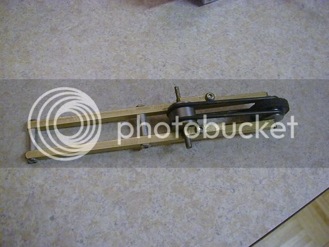

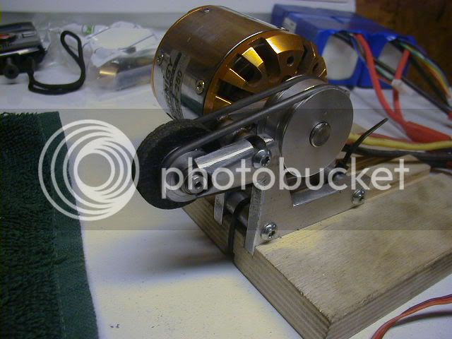

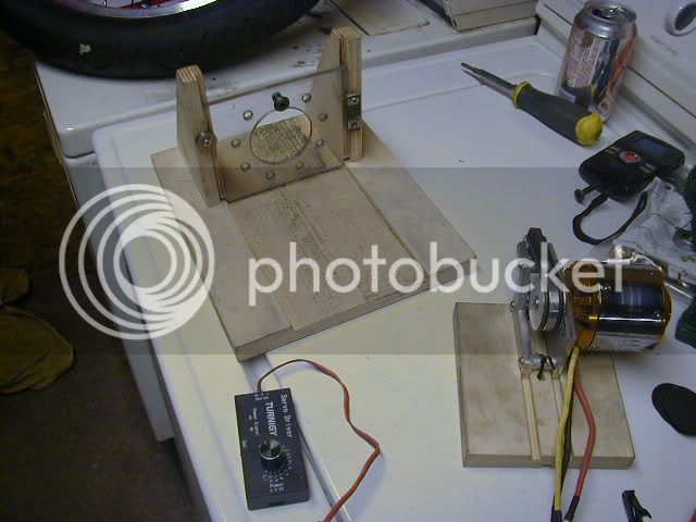

& some stills of the tool & the parts:
version 1 almost worked...
version 4 after working out all the kinks:

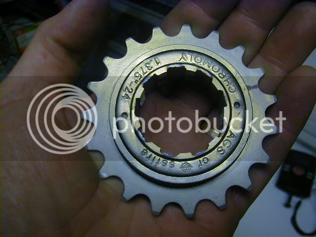

And the end results:
