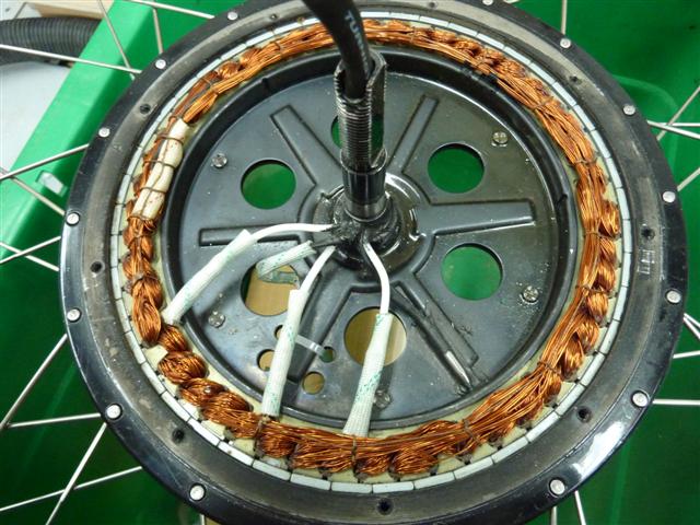

A good question to be sure. :)
The problem with a stepper motor is that there will be a tremendous amount of freewheel drag; you will always have to have power to allow the wheel to overcome the massive holding power of the magnets.
I am sure there are other viable reasons though I should think it is the primary reason.
The opposite analog of a stepper motor would be an ironless axial flux motor where there is very little measurable freewheel drag.
~KF
