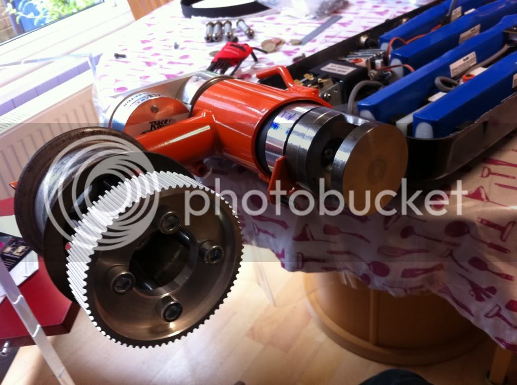

Did some work on suspension system today. Only roughing out a few sizes. Need to make bearing cups. The the race needs to be bigger than the inside of the square to allow the poly to be pressed in. It is 70mm. I have gone for 50mm ID 80mm OD tapered rollers. This way the race clears the square. I have machined a blank for one side with 70mm bore, got to machine a blank for the other side, when the bearings arrive I will machine the recess for the race.
Few pictures of my progress taken, but I will have to wait untill I am home to upload them. Pretty happy with the progress. I'm not very good with designing things. Do not have a computer graphics package, so I work from little notes and scraps. Often have to start making something to get an idea of where I am going, is certainly the case with this, am pretty happy with how its going though. Definatly think this is achievable.
Found out that this is also known as an indespension unit, used on trailers etc.

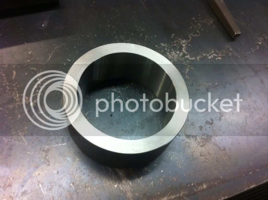

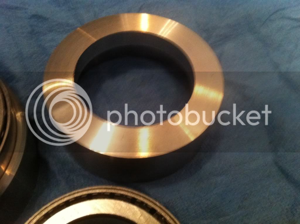

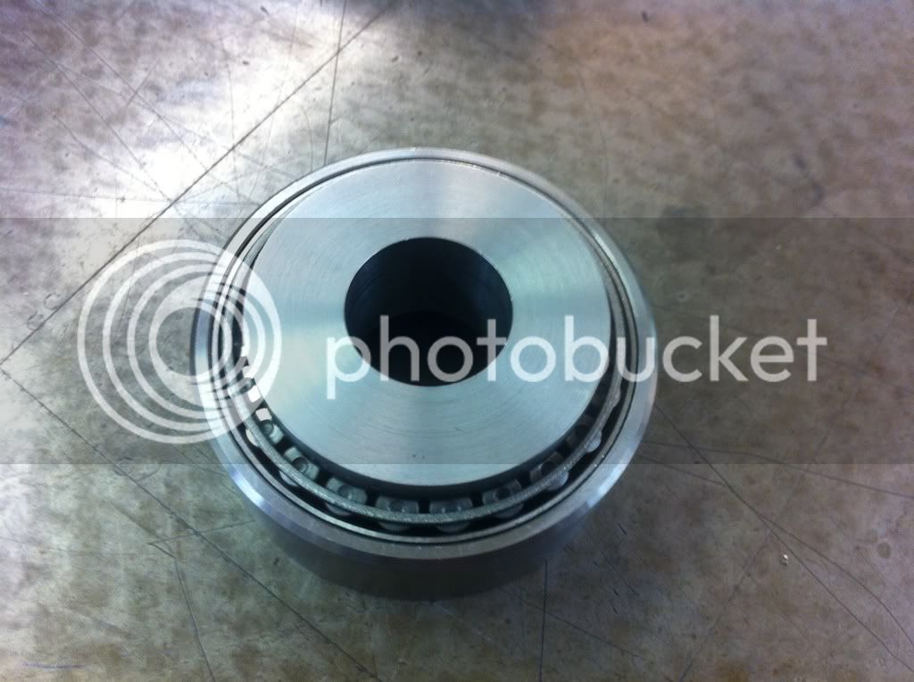

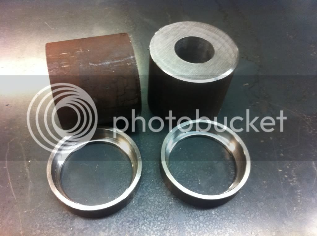

bearing cups blank looks huge. Thats because it is, I left it over sized until I finished machine. Should only be about 25mm... Is more like 40mm at the moment.

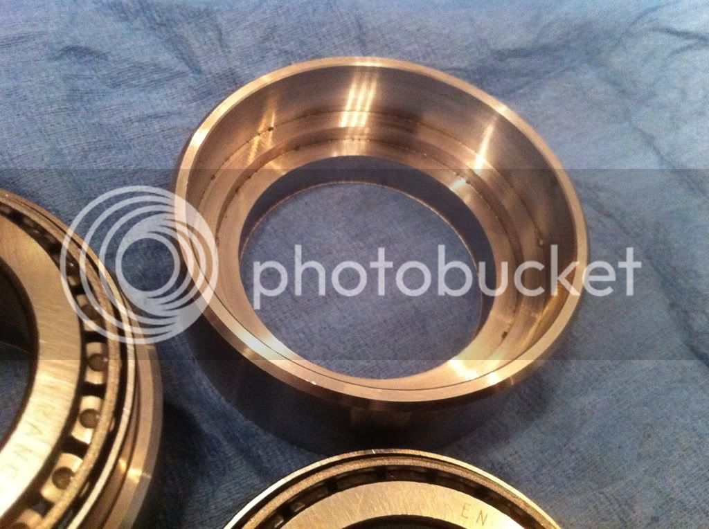

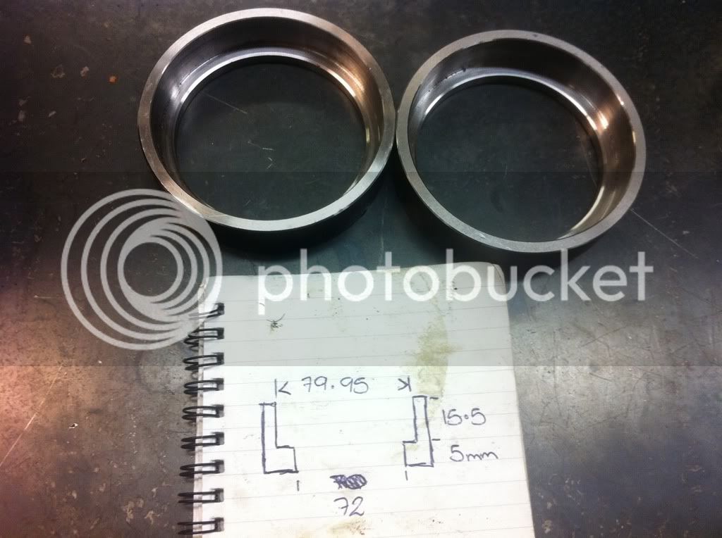

Feeling settled on a design, I looked up the dimension of the bearings I ordered and made both bearings cups today.

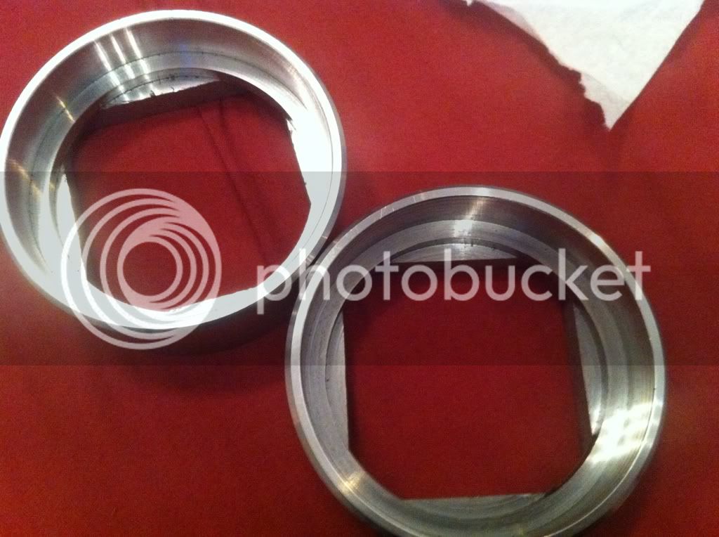

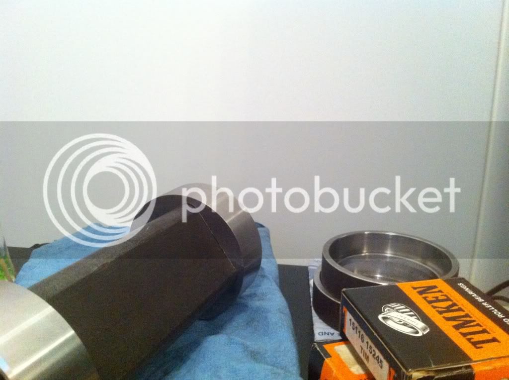

Grabbed two fresh lumps of 90mm stock and drilled 40mm clearance hole in both. Will work on them tomorrow. Bearings cups will be machine on lathe first, with three steps bored in. The extra steps is 60mm the size of the square stock. This should make the milling a lot quicker boring out the centre first. Hopefully should be able to get the two blanks ready for milling tomorrow, not sure if the actual milling will get done.
Few pictures below.

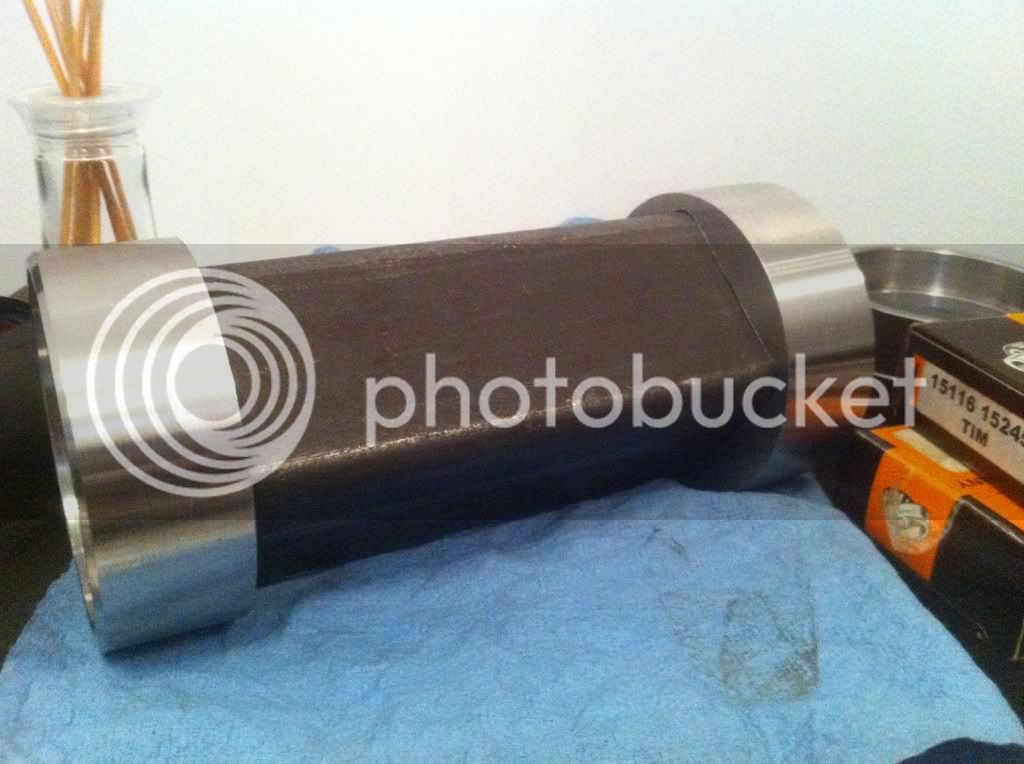

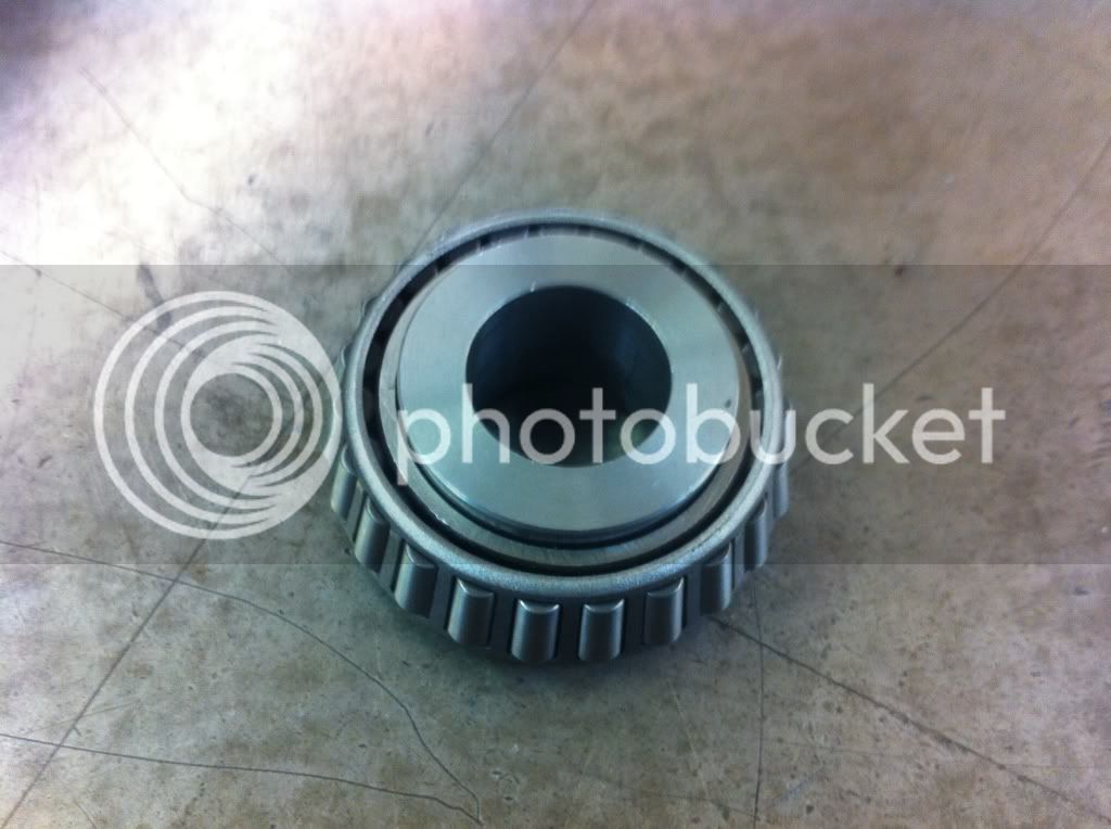

Finished the bearings blanks today ready for milling. Won't be able to do any machining over the weekend. This design certainly will be far stronger and look much better too. The last 10mm step of the bearing cup I bored to 60mm. Only have to open it up on the mill with a tool the same radius as what is on the box section.

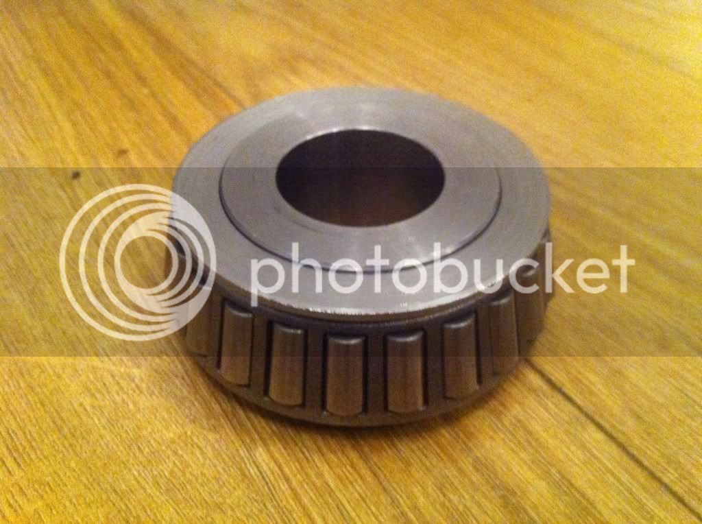

The bearings arrived today as well. They look huge, I only got them this big because with the races pressed in, it gives my full access to the square which is 70mm. Shouldn't get any problems with them, pretty over engineered. I prefer to be safe rather than sorry.

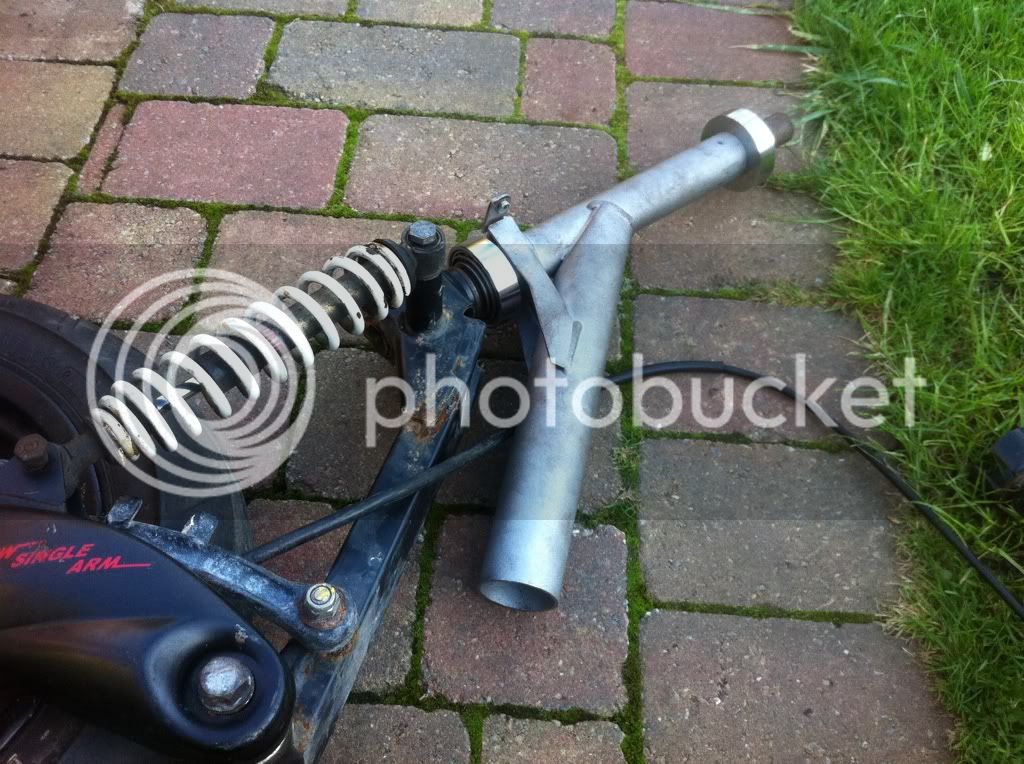

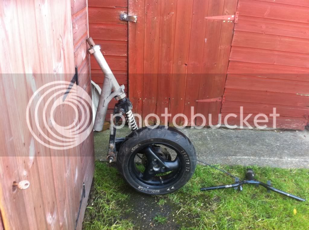

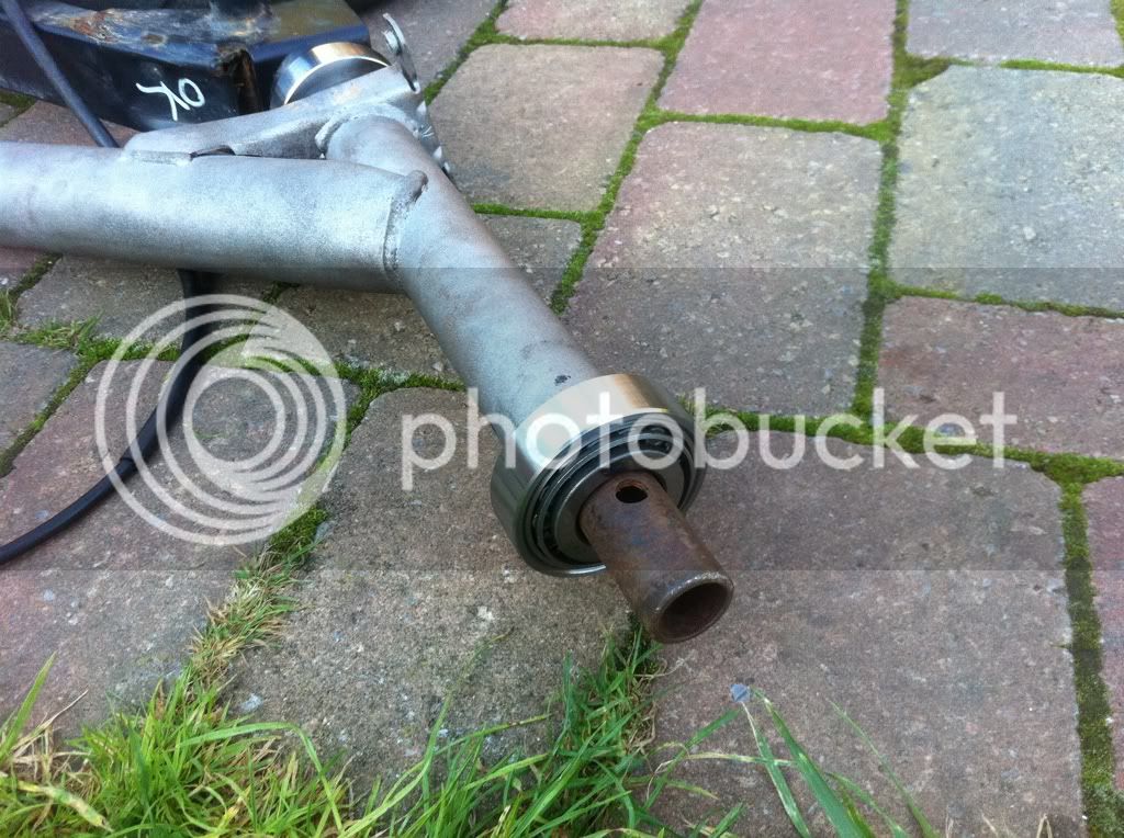

offered up the headstock with the stem to see how it looks. It is quite a bit higher then it was originally. At least the length of the bearings cup. I could not fit the stem in the lathe to skim the step off, So I made a paralleled step to press on, it's not on yet. I am thinking of grinding the welds off, machining it.. The get it welded again. Think I will have to make a jig to ensure it goes back the same.
I need to get the bearing cup as close as possible though. Will need to cut some of the tube down anyway.

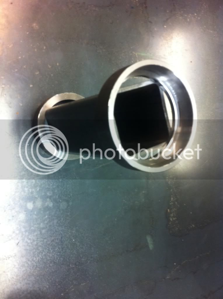

Finally got the bearings cups finished for the CIDLI today. Which was handy as this is the day I had set out to see the guy who is going to weld this for me. I am seeing a custom harley fabricator, who makes all sorts of big bike frames from scratch. So I am getting him to sort the frame welded to the original section I have and then a bend and then weld to the CIDLI knuckle.

Got my callipers back from the powder coaters, and rebuilt them.

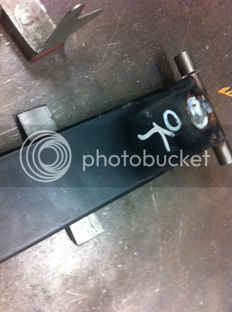

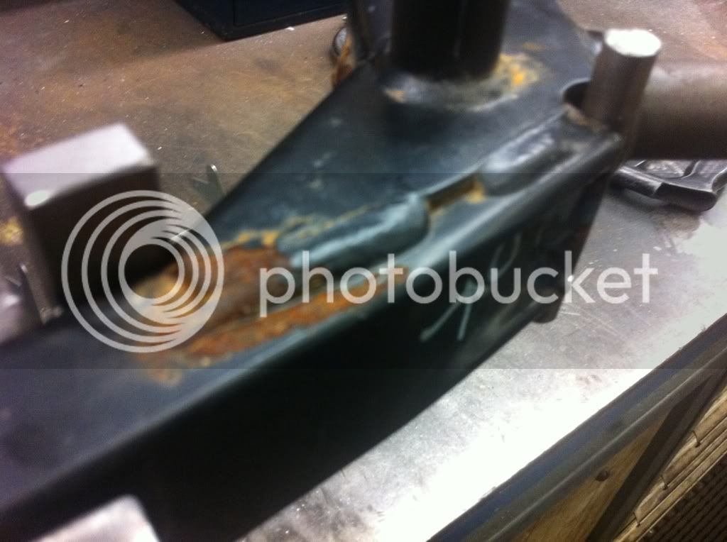

Cut my front suspension in half. Needed to cut it down to fit in the lathe to skim the old bearing step off. Two blocks where welded on to position it when it goes back.
Few pictures of where I am at.
Got the front suspension parts welded back together today, they where welded all across the joint instead of the two slugs that where on there before. This should make it a little stronger. Also made a good start on the shaft for the suspension.

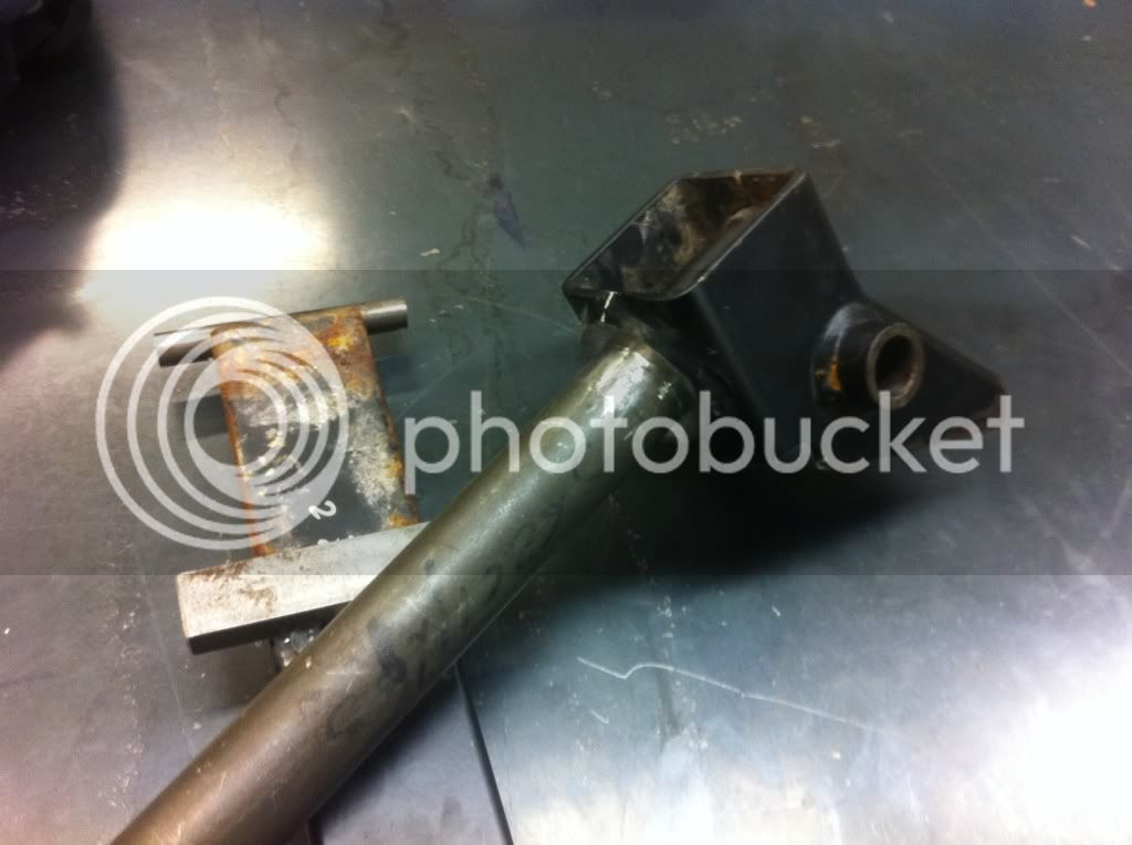

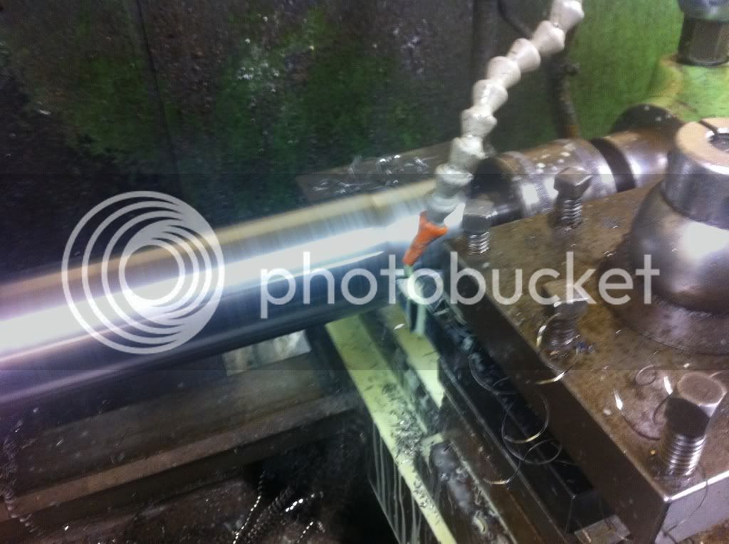

The shaft is about 350 long at the moment, the first section on the larger end is for the swing arm to be welded too. As I am not fabricating the swing arm I have left this oversized at 100mm long so the custom builder can tell me how he wants it.

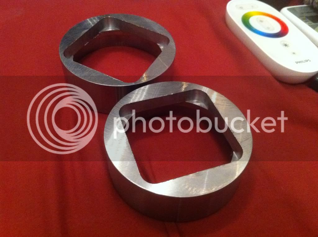

Managed to get two of the sides milled, but ran out of time. Will finish the square tomorrow; this is the part which will drive the inner square on the suspension.

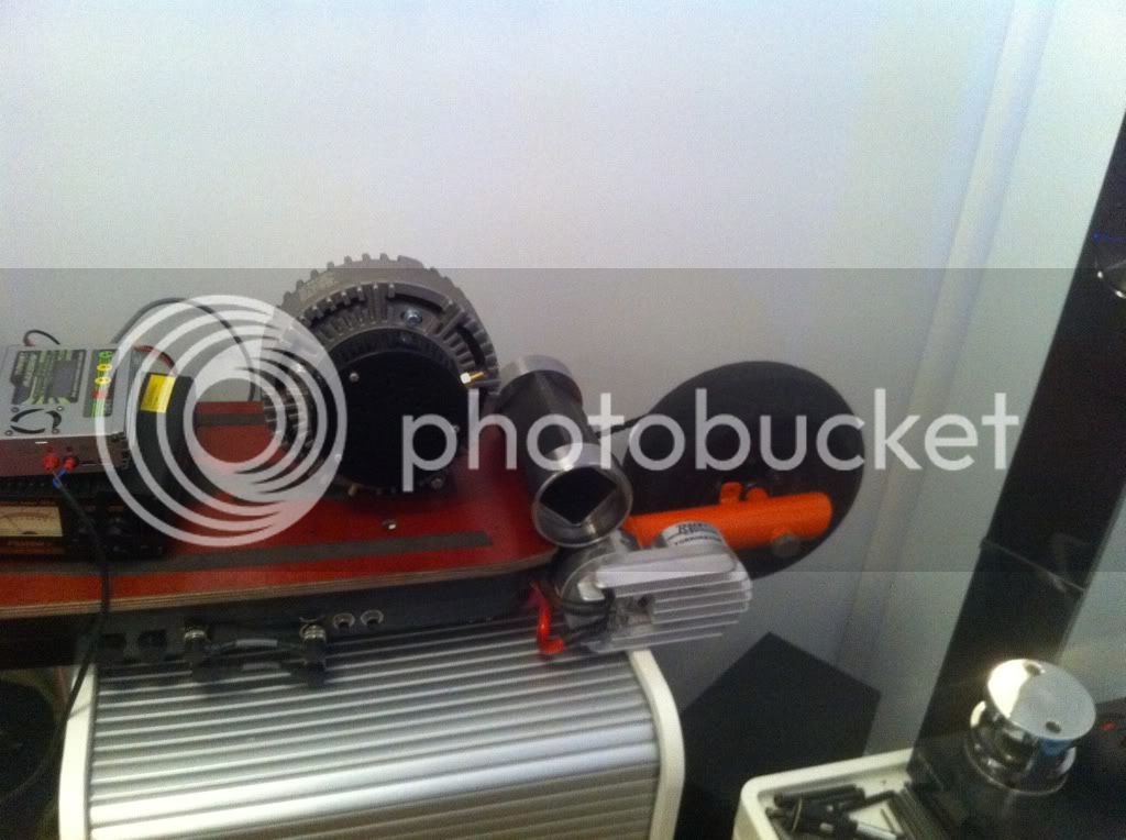

I have a Speedfight 2!!!! the wheel is pretty heavy but pretty satisfyling to navigate in the dust and fields with... I ended up taking some wrong turns on mine, going down a ravine and having to go up again, juddering through corn fields that were felt like a rodeo ride, and getting lost in some wet muddy woods that i thought were 1 km wide but in fact were about 10 kilometers... it has very good handling.
But WHAT is this thing? with the rubber? the back axle goes through the square area? a kind of schematic sketch on paper would have helped me figure out what is happening at the back of that scooter!

Thanks for checking zzoing. Not really sure of the suspension travel on the rear wheel at the moment, the longer the swing arm the greater the travel. Thee inner square pivots just under 45 degrees before it spins out, so the maximum travel ideal would be about 30 degrees. I am still fine tuning the fill material, it will work but I am not happy with it at the moment.
It is very similar to trailer suspension known as Indespension. I chose this sort of system as the point of compression is around the pivot point; surely the most compact system possible. A spring with a damper would of been better, but this thing is more of a toy and I want it too look right. With a spring above the rear wheel will take away from the look of the stand-up.

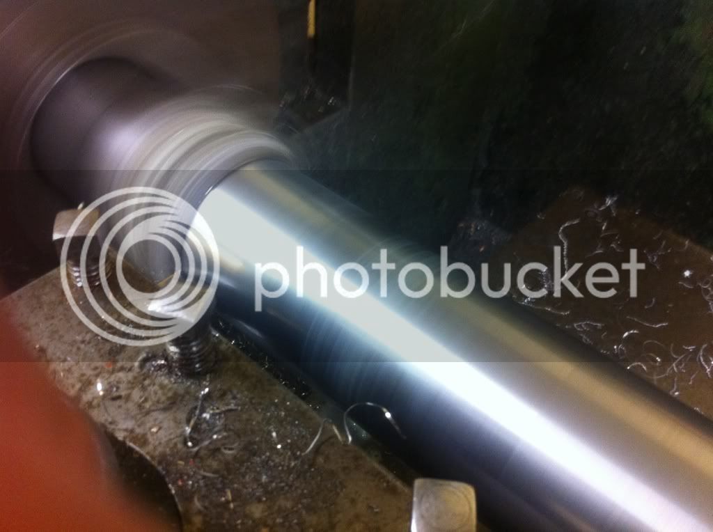

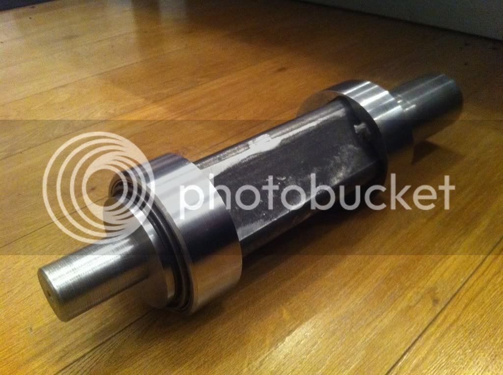

Finished the shaft, or everything but the 30mm thread on the end. Don't have a 30mm die, and my lathe tool is too small to machine a thread that size. Have to think of something. Don't really want to reduce the end of the shaft any more as this will weaken it. If this things going 60mph, I cant take the risks.
Had to file down the inner seam of the box section, this took forever. I hate filing. The shaft is a nice tight fit in the box section, so seam had to be completely filed flat. Made the bearing bush to go over the 30mm end of the shaft and pressed the bearing into it already to ensure the press fit was good.

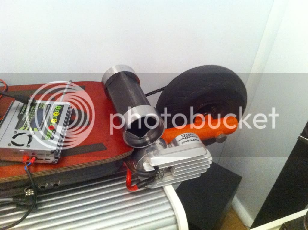

Made up a sacrificial shaft to align the bearing cups. They are only tacked at the moment. Also made up a couple stepped washer to keep the polyurethane from compressing out of the square and into the bearings.
Suspension is starting to take shape now, although I have yet to press the bearing onto the swing arm side of the shaft which I left oversized for the custom builder, the reason for this is because I may need to use the bearing section of the shaft to hold the shaft in the chuck to reduce the swing arm section. This is of course once I have spoken to custom builder. Few pictures below.
