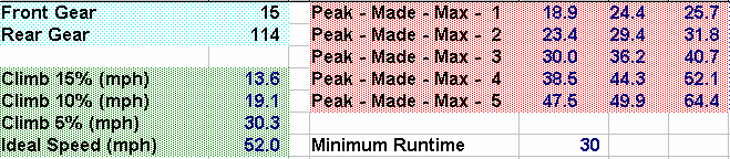

I've recently "discovered" the value of the SRAM Spectro P5 and I'm wondering if anyone has experience with it because I'm thinking of buying one.
http://aebike.com/page.cfm?PageID=30&action=details&sku=HU2507
:arrow: SRAM Spectro P5 5spd drum brake hub $131.99
The gears seem to be "perfectly spaced" and since the first and second gears are at a lower ratio it makes high rpm electric motors easier to get geared correctly. This seems like about the "ideal" number of gears for my 1200 Watt project. (except a disk brake version would be better over the drum brake) The gear ratios have a range of 303% which is equal to the 8-Speed of the Sturmer Archer, so you cover the same range, but have wider gear spacing. The gear ratios are:
0.63
0.78
1.00
1.28
1.58

96% efficiency is basically the same as no gears at all... just a direct drive chain. So in the "extreme" high and low gears you lose as much as 8% over not having gears. That's a lot worse than the Rohloff which is supposed to be in the high 90's for most all of their gears. Given that NOT having gears is impractical for small motored bikes (for a variety of reasons already mentioned in the"Great Debate") it again comes down to price. If you want the "ideal" hub you go with the Rohloff and spend a thousand dollars. If you are using something like a 1200 Watt Unite motor that is already not the most efficient thing in the world then you are more focused on "extremes" like top speed or steepest hill that you can get up. You sometimes (for price reasons) have to settle for less than the "Best" hub motor.
If one's goal is to have the longest range then you cruise along at under 20 mph with a small and efficient brushless hub motor. But if you want a "thrill" when you ride and you want to get to 50 mph with a little (2hp) motor but don't want to pay very much then you get the SRAM 5-speed and the 1200 Watt Unite motor. At least that's how I'm seeing it right now.

With the SRAM Spectro P5 I can run a gear like 15 - 114 for the drivetrain and that allows me to run at ONLY 40 amps to achive the 50 mph number. With the Sturmey Archer the gearing is so tall that even with a 12 - 114 gearing I have to run 60 amps to "cover" the full range from steep hills to 50 mph.
:arrow: So I end up getting a 43% improvement in range AUTOMATICALLY when I switch hubs because of this issue of high rpms in the motor. It goes from 20 minutes (min) runtime and 18 mile (min) range to 30 minutes (min) runtime and 26 mile (min) range.
Also, as an added bonus the lower amps mean less torque and even with the "harshness" of PWM the torque never rises above 70 Nm. That's actually very conservative and means the hub will never break based on power alone. (more likely it would break from trying to "speed shift" too many times)
