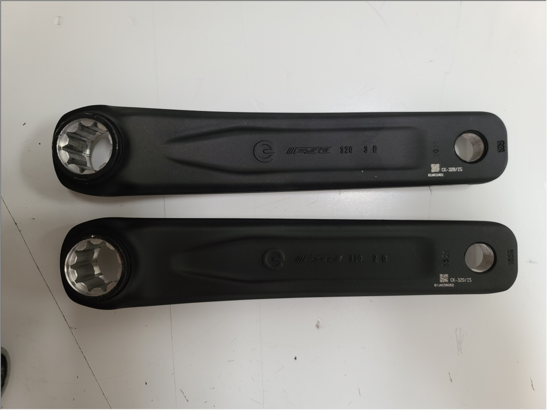

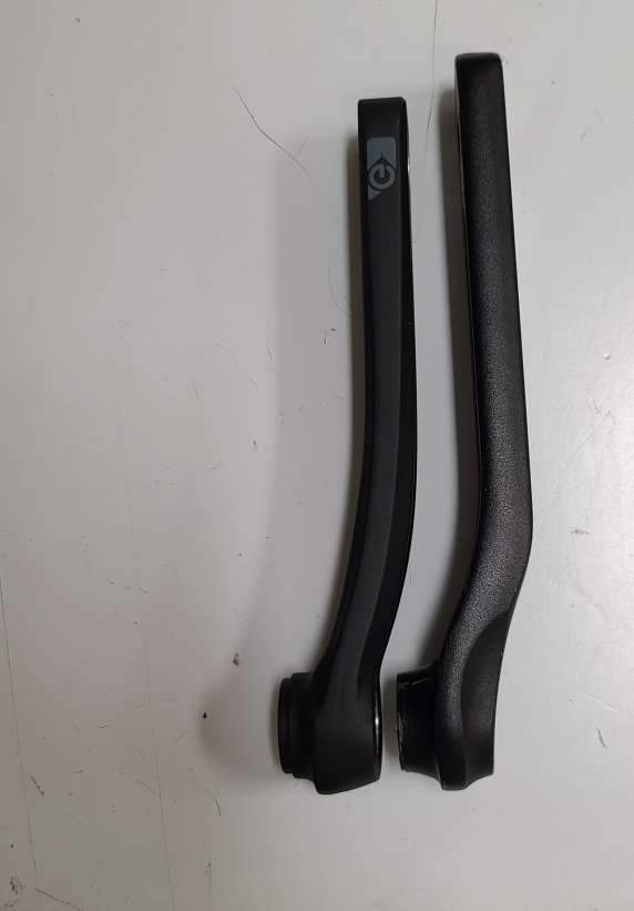

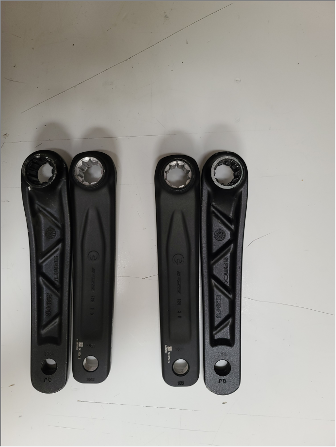

Like some other folks, I had issues with the stock cranks on my HT1000. The non-drive side was essentially stripping out and would loosen, and I'd have to tighten it. It got bad enough that it was happening every 5 miles or so on a ride I was on, so I went looking for a replacement.
I wasn't looking for something particularly strong or lightweight. Cost was a factor.
After looking through online measurements and diagrams and making some guesses, I settled on the FSA CK-320/IS in 165mm, aka "Yamaha PW-X E-bike Armset", p/n 324-0046002260. $42 shipped to my door from FSA Pro Shop.

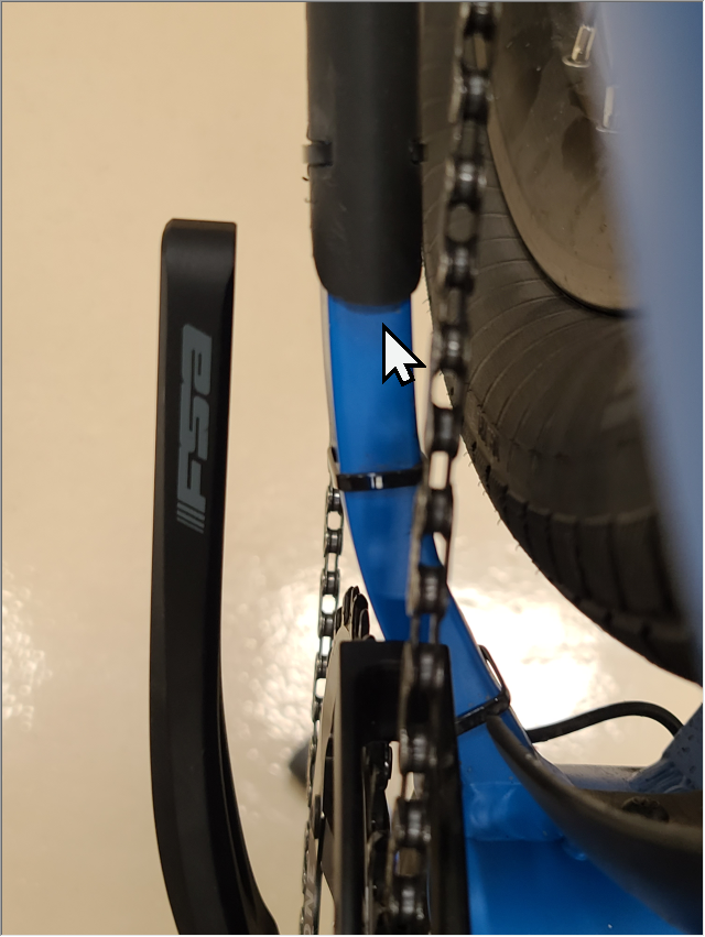

Fit is good overall, close to stock. I suspect they sit a smidge further outboard than stock, surely no one's preference but it doesn't matter much in my case as I'm anything but an efficient rider. Plenty of clearance obviously. I haven't put a many miles on them, just a couple test spins, but I am sure they'll be an improvement over what came on the bike originally.
Just wanted to make a note of it in case others are still looking for ideas to this issue.
