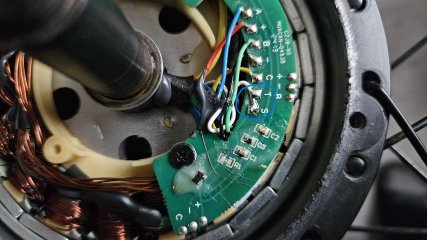

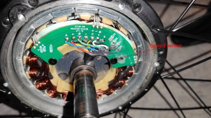

Hello everyone.
I bought a new Kunteng KT36/48 SVPR (36V/20A) controller with a KT-LCD5 display. Everything works fine, but the display only shows the speed when the motor is running. When driving without the help of the motor, the speed value drops to zero. Then the distance and time measurement also stop. Do you know how to set the parameters so that the speed works even when idling?
The original controller only had 5 LEDs, so I didn't have a speed indicator before.

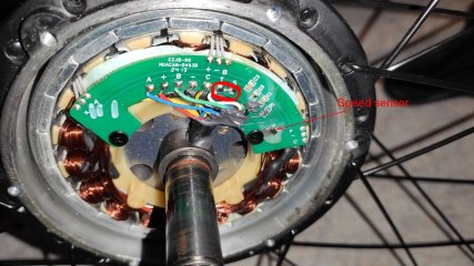

I have a 36V/250W geared motor in the rear wheel with the CZJB26" marking and a 9-pin round connector. It seems that the motor has a speed sensor with one magnet on the motor flange. Therefore, I set the parameter P2 (Setting the wheel speed pulse signal) to 1. However, with this setting, the display never shows the speed. Even with the motor active. The allowed values for this parameter are from 0 to 6. By successively entering these numbers, I found that the display only works with the value 0. And only with the motor active. If the motor is not rotating, the display drops to zero. I am attaching a photo of the motor with the speed sensor and the flange with the magnet. The white wire goes to the shorted T-S contacts. I would also like to remind you that the parameter P1 (Setting the motor characteristics parameters) is set to 94 so that the display shows the correct speed.
I also don't like the motor's delay after I start pedaling. I was used to the motor responding after less than half a turn of the cranks and now it's more than double that. Which parameter adjusts this?
Thanks in advance for any advice.

C1 set to 0 would provide the fastest PAS response.
Do you have a link to the controller, and a pic of the controllers motor connector with the pins visible?
This means that it is not reading the speed sensor, it is only using a motor hall for speed sensing.
that can be a hardware issue, such as a wire for speed sensor not being in the controllr-to-motor cable, a connection fault at that connector, or the controller not being a version capable of using anything but a DD hubmotor to read speed information without motor operating.
a geared hub like yours doesn't output any motoro hall signals unless the motor itself is spinning inside teh case, which only happesn if the wheel is rotated backwards without power, or if power is used to rotate the wheel forwards.
a dd hub outputs motor hall signals whenever it si rotated in any direction under power or not.
T-S means temperature - speed, as a numberr of motors combine a temperature and sp3eed signal on one wire ina a"clever' way that not all controllers can read. some motors have both pads but only hook that wire to one function or the other, so they can work with those controllers.
if your motor has no temperature sensor then it isn't interfereing. if it does, it might be, and you could make sure the wire only contacts the S pad.
But there may be settings in the display depending on your specific version of display and controller and firmwrae on each that lets you switch from wheelspeed sensor to motoro hall sensor and viceversa, and to set the number of poles for each (much higher for halls in a geared hub vs the single magnet pole your wheelspeed sensor has.
this post may be relevant

It works, thanks. If the parameter C1=0, the engine starts faster. Between 1/2-3/4 turns of the crank. I was used to an even faster response from the previous controller. But there was a 12 magnet PAS. Now I have a 6 magnet (it was packaged with the new controller). Since the old one had a different connector, I put this new one in there. Shouldn't I try to replace it with the original 12 magnet (I would have to change the connector)?
I'll try disconnecting the jumper between T-S and leaving only S (speed) connected.
Edit:
I removed the T-S jumper, connected the white wire only to the S contact. I set the P2 value to 1. And the speed works perfectly. I am attaching photos before and after the modification. Thank you all.
