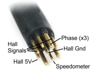

Can you post a pic of the motor’s connector with the pins clearly visible?

Thanks. A geared hub motor requires an internal speed sensor in order to provide a speed signal to the controller. The signal is provided by a sixth conductor, usually white. If the above represents the motor connector from the motor, and not the controller side connector, then it’s pretty unusual to be missing the additional conductor. Without the separate signal, the controller will use a hall signal for speed, but won’t register when coasting.

Sorry, I have given you incorrect info. The above pic I copied from the UKC1 user manual. The motor has a 9 pin male connector. The controller has a 9 pin femail connector for the motor and a 9 pin connector for the display, on/off, brakes and throttle.

It's odd that the controller appears to be taking the speed reading from the internal motor speed sensor when powered, but drops the speed reading when coasting. I would check the motor speed sensor manually, using a multimeter, a 5V source and the 10k resistor. With the motor disconnected, applying 5V (in series with the 10k resistor) and ground, and measuring the voltage between ground and the speed output, while rotating the motor, you should see the signal alternating between 5V and 0V. If it does, the motor speed sensor is functioning properly, and eliminates that as a potential cause as being the speed sensor itself. It would also indicate that the controller is using the hall sensor input for speed when coasting for some reason since the displayed speed is dropping to zero.
