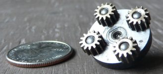

The BaneBots gearmotors are lubricated with what looks like a cheap lithium grease. I've since upgraded to some "extreme pressure Molly-Lithium grease" I have laying around. The Molybdenum disulfide content of this grease improves efficiency and should make the gears last longer.
Gear noise isn't a big issue anymore, and listening to the gearbox gives me an idea of how much torque the motor is putting out.

Third, I thought I'd post a picture of the gears I'm sending 100-150 watts through. It's the second picture below. They're puny and brass, yes that's a quarter to the left.
