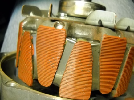

The plot thickens....... I got a "bigger hammer" and "convinced" the taper bushing to pop out- I'm glad I didn't have to destroy it to remove it! I don't think I'll want to use it, but if I decide to at least it still exists. Now, for the real business:
Woah, what's going on here? 8 pole pairs instead of 6, and again, what? That's little ferrite magnets snuck in between the claw fingers! Kind of like was discussed over here http://endless-sphere.com/forums/viewtopic.php?f=30&t=16328#p240248 I won't say I know exactly what's going on here, but the more differences I see in this than the usual alternator, the better- because I presume any changes they made are for the purpose of making it a more efficient and power capable motor/generator.
Comparing a standard Delco alternator to the BAS alternator, stator and rotor:
So, the upshot- knowing it's 8 pole pairs means I know the aformentioned austriamicrosystems chip won't work, but the CUI encoder might still be an option. Seeing the way the pulley mounted means I can design an adapter to mount a sprocket.

The magnets wedged between the fingers is also very interesting. Presumably this will reduce the amount of wasted power in the field coil.

A little more investigation of the permanent magnets reveals that they are magnetized across the narrow face between the claw teeth- so that they magnetize the claw teeth alternating N/S- so like Fetcher speculated they're just sort of providing a (relatively) moderate magnetism to the claws with no field current- should cut the field current requirement a bit. Also means I'll have to take care to drive the field coil with the correct polarity to match the permanent magnets! I wonder if it was also conceived as a safety feature for rotor coil failure, which causes the back EMF to disappear- which could cause trouble for the attached inverter... although if the inverter is built right with good current limiting it shouldn't cause it to blow up.

I'm not particularly impressed with the copper fill or end-turns- the windings look really similar to the standard alternator- as far as I can see. It does have many more stator teeth, though, and much thinner laminations. People seem to say good things about the Denso SR style, with square wire single file in super narrow slots- very much like the Remy HVH winding style
