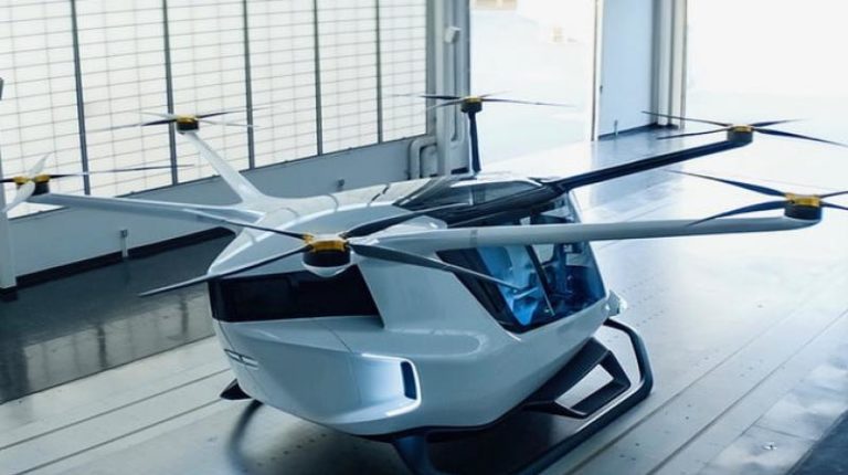

Thought I would post this here to help drill through Elon's incredible persuasion power and just how much more energy to weight ratio there is on hydrogen fuel cells, like I say in my signature, fuel-cell is the ultimate battery.
Here is announcement launch for a 4hour flight time, safe electric vertical takeoff and landing (eVTOL) vehicle, or "electric flying car" if you prefer.
https://fuelcellsworks.com/news/alakai-technologies-launches-worlds-first-hydrogen-powered-air-mobility-system/
https://www.zdnet.com/article/hydrogen-powered-air-taxi-yup-its-real/
https://www.reuters.com/article/us-usa-hydrogen-aircraft/hydrogen-powered-flying-vehicle-touted-as-southern-california-traffic-tonic-idUSKCN1T0078
https://www.thestreet.com/video/worlds-first-hydrogen-powered-flying-car-skai-video-14977875
http://skai.co/
https://www.msn.com/en-au/news/techandscience/hydrogen-powered-flying-vehicle-touted-as-southern-california-traffic-tonic/ar-AACa12C#image=8

Actually, that is a scam vehicle.
No configuration of 6 props passes the bird strike test requirements to fly human passengers.
Thats a movie prop made to lure VC cash.

Cool concept! Perhaps they have flown it for a minute, that would be cool too. BMW has signed something with them, although i am skeptical. It has to fly and land precisely with 5 motors, and have same energy as 5 roadsters to fly for just 2 hours, 420kwh, so every fuel cell is at least a 75kwh fuel cell. The rotors are small so they go fast and are very loud and inefficient, so 8-10 rotors is cooler.
Hydrogen stations for every street corner, w00t! Cost wise H will never be cheaper, it can do air ambulances of the future, thats pretty cool!
