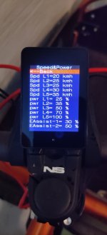

Posting this because there are possibly other people out there like me, searching for the manual for this display.
Bought a couple of DM02s from the factory. Arrived last week and I've installed one. Early days but they seem amazing!
However they arrived with no documentation and I struggled to find any on the web.
Kat, their comms mgr has been super helpful, and kindly sent me PDFs of how to programme the display.
This is for the current/latest version.
You'll see the display & motor settings are super customisable. Haven't really scratched the surface yet.
Happy reading

Downloaded this operation manual and it doesn't work. display comes on without a password and none of the buttons work as described. How do you operate this motor?
Hi, I may be able to help. It can get a bit complicated in written. Speaking it would probably be very simple.
So you switch on the display. Actually you should be ready to go. If you push the up arrow you should see that the 1 goes up to 5. These are the default support levels.
Obviously you will need a bit more than just that. For instance enter the correct tire size.
What you need to do is very easy once well understood. (Took me a while, believe it or not):
You switch off the display and then you switch it on again. While the display starts going on , you push simultaneously the power and the up buttons.
This should bring you to the main menu. PW should be 1234, and there is an option to cancel the PW request.
Let me know if that worked so far for you.
One more thing: it is important that the speed sensor and magnet are aligned in a functional manner. If not, the motor will shut off.
