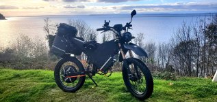

I found that, if not grinding the sides off of the bomber frame (after Gen2, I recommend NOT grinding sides off - it hurts stability), I could fit a maximum of 360 cells in the frame if going with 20s. Which is 18p.
Many months of slow work and eventually I built it. 3 sub-packs wired in series with external BMS on top. Everything fit exactly as planned, and was definitely a hard cram.
I then used the cargo packs exactly as planned, in panniers. Altogether, the bike is 20s28p, 7kWh.
It can push a maximum peak of 364A (almost 28kW with voltage sag)

Some other eventual upgrades were:
-Kickstand: Directly tapped into the swing-arm, closer to the pivot point

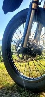

-Dual front-brake callipers (I hand-crafted the second adapter mount for the DNM forks from aluminium),
-Reinforced steel plate on the swing arm for the shock's force (custom welded)
-New pannier bags (2x batteries fit in one bag, my large 3kW charger fits in the other bag)
-Reinforced steel cargo bag brackets, custom made
-Heated grips via 12v splice (Needed for Washington winters)
-Reverse switch wired to "engine start" button (hold the button and throttle, wheel goes backward)
-Better handlebars (slightly raised, more like dirtbike)

-I installed a stiffer coil into the DNM front forks which was a major improvement for front suspension
-I replaced the damping oil in the front forks (small improvement, hard to tell against the new coil)

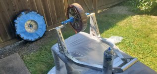

I recently re-built+trued my rear hub motor wheel into a new rim, since the old rim had a small bend in the wall, to make it roll smoother (it was fairly vibratey at around 100kph)
After getting the wheel back in, the hall sensors were dead. I opened up the motor and found cracked phase wires on my 2T stator.
I replaced the sensors and tried to patch up any cracks but they died after a couple rides again - I think the wires are cracked even inside the combo wire and are killing the sensors via the wires getting crossed. So my 2T is out of service for now... not sure if I want to put in the work to re-wire everything since I may be moving in some months. I believe the cracking is due to high heat, and QS Motors using cheap PVC insulated wires. Running silicone wires would fix this issue (and maybe slightly higher gauge)
For the time being, I am using my 2.5T, which reduces my top speed from around 135kph down to 120kph. I went ahead and varnish coated the 2.5T before putting it in so it's also waterproofed.
