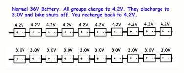

What is an unbalanced battery? You may know that a 36V ebike batteru consists of ten series cell groups. Each group operates between 4.2V and 3.0V. In a healthy battey, the group voltages charge and discharge tiogether,
If one or more cell groups happen to lose capcity or develop a fault like high discharge, they can drop to something like this, THe battery will read 36V at the outside, but one cell friuo is close to being shut off by the BMS. Unless the BMS has balance capability, it can't be equalized. EVen if the BMS could equalize, it might take several days to a week to do so,
In my opinion, bad cell groups indicate the cells are near the end of life, or there is a quality issue. In either case, if the battery were repaired, it would happen again wioth another yroup,
