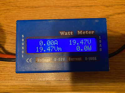

Thanks that was a good tip. I've played a bit with changing the blue and green wire. It changed direction. It also has a 'learning' wire. Finally when I unplugged that it actually is working with the phase wires in the normal order. Strange enough.
I fixed it to some wood and it's strong enough to pull me up a slight incline when I stand on it. Fast enough. Both batteries don't hold full charge and one is just weak. The power is promising though. I'm very curious how it will work with 2 good batteries.
If the motors can pull 100 kilo I would have to pull the rest of the weight myself.
The plan is to cut away part of the tires so the wheels will be a bit smaller and thus will hopefully have a bit more torque.
Some questions still,
Am I at risk of 'overpowering' the batteries with this controller? I'm afraid of fires, thermal runaway etc....
What happens when the throttle is released but I am pulling it by hand or it is still in motion or going downhill. Will it generate electricity? Where will that stay? Is this a safety risk?

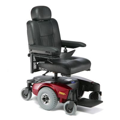

I'm with Chalo about using wheelchair motors. Plenty of torque & the right speed range. They can be be pushed manually if you release the (usually yellow) freewheel levers. These levers operate on electric brakes that lock the motor when power is released or lost.
Used, non working wheelchairs can be had for next to nothing & you get a matched 2 motor controller to boot! Usually the chairs don't work because they've been stored without charging & the batteries have starved. Easy check, a volt meter in the charge socket. Less than about 22v is dead & you've found a bargain.

Geared hubmotors may help do what you want, but if you want to try something different, you can poke around for scrapped powerchairs at local repair centers for them, or thriftstore finds, freecycle, craigslist, etc. Might even find them for super cheap, if not free.
If using the typical brushed Invacare-type powerchair motors with angled gearbox, where the wheels bolt to hubs on the gearbox output shaft, you can get versions that have a clutch lever on the gearbox that disconnects the output gear from the rest of the gearbox so it can be freely rolled...but otherwise it stays engaged, which will prevent rollback of your load on slopes, etc (very important for loads that you can't move up or down the incline without the motor help, in case any mechanical brake isn't working).
Many of these *also* have a parking brake lever on the unit that manually engages/disengages a friction braking plate inside (most of these also have an electric solenoid you can use to do this, too, but that can be physically removed if desired).

Those are great tips. The only thing is that it should be very compact. Tire diameter preferably under 7 inch. Will the speed not be to slow with such a wheelchair motor if I bolt it to a very small wheel?
I'm afraid the gear ratio is made for wheelchair wheels and those look to be a bit larger.
Motor RPM is proportional to battery voltage, so you have some control over what the top speed is. With brushed commutated motors, there are limits to the upper voltage they'll tolerate (due to arcing at the brushes), but you still have a range to allow you to match wheel diameter and intended speed by changing voltage.
The kind of power chair Amberwolf is talking about tends to have pretty small drive wheels. Not 7 inches, but small.
