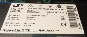

Got some flatpack2 he front end 48v/3000w revision 2.3.
I contacted eltek and they gave me the I2C protocol for these.
The can bus does not seem to work as the other eltek supplys.
I started trying to write the I2C comms, still working on it.
Attached is the paper they gave me.
  • I2C_Application_Guide - V2.6.pdf
Im able to read the serial number via i2c!
Now onto working on the settings.

Ok a little progress on i2c.😁
Default voltage and amps are settable, I set and tried 48v and 52.4v, 10-60a.😁
Over voltage prolly can be done too.
Looks like a high voltage shutdown restart is settable.
Can be done via a global i2c calls(all receive same message at once).Going to connect all 3 for a power bank and see how it works.
Reading psu is done by addressed calls.

Eltek Flatpack2 HE Rev 6.0 is working from 35V and above.
Charging my 21S Li-NMC battery.
First test with two Elteks in series
And my setup for 10kW charging power
