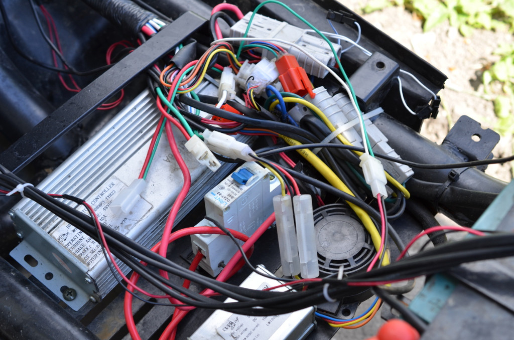

That's what the inside of a Motorino XPD looks like. There's surprisingly no photos of this online. If anyone has trouble taking one apart I'm happy to answer any questions.
So this is the stock rat's nest of wires. I mostly took this for reference in case I missed something, but it proved to be less than helpful. I didn't get any photos of the "After", but I was able to clean up the wiring a bit with a liberal application of zip ties.
The unplugged connectors are for the charging port, the alarm, and a random spare 12v line for no reason.

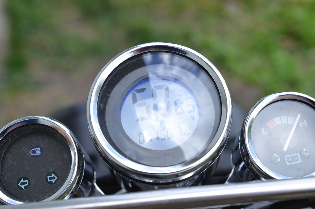

I wired everything up temporarily, flicked the switch, and turned it on.
Woo! It worked!
It's hard to see from the glare, but it's spinning the tire at 58km/hr up on the kickstand, and the voltage is reading as 65v!
It really was exhilarating that nothing seemed to explode, everything seemed to work at this point. But, unfortunately, several 12v devices were killed in the process.
